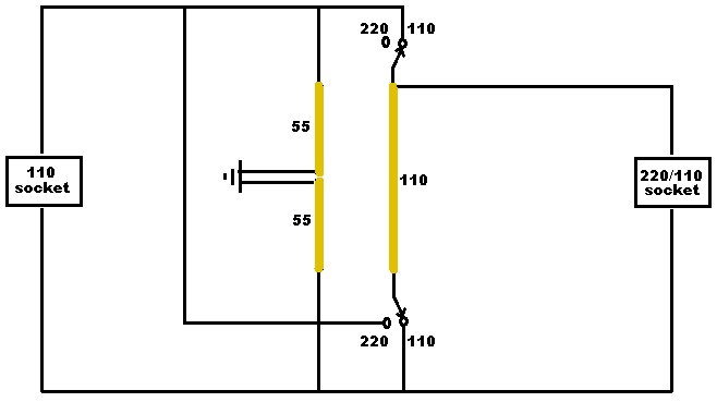

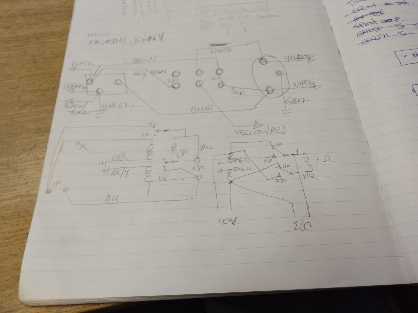

I assumed so, however if you can read my scribble (I had 3 goes at it by the look of this) there were actually 3 windings (assuming my resistance checks were correct) of 60,60,120V:
This had a shuko socket for 240V and flat pin socket like USA for 120V, however when in 120V mode the shuko was also 120V. The switch was labled something like; '240/120V to max current of 240V' & 120V to max current of 120V'

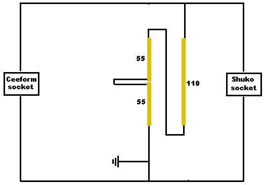

The final setup was simply wiring all 3 windings in series but earthing point to the Neutral pin and changing the USA socket for a blue Ceeform so there were dual outlets of 240V.
I suppose the most obvious thing to do is google for the jenny. This is basically the setup but different sockets:

The one we had, two windings one centre tapped. The centre tap went to earth so in 230 volt mode it was 55 - 0 - 175 and in 110 volt mode 55 - 0 - 55. In the 110 volt mode not a problem, but the 55 volt line 2 to earth was not really a good idea.

After modification:
