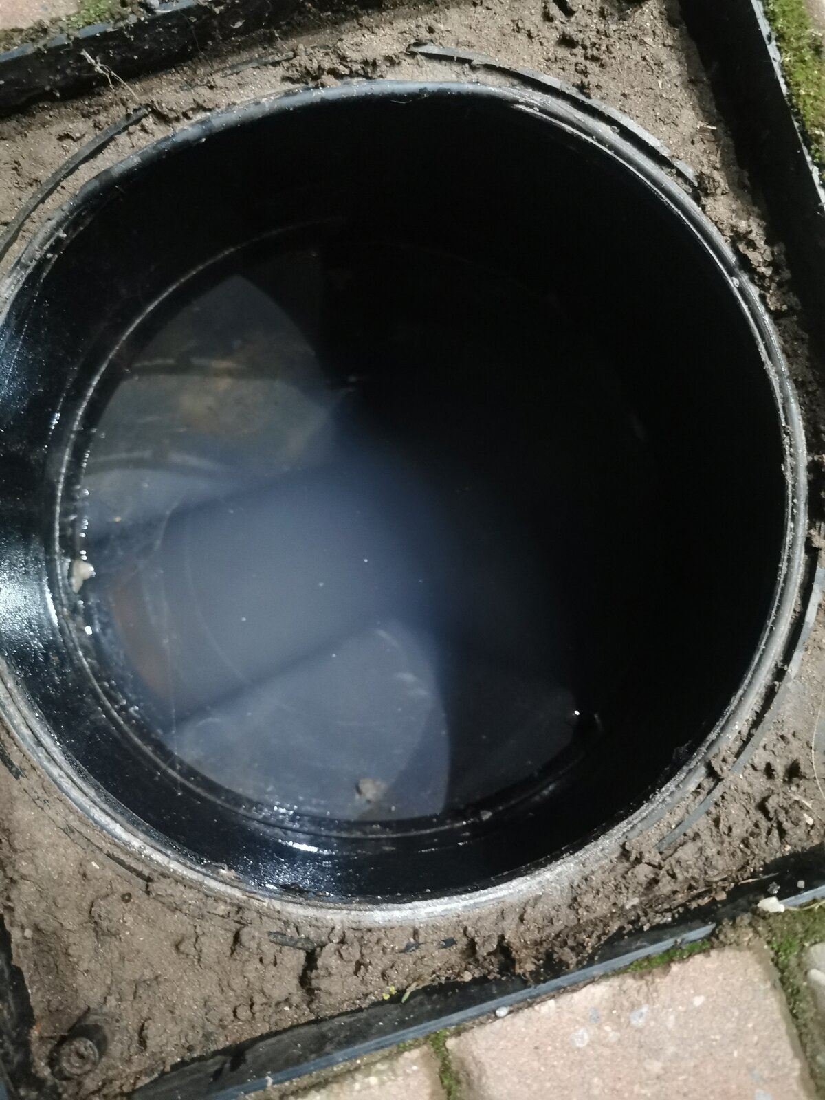

I've just had a look on my driveway as there's an inspection cover there and it's about a 1/4 full of water

Might be lucky here, if you can trace that drain off your boundary, it may be the Water Company's responsibility, if the sewers have been Adopted. Otherwise it could be worth speaking to the developer, but I wouldn't hold your breath.
How long have you been in the property, and are you the first Occupiers?

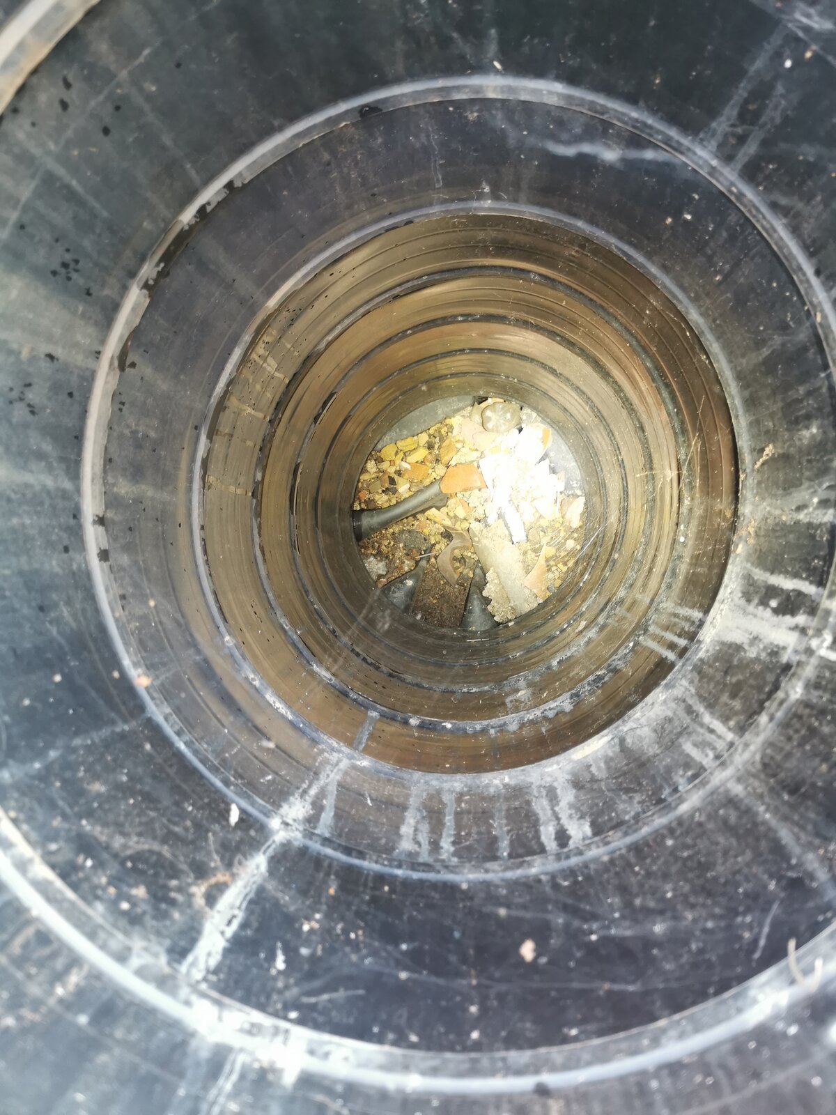

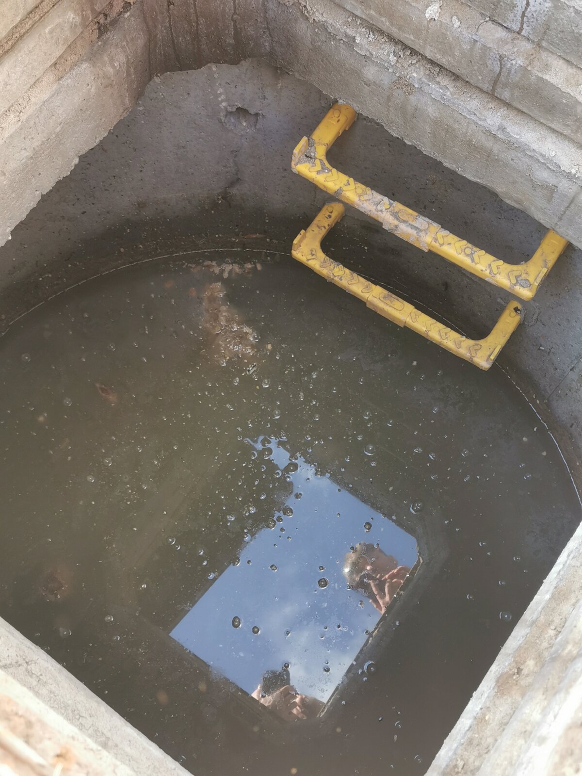

Opened next inspection chamber off my driveway and found full of rubble, brick and concrete. Went further up and when I released another inspection cover the smell was unreal and found it full of sewage/water....

Unfortunately then if the drains haven't been adopted it is probably going to be down to you to get them sorted. Look for someone who's prepared to quote a fixed price rather than a 'Half Hourly rate', which often means they'll drag the job out. Local firms, (with a local business address) will be better than the Franchises, and anyone with a load of AAAA's or 1's in front of their name.
What I would also do, is get the system CCTV'd once the block is cleared, and if there are any glaring issues, then you may have cause for redress from the Developer. It would also be worth speaking to the neighbours, if anyone else is affected, then it should fall back to the pre 2011 arrangements, whereby all using the sewer would be liable for sharing the cost of any maintenance, up to the point it became a Public sewer.
Not sure the developers can have much argument about the drain full of builders waste
If that is/was the case I'd have expected the issue to manifest before now, depending on how much use the section in question has had. CCTV will show more.
