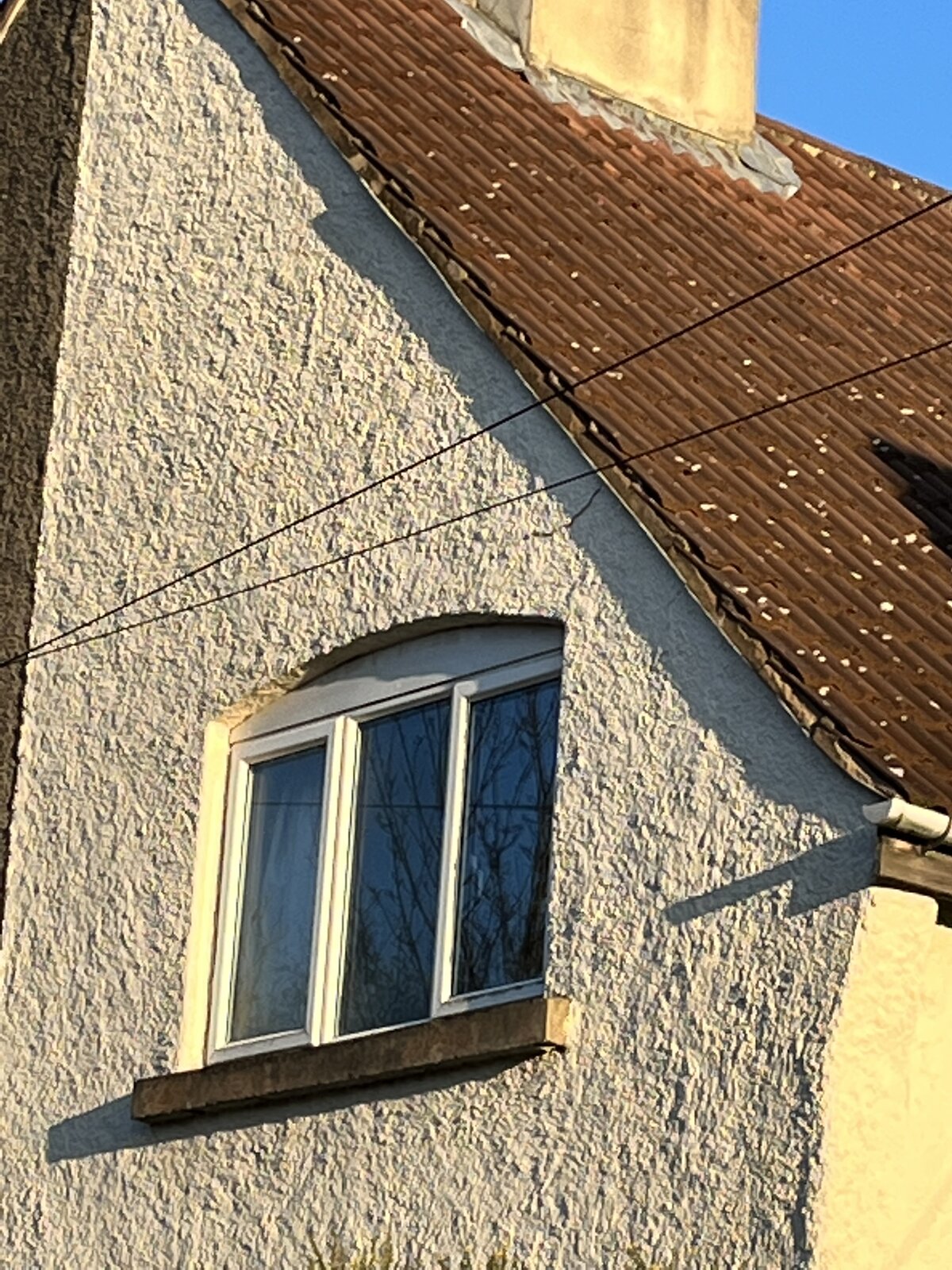

Hi all,
i'm slightly concerned by these cracks, they're roughly the same position inside and out which is concerning, but they do not look new. Also, the external picture has a fainter crack, from the downstairs window to the middle of the upstairs window, looks like this one is just the render though?
Has anyone got any experience with this type of thing, not sure where to start?

The arch has cracked probably due to closeness to the verge and common movement, or maybe helped by water getting in to the wall from the defective verge and causing some shrinkage. Rectify the verge and fill the crack in the render before plaster repairs.

The cracks should be filled with a cement grout or mastic, and then just monitor to make sure that they are not widening over time - seasons or years even. They may well be just common movement from age and some seasonal shrinkage at some time.
Pay special attention to any crack in the bedroom cill.

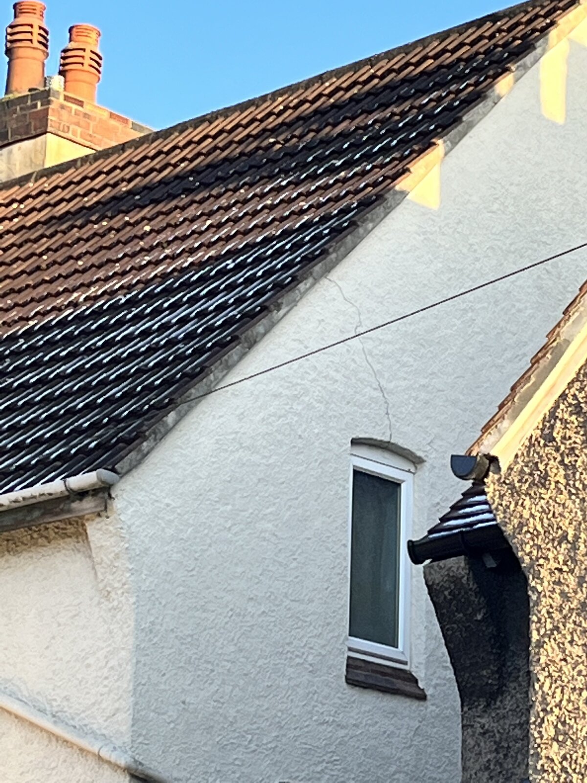

Resurrecting this one after I spotted this in the property attached to mine and overheard they were having a ‘survey’

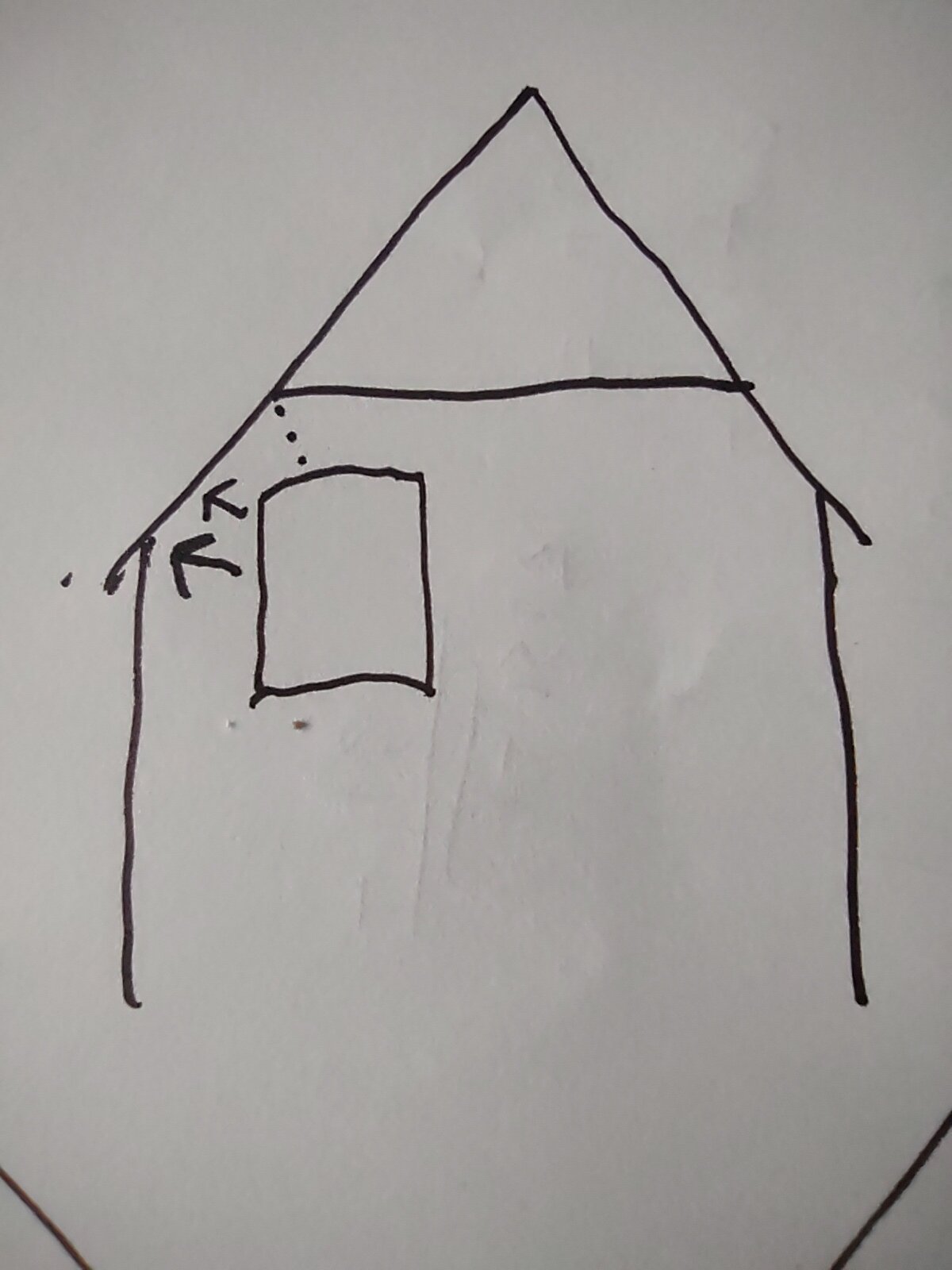

So in the above the crack from the middle of the window to the edge of the roof tiles.
To me it doesn’t look like ground movement but I’m a layperson and rely on what I google - any ideas as to why this one is cracking here?
They also have the same crack I do, on the front window, running diagonal to the roof tiles -
I would say that the roofs have settled and spread a bit, due to age and possibly contributed to by those heavy concrete tiles replacing the original covering. Normally it pushes the front and rear walls over (I'm sure you've noticed many terraced house walls leaning and in extreme cases being rebuilt due to this). In your case, it looks like you have a raised tie roof (the ties are the ceiling joists and will be restraining the gable wall above the windows with the lower section free to move).
Personally, as previously advised, I would continue to monitor it - it could be incredibly slow moving (decades) or even have stopped. If it is actively moving then likely remedial repair will involve some kind of strapping to tie it all together.
