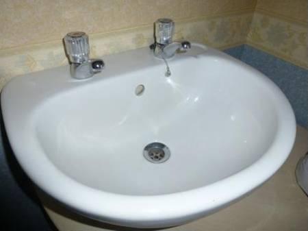

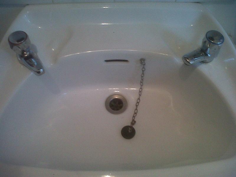

My bathroom sink has 2 taps such as the one shown below:

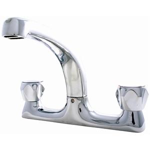

I would like to upgrade the taps to a twin deck mixer tap such as:
The problem I have is that the distance between both holes on the bathroom sink is 200mm, but the distance between the tap connection centres for all the twin deck mixer taps I found is 180mm.
I am aware that twin deck mixer taps are mainly used for kitchen sinks (hence it might not look great on a bathroom sink), but I would still like to know if this is possible to convert 2 single taps on a bathroom sink to a twin deck mixer tap.
Anyone had any experience of doing so?
Do single mixer taps exist with tap connection centres 200mm wide apart?

TAP CONNECTION CENTRES 180mm
No, I don't think there is mixer tap for 200mm wide holes.
How about a single hole basin mixer tap and blank off other hole? Might look offset.
Dan.

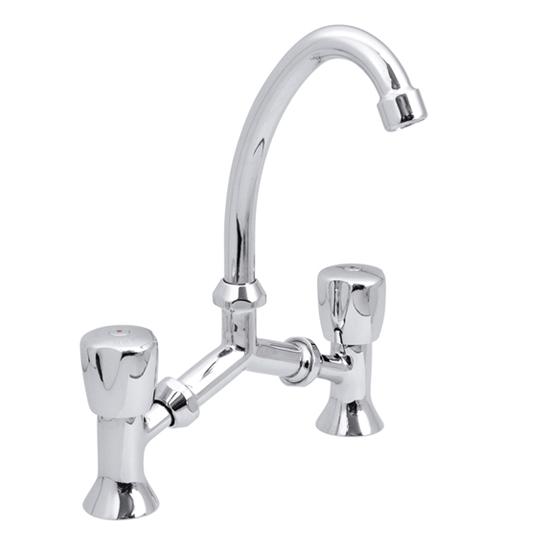

about a year ago i spent hours googling (and checking catalogues, and talking to plumbers) when i wanted to do the same as you but with a bridge rather than a deck mixer. in fact, at the time the only mixer I could find with anything like the right style was a bath filler, as these do seem to have 200mm centers. So that's what I ended up fitting. not ideal, but given the size of the basin, not too bad either. and having a mixer was important
i think yesterday i ended up typing something like "bathroom tap bridge mixer" and there it was, about 5 from the top.
The real killer thing for me is, the product I found yesterday was actually the one I should have bought a year ago, but couldn't find. I just keep having to tell myself that at the time they didn't make it :rolleyes:
i'm no expert, but it seems unlikely that one would be available to stretch that far. as well as looking a bit strange, it would also block access to the bits that hold the soap. if i was you i would be exploring the possibility of putting a monobloc mixer on one side and blocking up the other hole. what would be wrong with that?

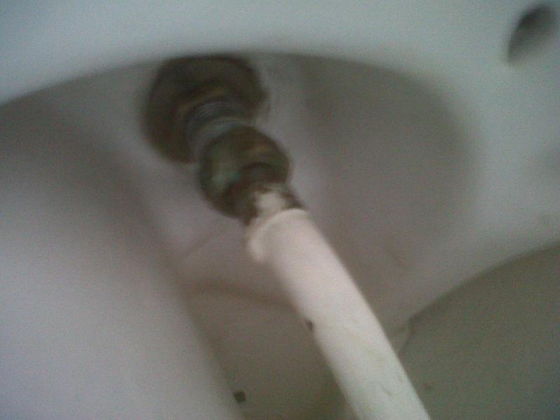

be warned though: I have never fitted a mono mixer to a basin so it's quite possible there is some pitfall I haven't noticed! I am especially uncertain as to whether a mixer would fit through the hole, but the holes and mixers might be a standard size for all I know. plenty of more knowledgeable people on this forum should be able to advise on any of these steps. some of the advice might be available on here already in other threads.
I'm fairly sure you need a bigger tap hole for a mixer than for a 1/2" tap.

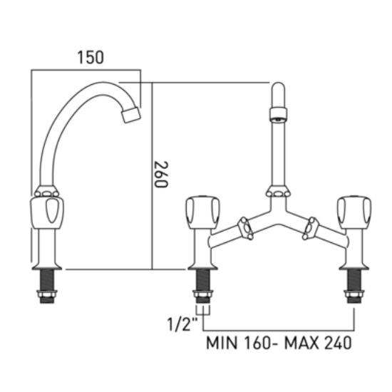

I need a basin bridge mixer for bathroom which is 180mm between taps, like http://www.wdbathrooms.co.uk/chrome-beaumont-bridge-basin-mixer.html
Ironically I have only found 200mm basin ones, and 180mm for baths. The bath ones are too big.
I've been Googling for hours on this, does anyone know of an online store which sells them. Have asked Plumbers etc as well.
