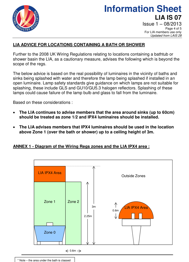

The LIA created a document for their members (mostly lighting manufacturers) suggesting that certain types of lighting should be IPX4 when installed in certain places in bathrooms.
It was created after the 2008 changes to BS7671, the most relevant of which removed Zone 3 and therefore meant items previously stated as being suitable 'outside the zones' could now be installed closer to the bath.
This document clearly stated it was a 'cautionary measure ... beyond the scope of the regs' mainly related to the risk of incandescent lamps exploding when water was splashed on them.

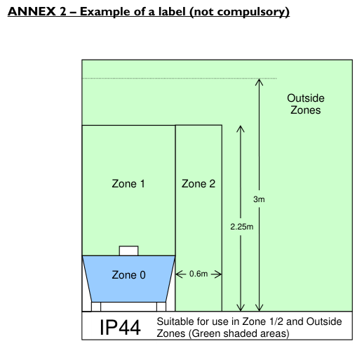

The intent being that manufacturers would make lighting that was at least IPX4 when it was being sold as suitable for bathrooms, and that instructions for lighting would state that lighting installed in bathrooms should be at least IPX4.
There was no suggestion that this diagram should be included in the instructions or published anywhere else. However someone(s) (probably from a lighting manufacturer) decided that this diagram was actually the BS7671 version and made other diagrams similar to it claiming it was 'the regs' and then hoards of people decided to copy and paste it everywhere including making their own modifications without checking what it was or even if the content was correct. Now we have 1000s of versions all over the place, the vast majority of which are totally wrong.
The guidance not intended for publication oir including in any other documents / instructions:
What was supposed to be put into end user instructions for bathroom lighting:
