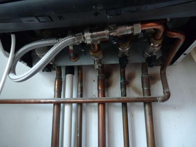

One thing is odd, you mentioned 4 pipes, I expect 5 on a combi.
Yes sorry it also has a gas pipe in the middle, and 4 water pipes, two to the left and two to the right :oops: The far right pipe (which the filter was in) is, according to the manual, "heating return", and the one to the left is the "cold water inlet". The filling hose connects the two.
The stopcock I mentioned is not part or the boiler, sometimes people put them in so they can isolate the boiler from the water mains.
Then I dont think I have one, just pipes going in from the mains and in/out to the radiators/taps. I dont see anything else connected anywhere along any of the pipe runs.

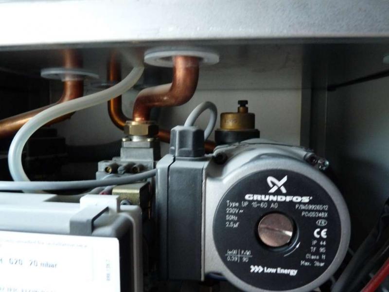

Just above and behind the pump is the auto air vent.
Is the air cap on the top just loose?
There is a screw sticking up which seems pretty loose - the cap that it is screwed in to didn't seem to move though.

I've attached a couple of pictures, one of the air valve and one of the pipes underneath. Let me know if you need pics of anything else.
I attached the air valve one because I want to check if the brass bit that the screw is in should move? Because all though as you can see the screw is loose, the brass bit doesn't move at all.
Nothing should visibly move.
The filling loop seems ok.
