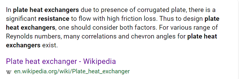

Resistance in plate heat exchanger surely will be same as resistance in resistive network in parallel connection
A resisistor of 10 ohmes with same parallel connected will have total resistance of 5 ohmes
More the parallel connections, less will be the effective resistance
The heating will modulate the gas rate as the temp rises , the hot water thermistor sends a value that the hot water is luke warm so the gas rate ramps up, if the pump is running slow it cant push enough water through the plate to clear the heat the main heat exchanger is making, a plate cant be compared to resisters in parallel as water does not act like electricity in this case.
