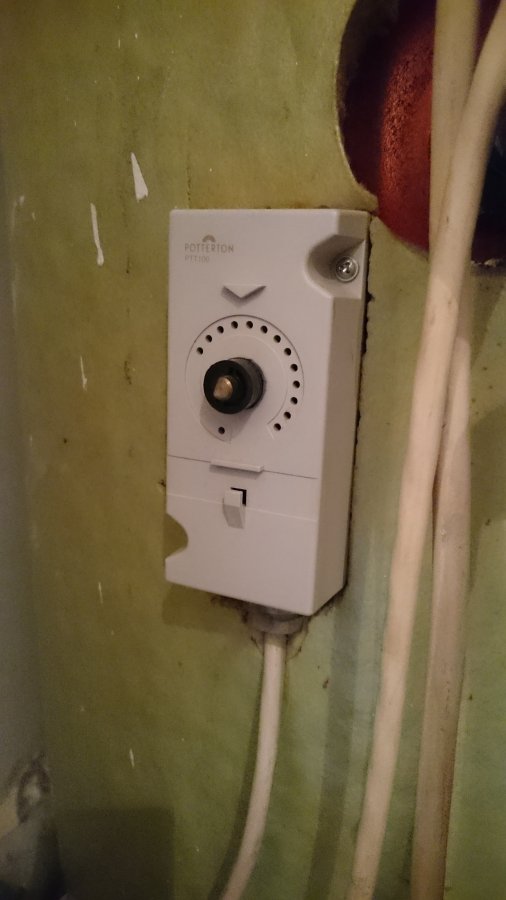

ok valves all open, heating switched off and big silver screw (sorry!) off. how do i test?
cant seem to find the thermostat for the tank, this might be it but it has no proper cover?
Have you tried to get the impeller to move now that the screw been removed. You can see by looking into this hole that you need to turn the head of the screw that's now visible
Yes that's the tank stat.

yep, it was popped out. The pilot light has come back on and seems to be starting up ok. Should i expect the pilot light to stay on?
Just run it and see what happens. Check you've got water in the small header tank in the loft.
If it pops again you could have circulation issues. Turn the boiler stat down to 3 or 4.
