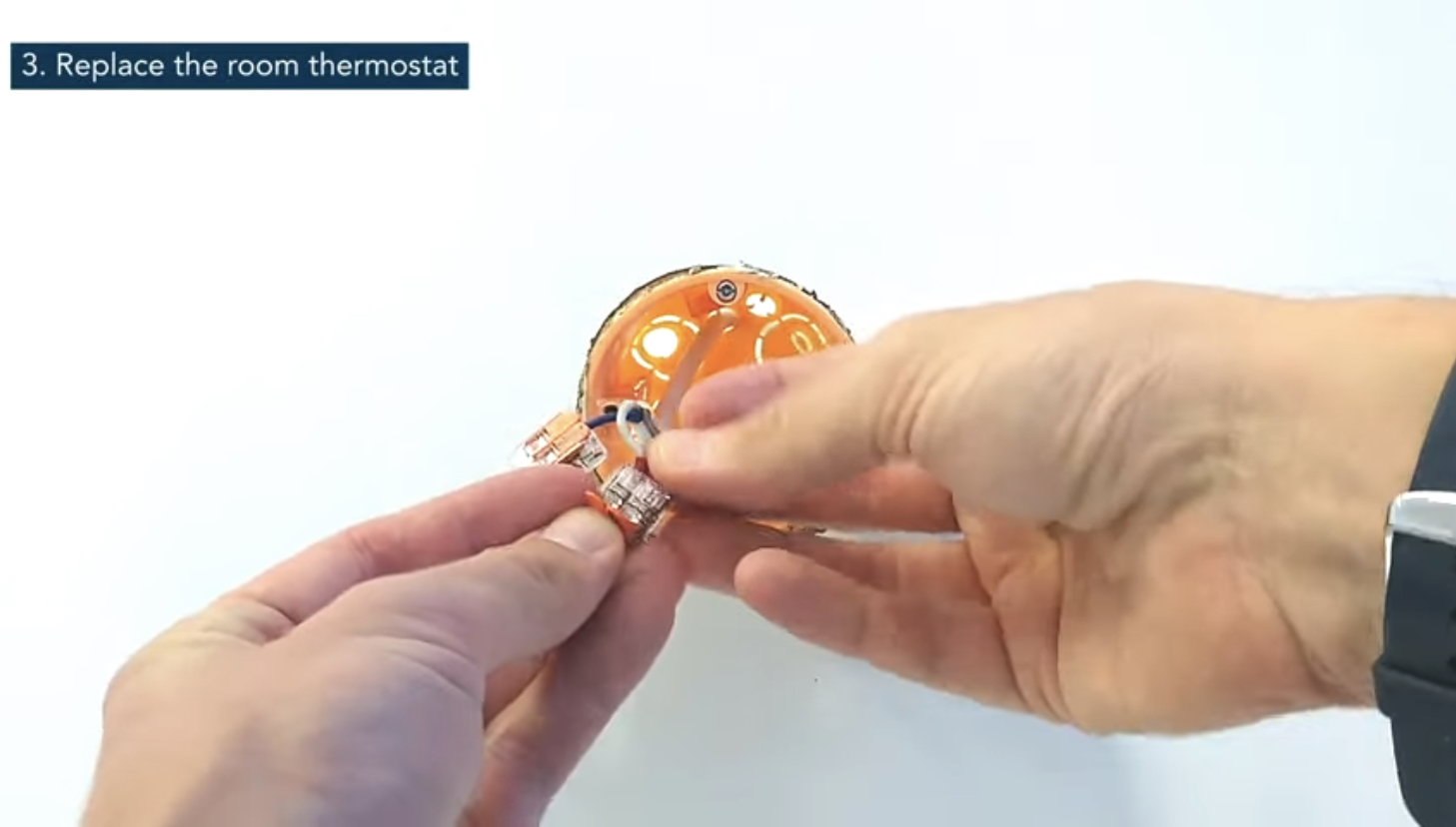

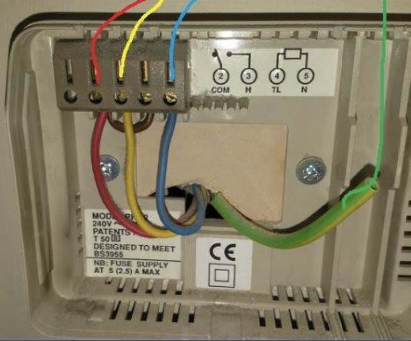

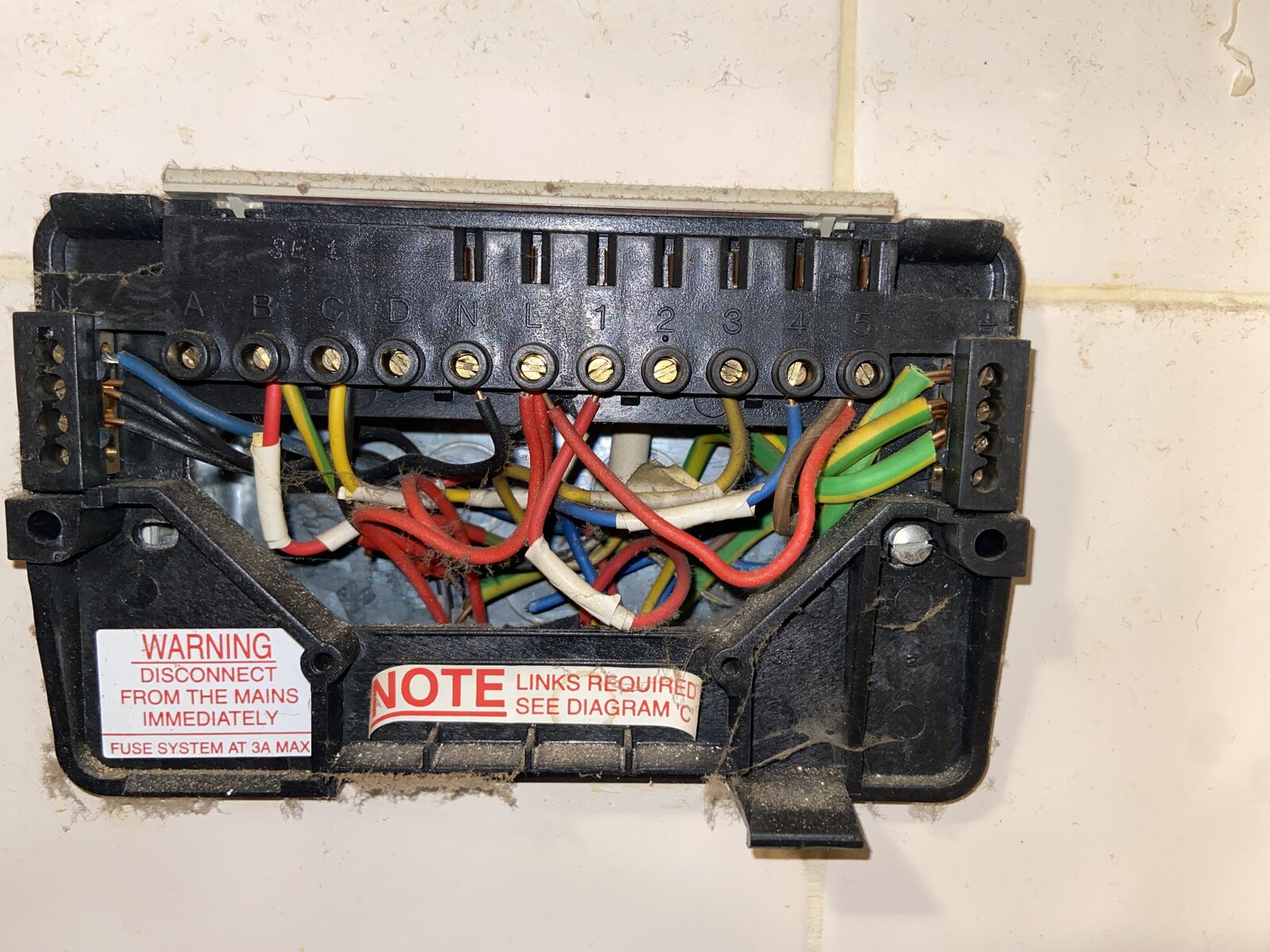

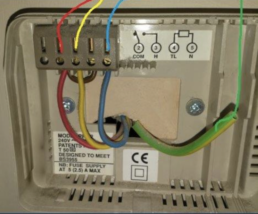

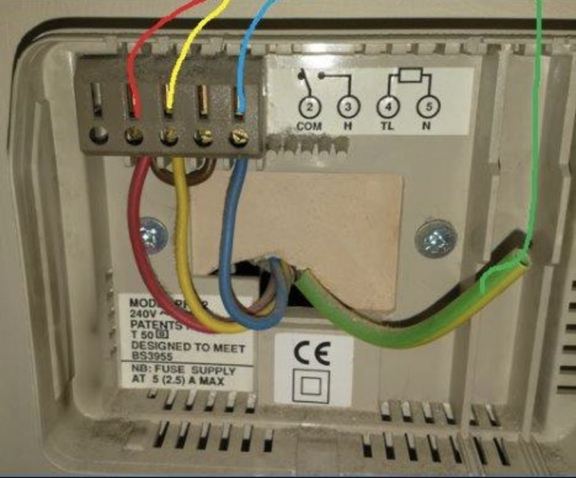

Despite of 100s of posts about Potterton wiring but here I am got a bit lost here about how to decommission PRT2 the way how Tado posted on their YouTube link.
Basically after I finished installing the receiver next to boiler went to old thermostat I set it to 30 to keep it always on meanwhile control actual temperature through new tado wireless stat.
Working fine but I want to ensure get it decommissioned just in case somebody touch it and ruin the circuit for me.
I am attaching the current wiring setup and picture how tado using compact splices to decommission similar stat

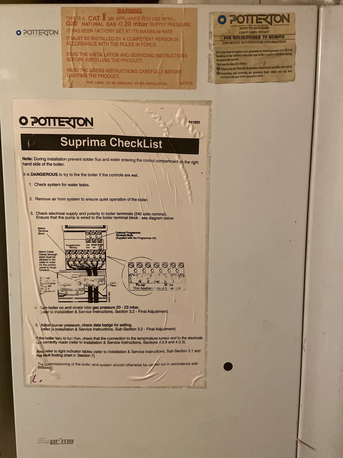

You need to join the switch wires, which appear to be 2 & 3 but there’s a small link wire, but just looks like a live. What boiler do you have?

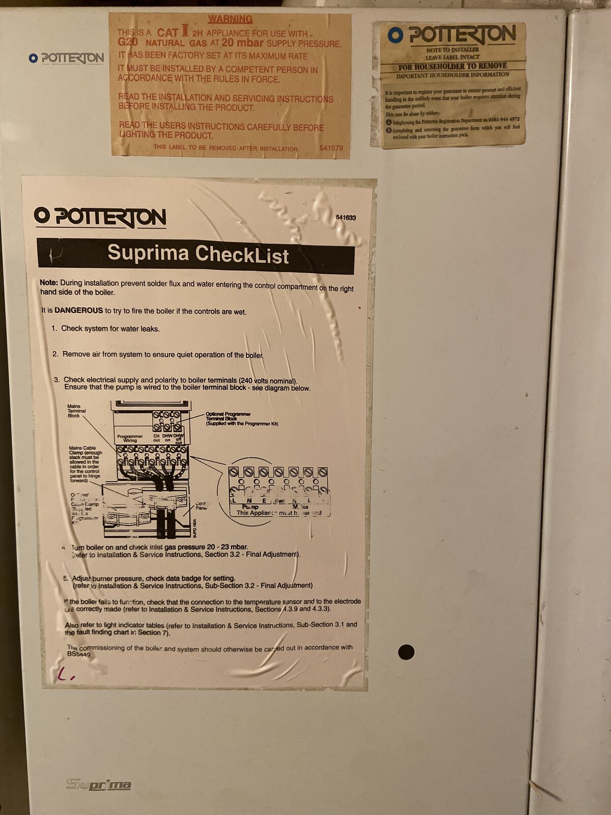

Hi,
Boiler Potterton Suprima 40

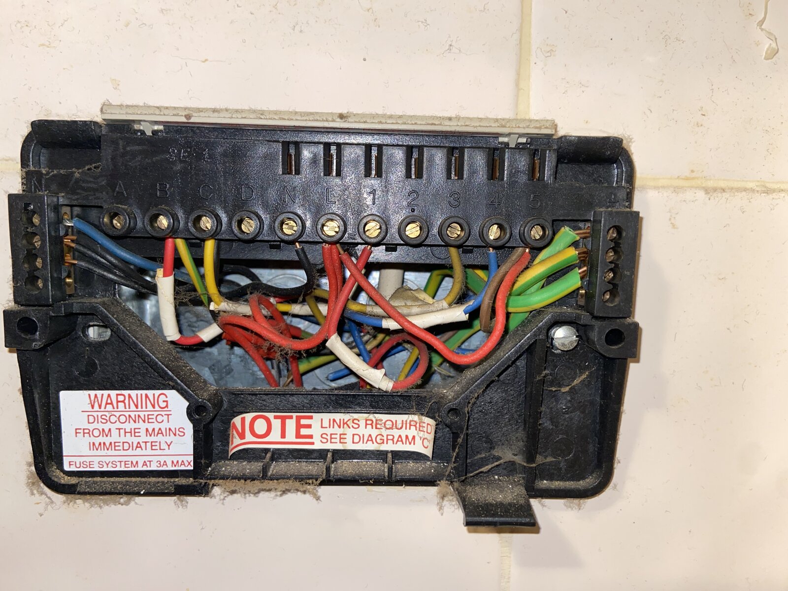

Ok, so you need to find the signal wires in the wiring center and join these, or follow post #2.

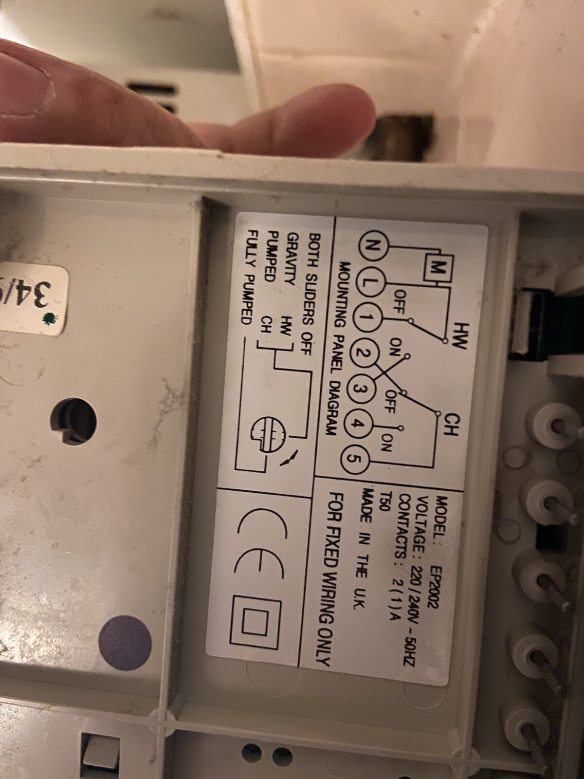

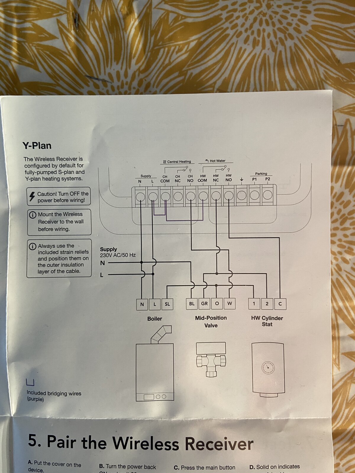

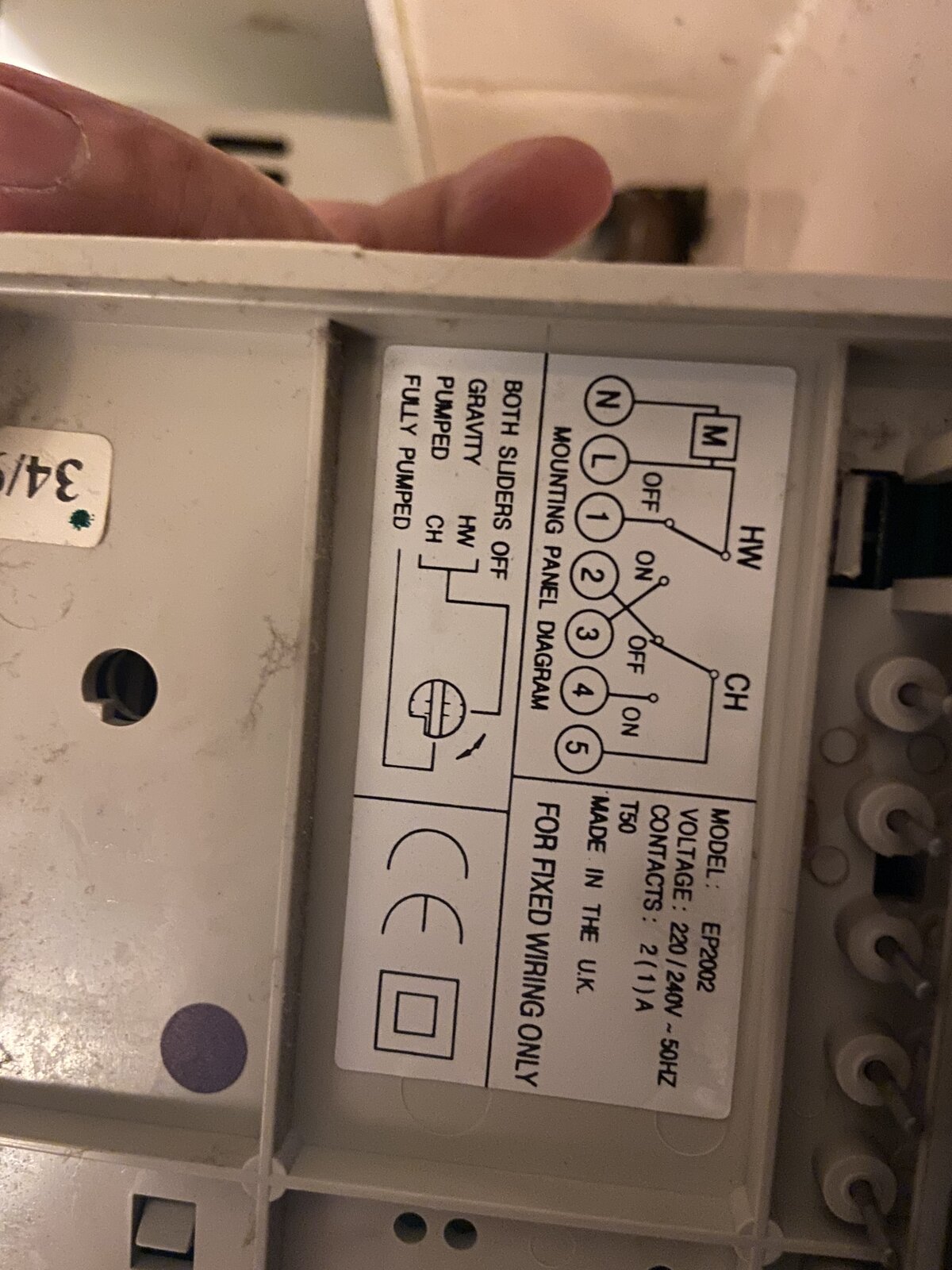

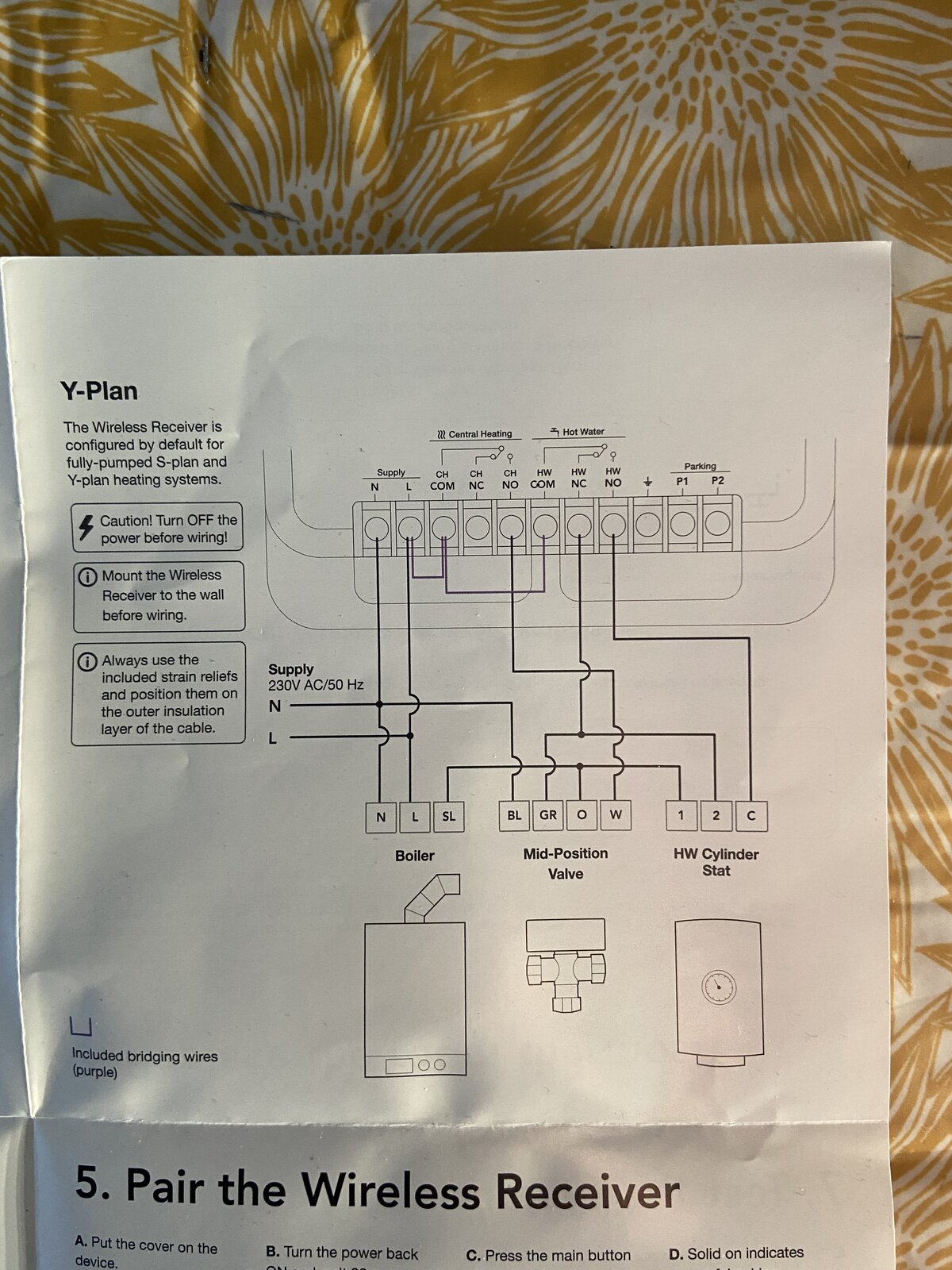

When I replace it potterton programmer with tado wireless receiver I followed tado Y plan as per picture attached. And I see from Potterton programmer CH NO is yellow.
Should I safely assume to connect yellow wire (3) with red wire (2) will make it permanently opened?

I don’t know which number 2 you refer to, but transfer wires in a similar fashion, L’s to L, N’s to N, Heating On to heating NO, hot water on to Hot Water NO, and hot water off to NC. The links are included, not sure what others are like C,
The number 2 and 3 I mentioned earlier was related to PRT2 thermostat
Do you believe if I connect 2 and 3 and leave 5 isolated would make the thermostat on permanently?

basically trying to copy tado installation instructions see video minute 1:24
@stem sorry to bring you here but seems you had the previous version installed of tado wired stat over PRT2
You may have idea on how I can make PRT2 on by connecting the wires
But there is doubt here about small link between 2 and 4. Should I ignore it?
Looks like the old stat was wired incorrectly, I think the red wire should have gone into terminal 4 with the live from 4 linked to com on 2. Still works just the wrong way around.

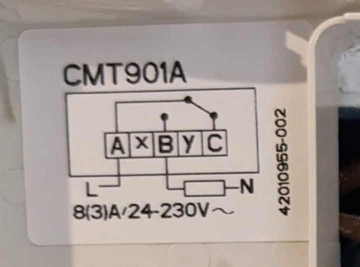

I believe that the Potterton PRT2 is a bit of an oddity when it comes to thermostats. The symbol I've marked below on most thermostats would correspond to a small accelerator, a device that is energised when the thermostat is calling for heat. It warms the thermostat mechanism and improves its operating accuracy. This is what I originally believed that it was.
However, I could never understand why one of the terminals was marked TL (Thermostat Live) if it was an 'accelerator' it should only be made live when the thermostat was calling for heat, and not connected to the live supply to the thermostat.
In addition, I also noticed that when removing PRT2's, the original installers who would have access to the installation instructions had all connected TL to the Thermostat Live as indeed yours was..... Which made me wonder....can they really all be wired up wrongly??
So, I now suspect that as the PRT2 has two lights on the front, one for 'Below' set temperature, and one for 'Reached' set temperature, that the TL connection maybe more to do with the operation of the indicator lights than the wiring for an 'accelerator'.
Either way, it's a quirk of the PRT2 which is being removed, and the remaining 3 wires have been identified for you.
I know you are well aware, but just my thoughts on generic rectangular symbols...
As with a recent post about the Honeywell com901 'stat -
If a C/H circuit diagram includes a generic rectangular symbol, I will always treat it as "Here be dragons"! ;)
It is still the symbol for a resistor, and as nearly every load will show a resistance, no matter what the contents of the rectangle - technically it's not wrong!
Indeed, that crossed my mind too, but I dismissed it because:
1) When the symbol is used to represent the heating load; a single N terminal / connection is shown as being external from the thermostat as per the example you posted.
(An exception may be where there are two Neutral wires shown at the thermostat, one from the supply, and one out to the heating load.)
2) The layout of the PRT2 diagram shows the symbol as being inside the thermostat terminals with the switching contact (i.e. above the terminals)...
....and not an external device connected to the opposite side (i.e. below the terminals) as per the Honeywell.
3) A heating load wouldn't be connected to the thermostat live (TL), if it was the heating would be permanently on.
