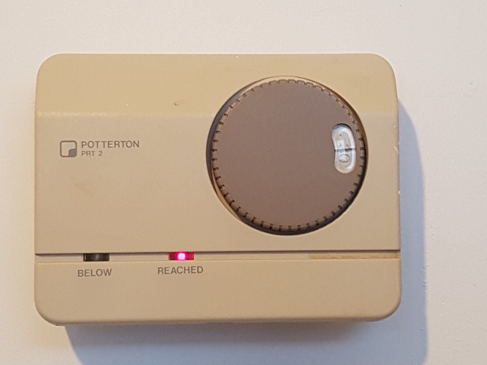

Hi, I have an old style back boiler and can't get my ch work. The dial on the thermostat is on maximum but heating comes on only when it's extremely cold. Hot water works ok. I'm thinking the thermostat could get dusty inside as we did some plastering but no changes after I cleaned it. I unscrewed the top bit of the thermostat but it's made of 2 parts and I couldn't separate them as I was afraid the break it. Perhaps the part that needed cleaning was inside? I heard these thermostats could have sticky valves, where are they exactly?

Do the lights still work on your PRT2 thermostat? They have the legends 'BELOW' and 'REACHED'. If they work and there's an audible click when turning it up and down then, despite the plastering, it is probably OK. 'BELOW' should be illuminated when the dial is turned high.

Anyway, here's the photo, I can also take the photo inside if needed?

Here's the photo

The below light gets illuminated/green when the heating comes on, it also clicks then.
The problem is that it only comes on when it's let's say 12-15 degrees in the hall while the room thermostat dial is set on maximum 30.

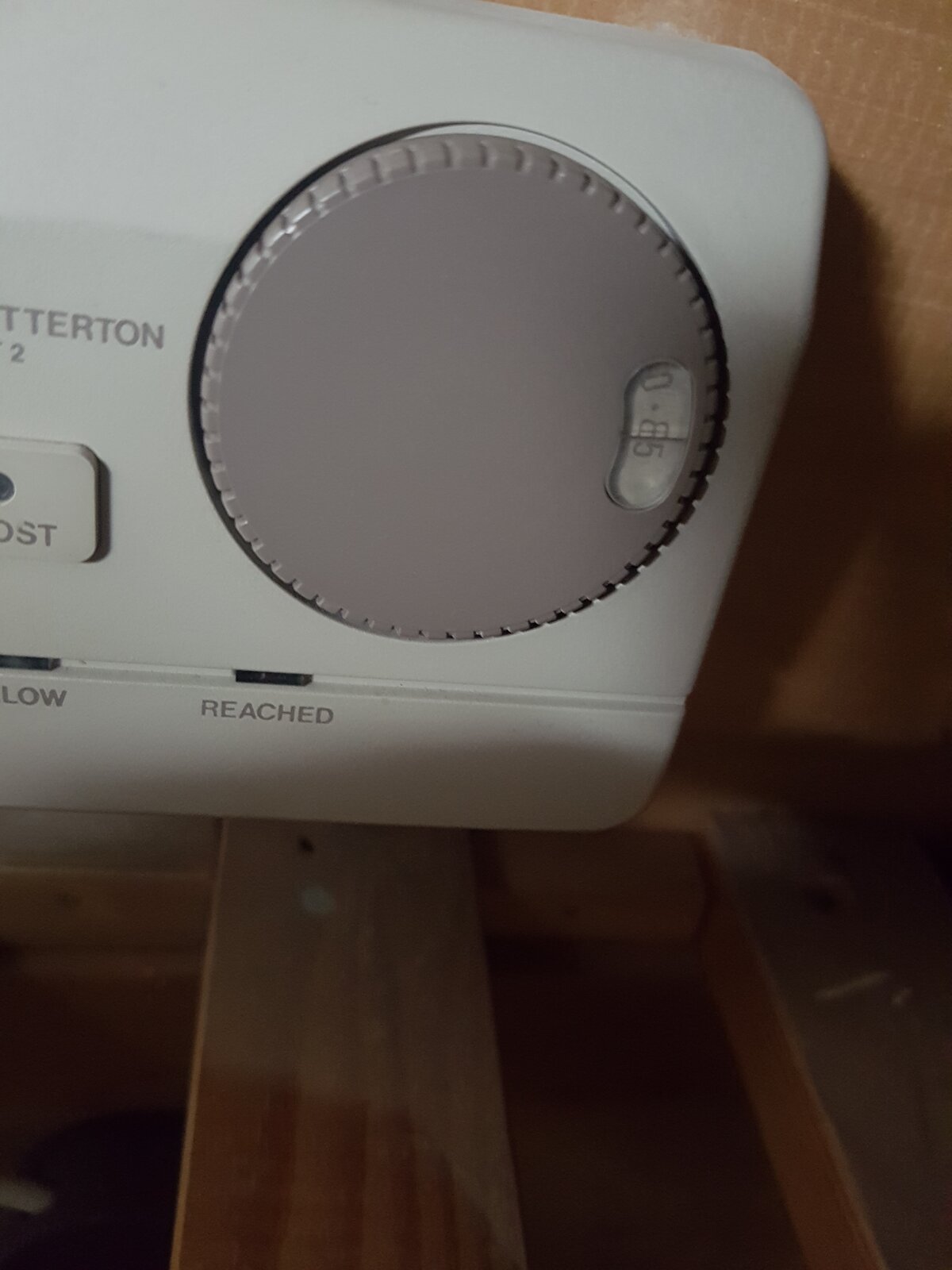

Will go and look for the dial where the boiler is.
Just checked the dial next to the boiler, it showed 75, I turned it up to 85. But I suspect it's the dial for hot water because the lights aren't on, and hot water heating us turned off at the moment.

That's unusual, it sounds like the room stat is out of adjustment. It is mechanical so there might be some kind of adjustment inside.
I don't know that model, but the easiest fix would be to fit a new one. There are a number at around £20 or less. Your current one has indicator lights which are quite handy. Yours may have two, three or more wires inside and you can get one with the same. Examples (sort it to "price low to high," though Drayton and Honeywell are quality brands)
