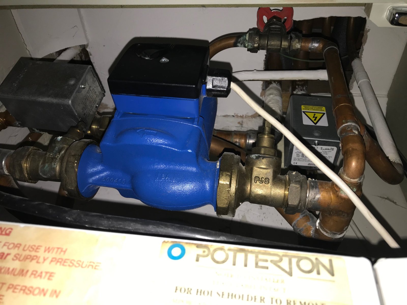

Incidentally above the pump in the pipework theres a wheeled valve that seems to ultimately like the flow and return loop - what exactly is this in a vented system ?
It's a by pass , don't touch it !!

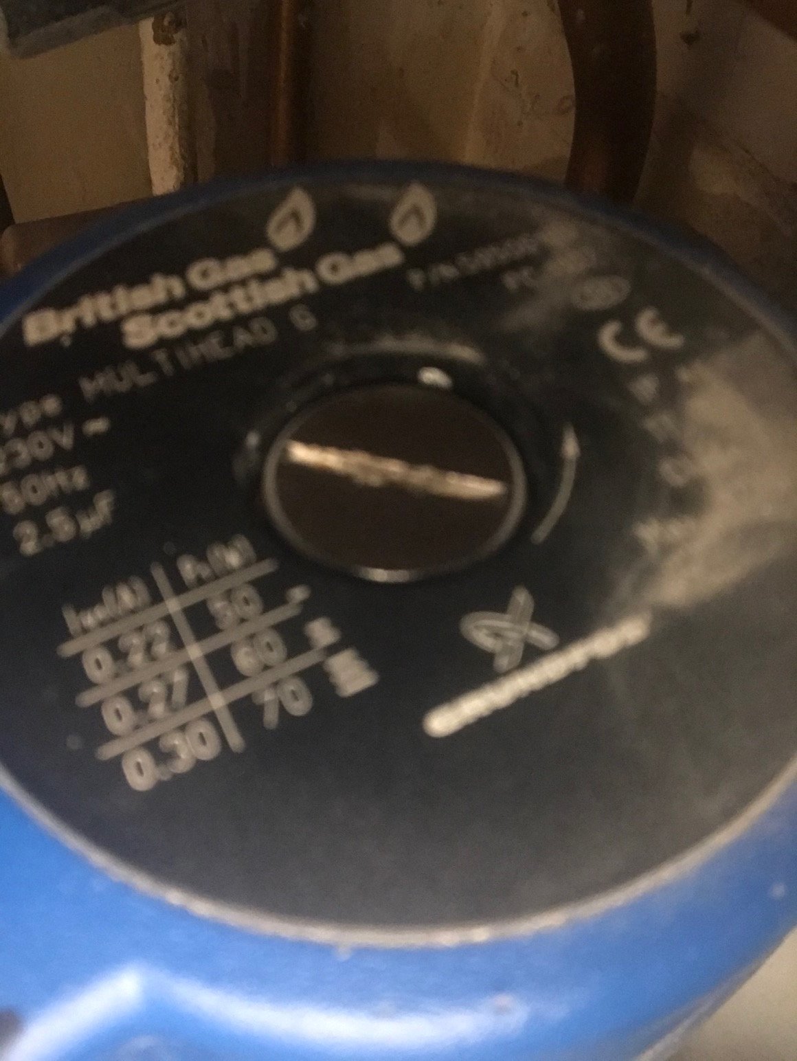

Not sure on bleeding that pump in particular ,but have a look at the back ( may need a mirror) for a silver disc with a slot ,in the centre of the housing.
Is your central heating working ,100% ? If it is the pump will not need bleeding .
ok - just as well as that red valve would only be reachable with someone with the arms of Mr Tickle! I can feel a slot on the top side of the pump so Ill try to get a pic and confirm with you if that looks like a bleed point

IMG_4638.jpg Got a pic of the pump with the slot as you mentioned. Good to know it exists.
So it's therefore the HW circuit thats the issue. If that bleed point on the flow/return (coil) circuit isn't expelling any air worth talking about would it therefore suggest theres possibly insufficient water in that actual primary pipework?
That is indeed where you bleed the pump ,and you only unscrew it a little ,till water comes out .

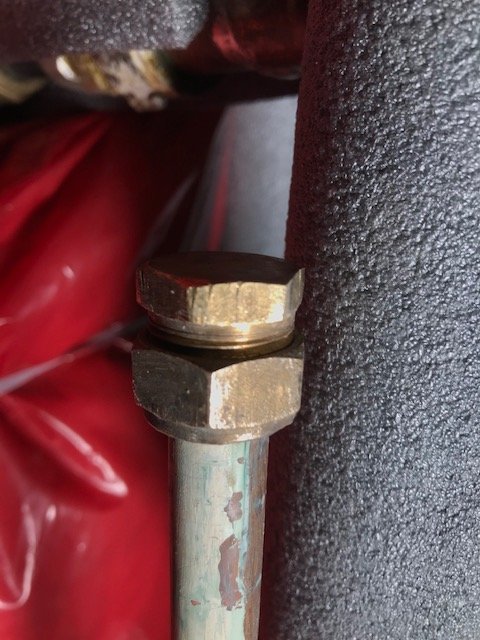

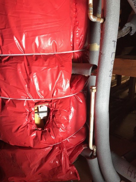

Can you show pics of cylinder / coil air bleed ? And when you bleed from it ,let it run water out for a good while.
I'll get a couple of pics now and Maybe you would suggest changing it for a more usable air bleed
I am not at all sure that the pipe is connected to the coil. The fitting is a compression stop end ,not an air bleed valve .

On the pipe marked flow ( on insulation) high up there appears to be a 15mm pipe branched from it ,where does it go, what's on the end of it ?
