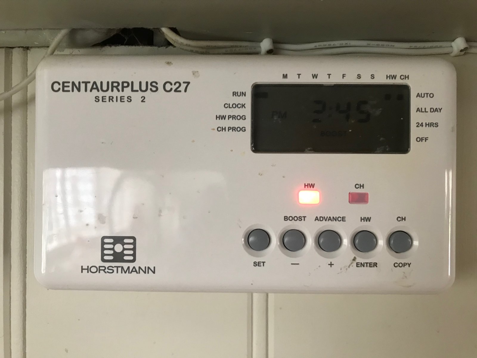

Basically , the programmer ,when DHW ( Domestic hot water) is selected ,energises the cylinder stat ,if that isn't satisfied ( water temp below it's setting) it energises the motor in the two port valve ,which opens and allows hot water to flow thru to the coil ,at the same time a micro switch in the valve is closed and energises the boiler ,which then fires up ,starts pump.

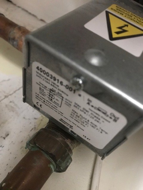

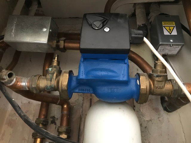

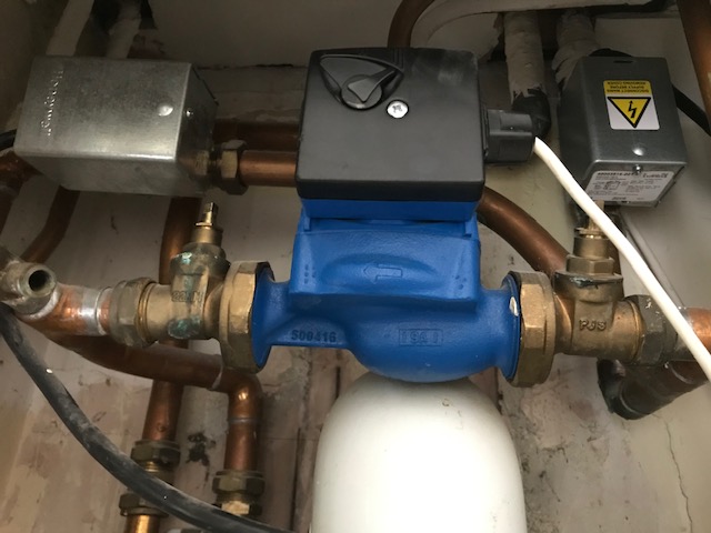

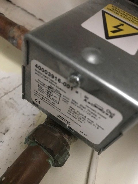

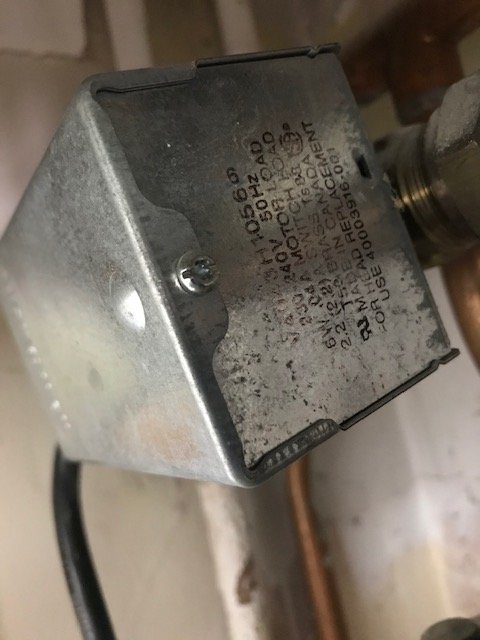

The two port valves are HoneyWell pics attached and yes the one on the left feels like two settings on the lever and the on the right it feels like three options - cant see the tops...

Programmer is a CentuarPlus C27 Pic attached

Bit of good news! I rocked the levers on both port valves rapidly and tapped both units several times and Hey Presto the green light comes on and she's fired up! Also no air lock is apparent seems to be running smoothly. Went to the cylinder and can hear the water boiling in the tank.
So one of the two port valves is a bit dodgy. Ill try to get a pic of the top of each one and confirm the position of the levers as I cant get in there to see. What are the setting options and what should each be set to - how do I identify which os for the HW and which is for the CH ?
Good. The valves lever should be in the auto position ,not manual. I assume the programmer is currently on for central heating ,if so, turn off the demand for central heating on the programmer ,whilst observing and listening at the motorised valves. You should be able to identify which one of the valves re acts as it closes. That's the one for central heating.
