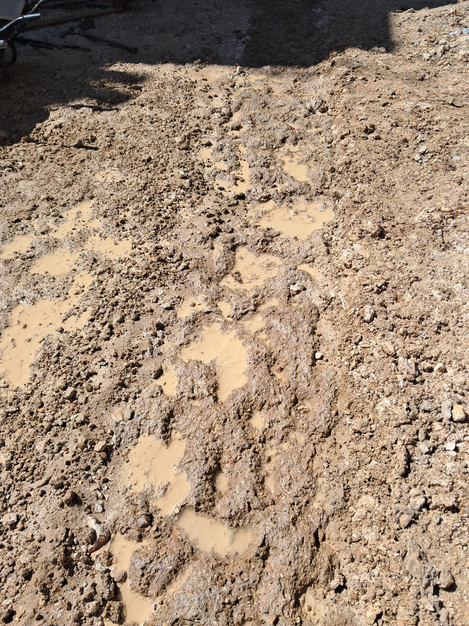

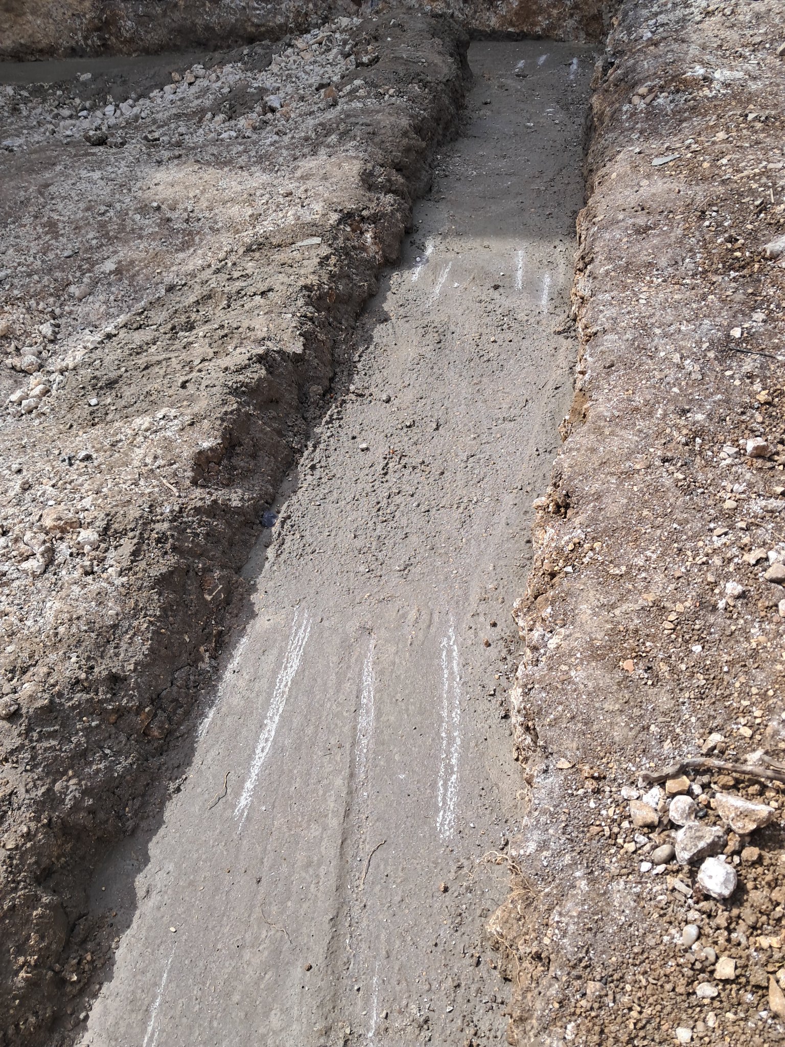

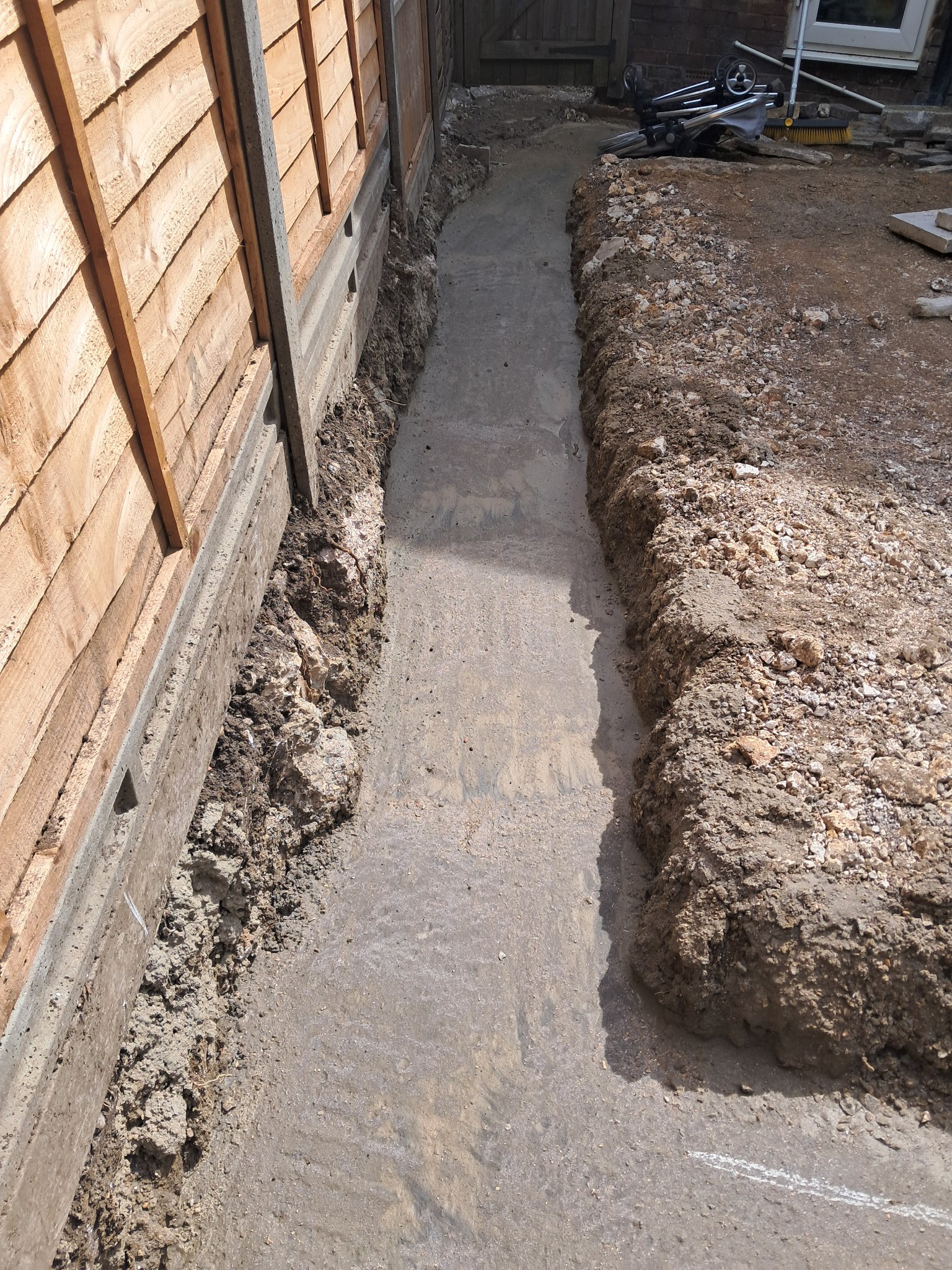

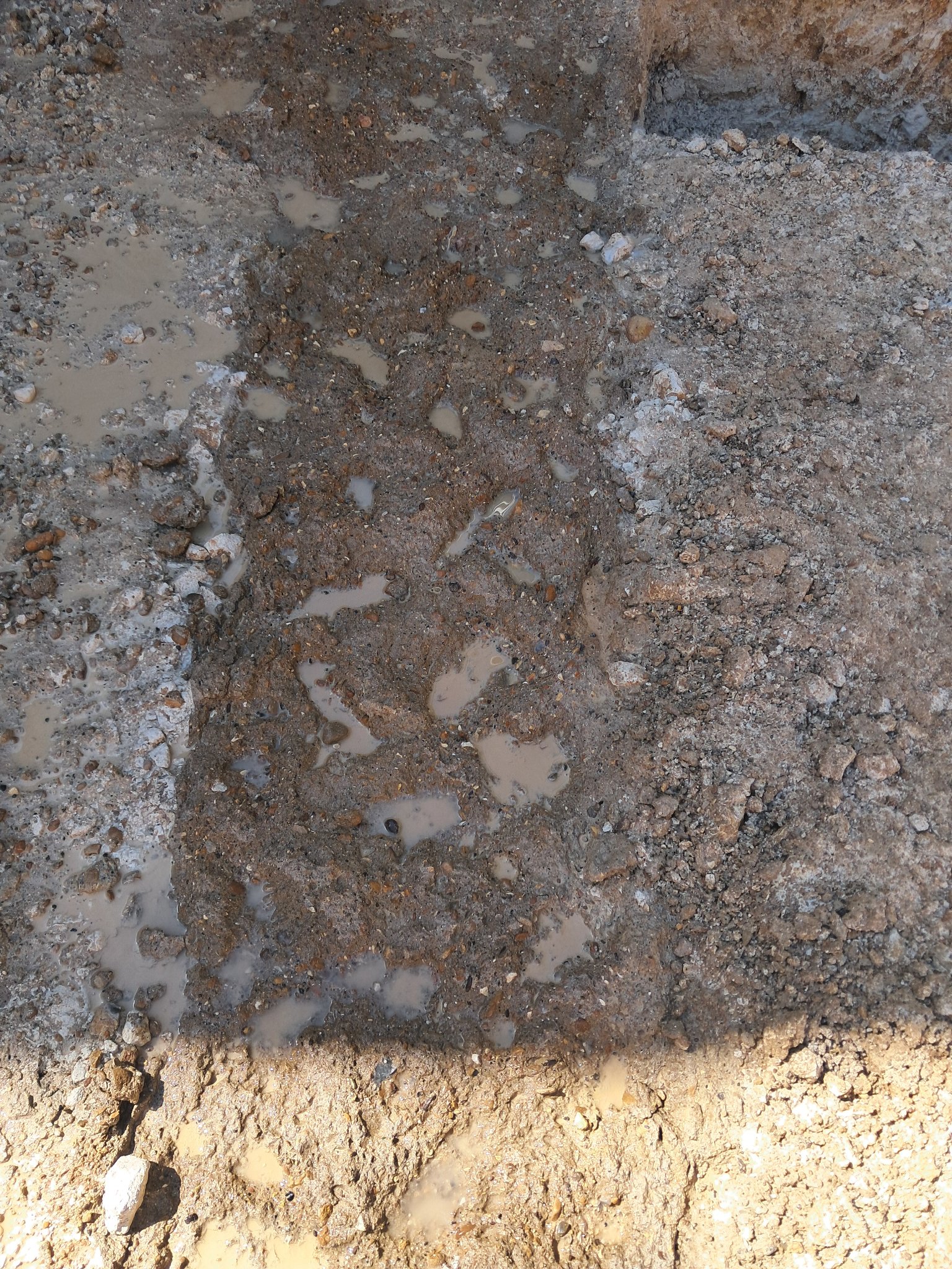

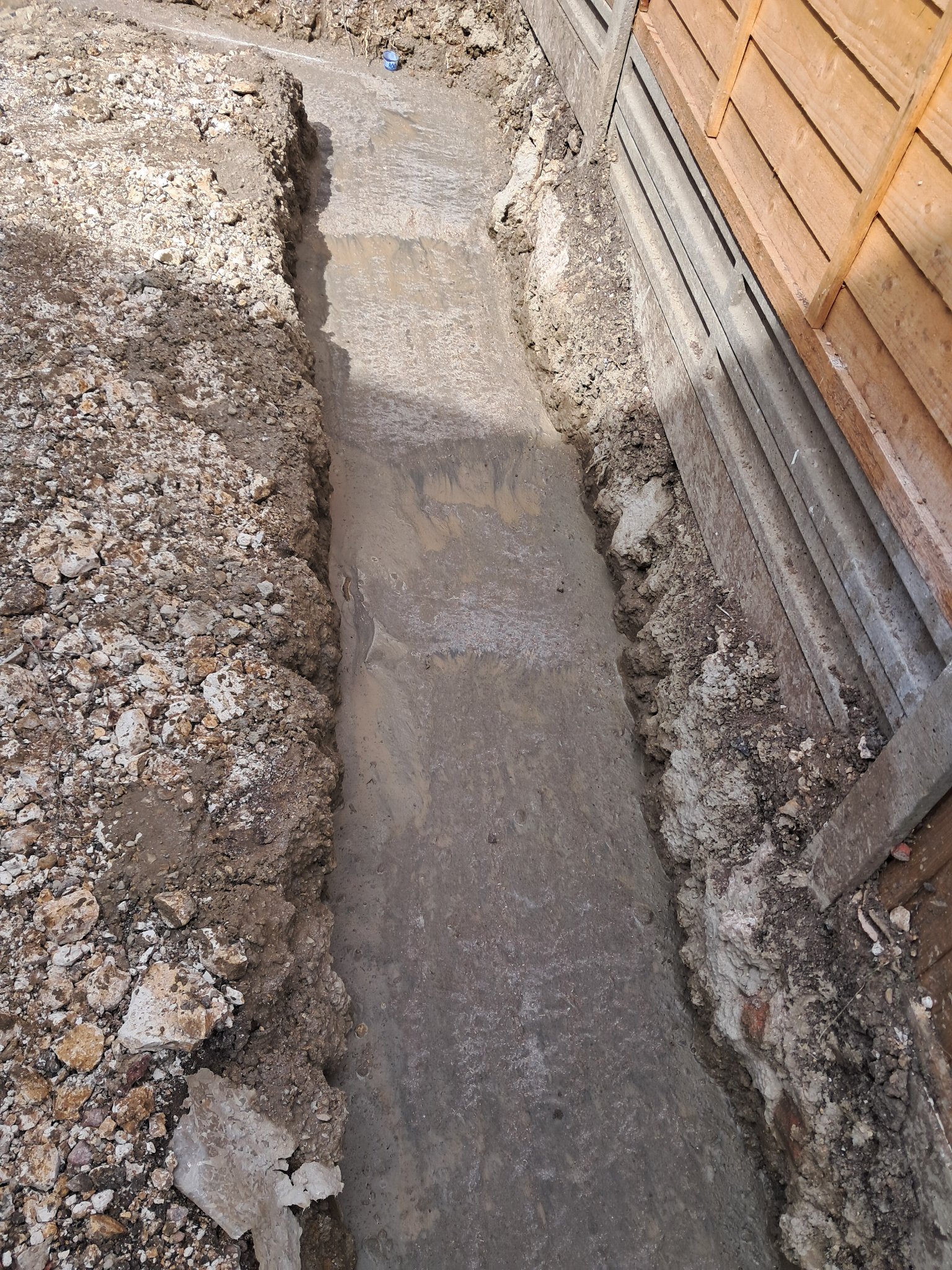

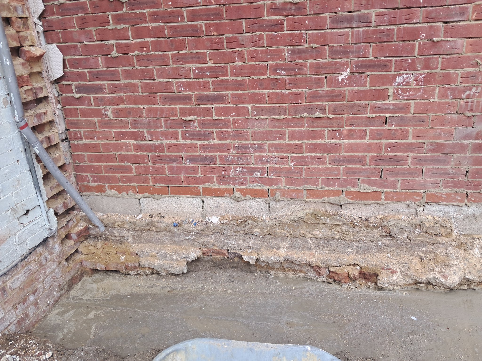

My builder poured too much concrete for the footings, and the surface ended up higher than the floor level of my existing house. Because of this, there wasn't enough room to lay even a single course of engineering bricks.
We started breaking out some of the concrete using a Titan breaker to lower the level, but this has left the surface uneven, with lumps, dents, and rough areas.
I'm no longer dealing with the builder, so I'm trying to work out the best way forward myself.
What's the best way to create a smooth, level surface suitable for laying the first course of engineering bricks? Would a levelling mortar bed be sufficient, or is there a better approach

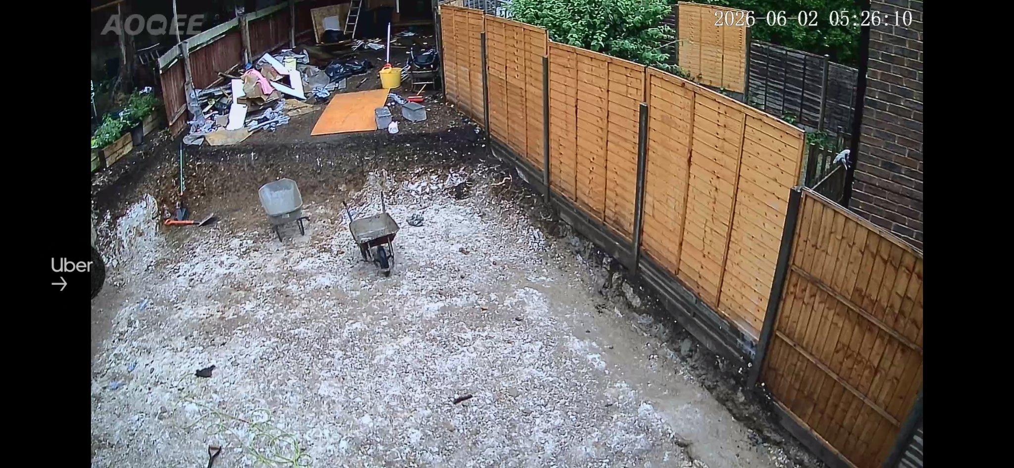

It has already lowered by approximately 15 cm. I will wash the footings to get clear pictures of the uneven surface.
It looks like it follows the slope of the ground, so is higher on the right of the door?

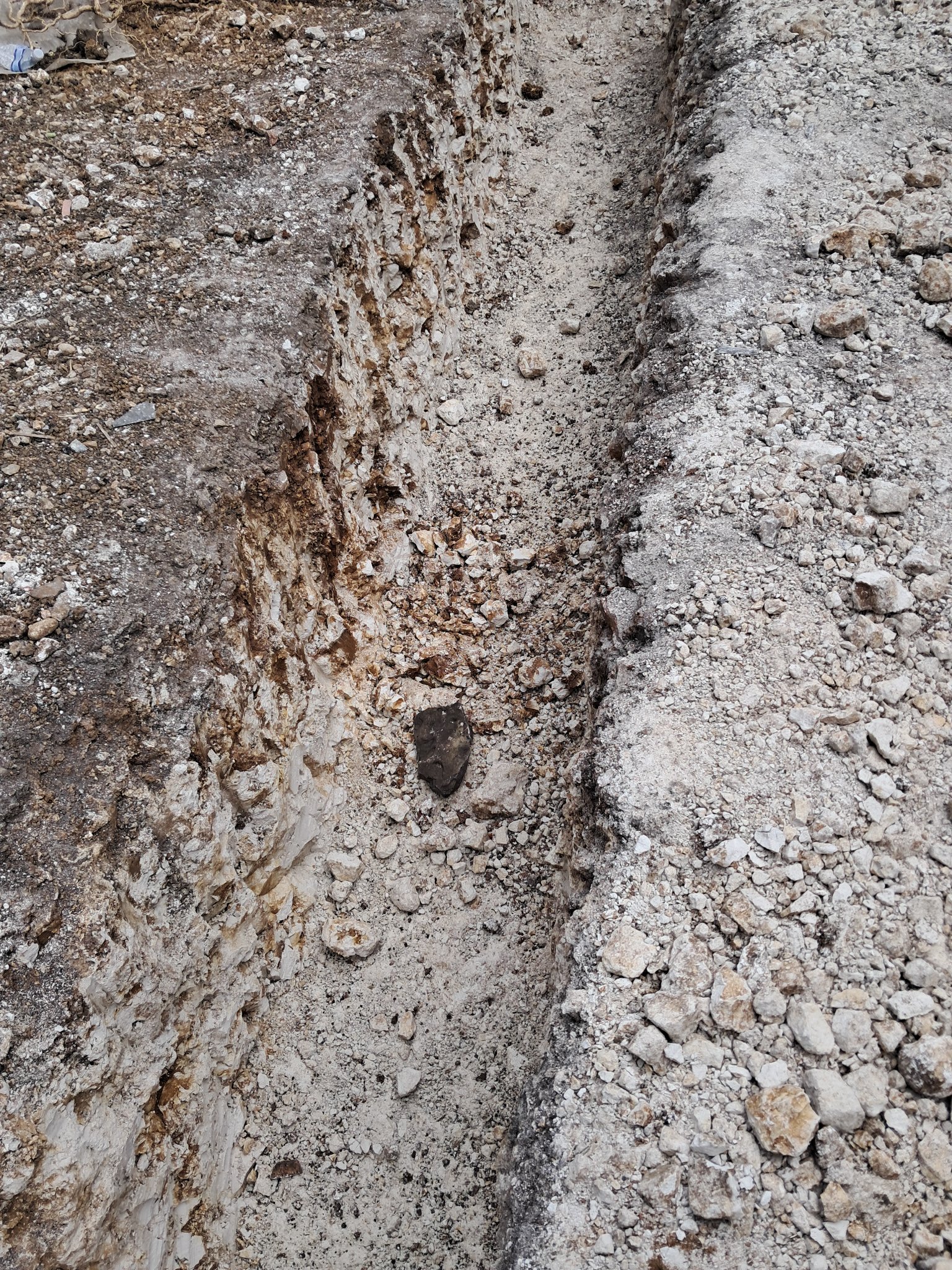

Given the obvious level of cowboyishness, I'd be more worried about whether it's deep and wide enough to support a building. Do you have photos of the trench before filling, or did you measure its depth and check it was down to clean subsoil? i.e. not black or brown.
Unless you're certain it's definitely OK then the answer may be to break out the whole lot and start again.
Are planning and building control involved? If they aren't they probably should be, looking at the scale of it and the adjoining neighbours.

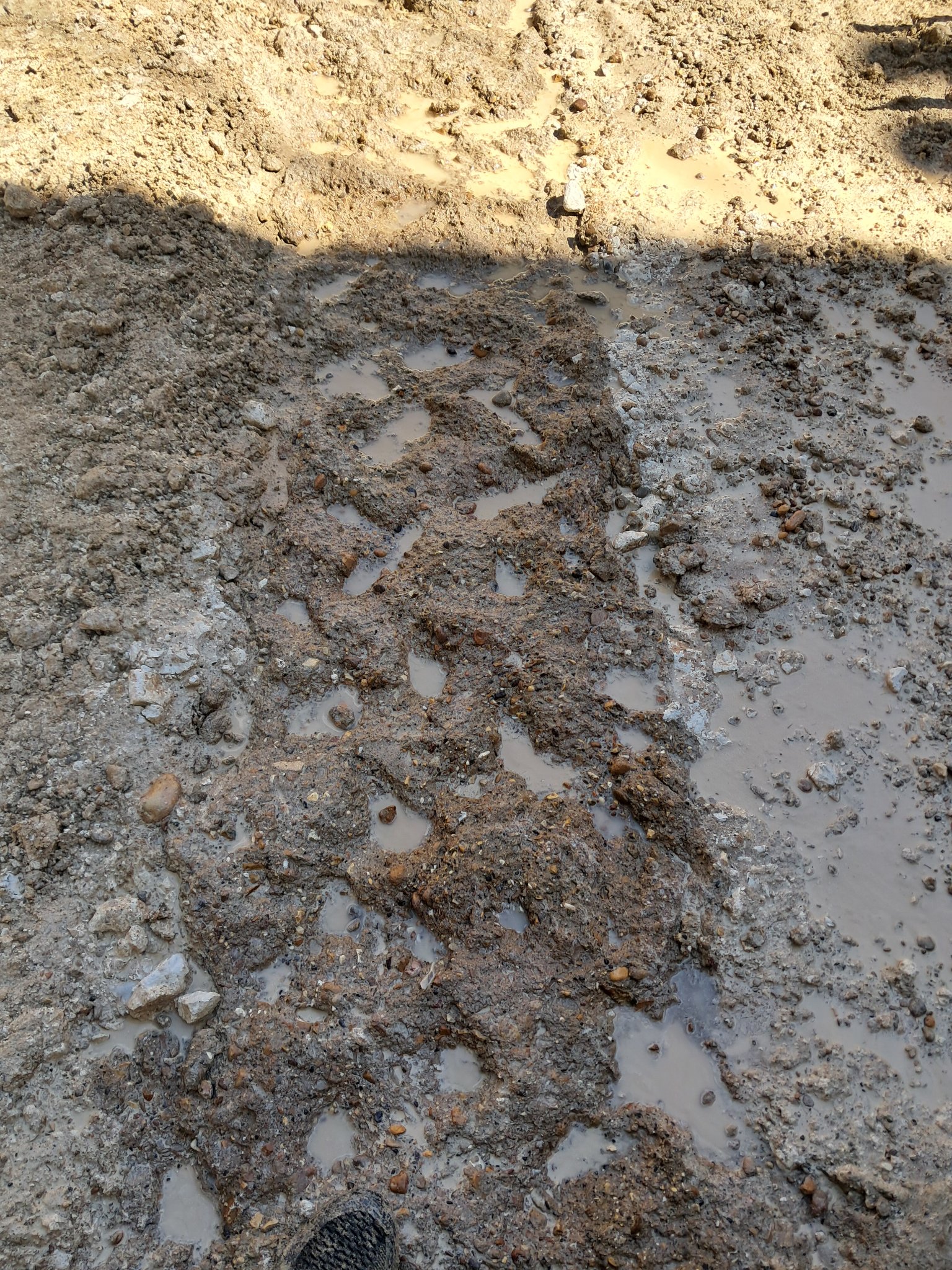

This is the current state of my footings. How do I make the surface smooth for brickwork?

500-600mm wide and deep

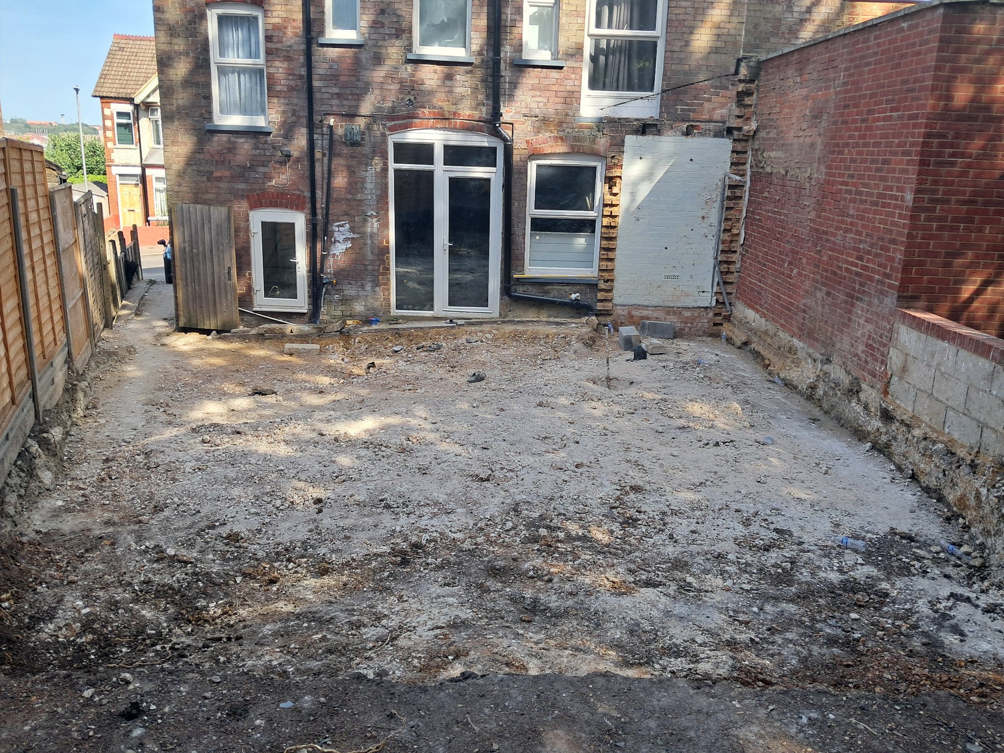

This is a 6m × 6m single-storey extension with one beam in the middle, while the original rear wall will remain in place.

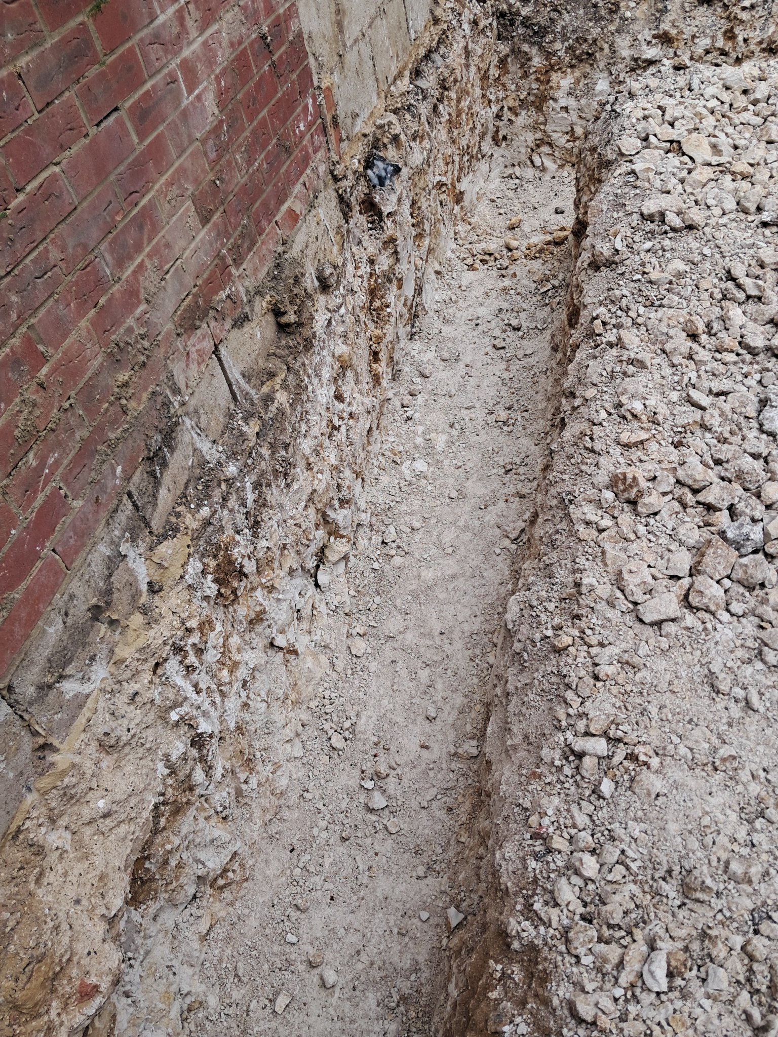

That means your foundation depth is only around 600mm deep, as the top of concrete is ground level, and if traditional build the width is too narrow, building control aren't involved here are they?
Building Control is involved and has approved a 600mm concrete pour. It appears that the neighbour's trench is approximately 400mm deep.

If BC are happy with the depth (surprising: you must be on ballast or similar) the width is fine.
We aim for top of found to be 2 courses below fgl to allow the brickies room to take out any errors out of sight and plenty of room for whatever surface you're going to add.
Having done so much I'd keep trimming: so long as you can get the first course of bricks true you should be ok.

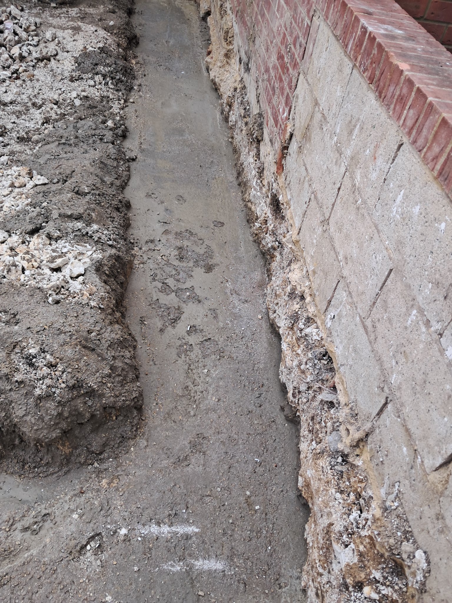

Get a wide chisel on the breaker rather than a point to finish. Get at it asap: that concrete will be getting harder day by day

Comparing against a neighbour's foundation is meaningless. It was built in a different time, it may not have been done to standards then, and may be full of cracks anyway.
Break it all out, do it properly.

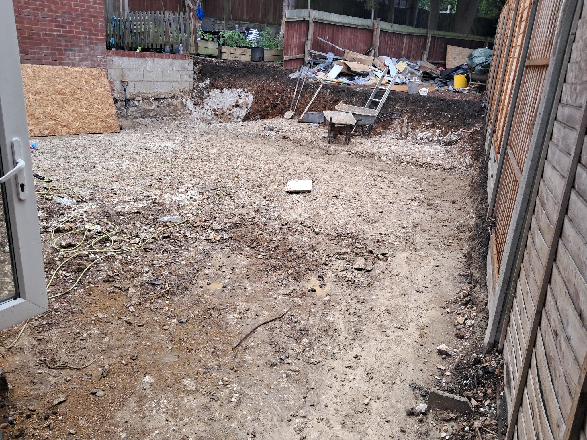

Pointless digging it out. I'd hire a Stihl saw and slot it to a fixed depth, before breaking off. Like chopping out a lap joint in timber.
