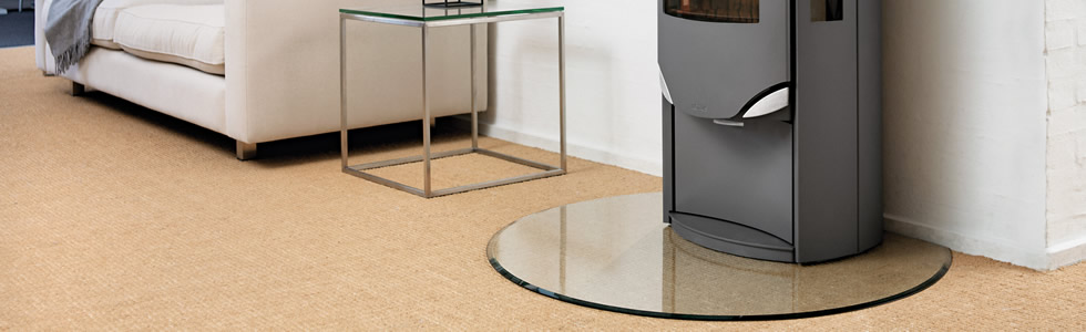

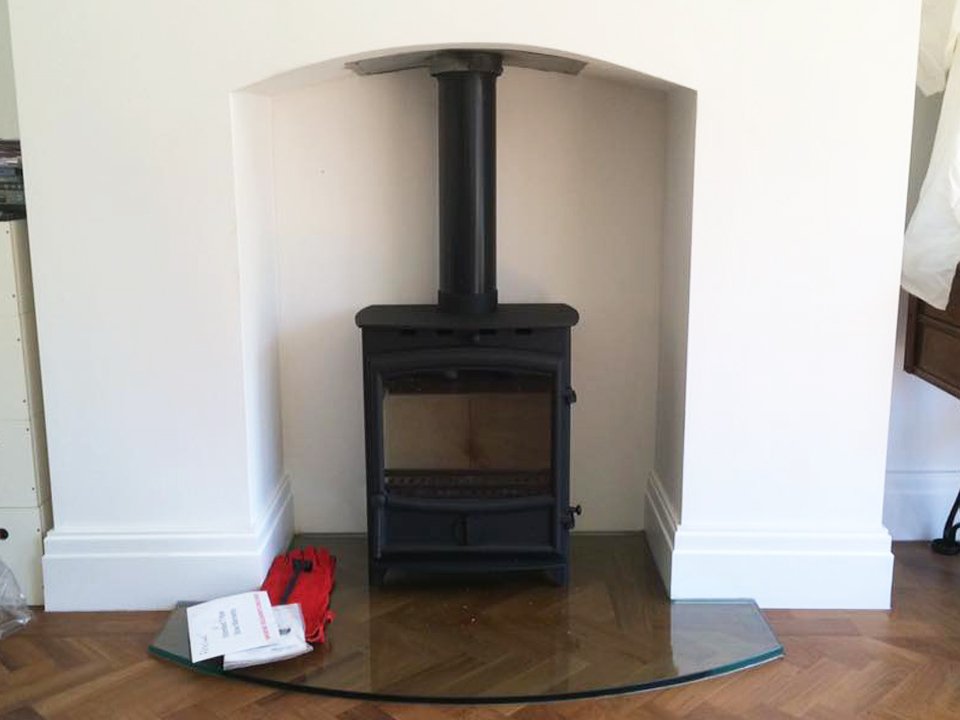

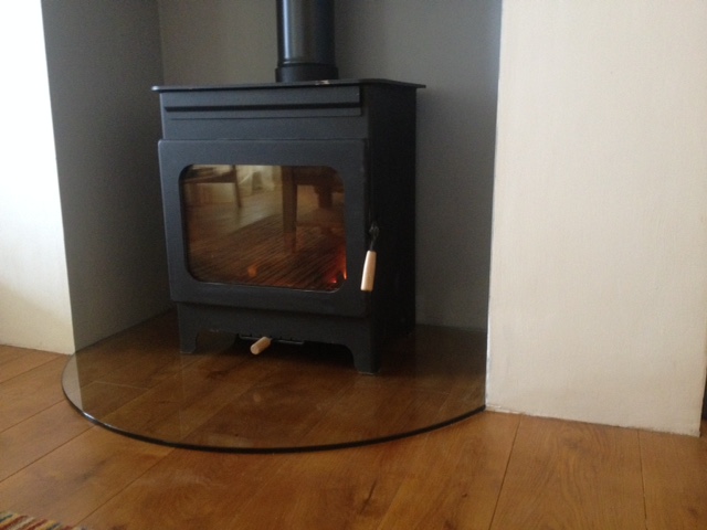

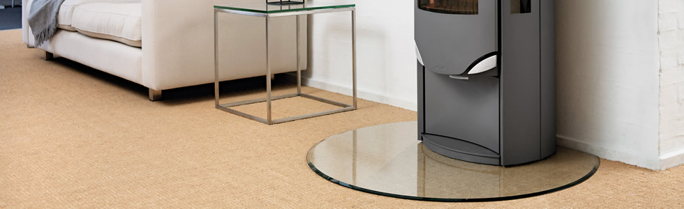

https://www.google.co.uk/search?q=glass+hearth

Different rules apply for free standing stoves to ones installed in a fireplace recess?.
litl
Not really, you still need part J and distances between combustible sources.
Op is installing a free standing stove.
By the way I am not saying any of these installs conform to BR but they are what's being done and Heatas registered installers are doing this type of install also.
I think it depends on the stove.
Mine states in the manual it doesn't need to be placed on a constructional hearth and can therefore be placed on any non combustible material eg glass of a suitable size.
Quote from manual:
SUPER IMPOSED HEARTH
In certain circumstances Building Regulations allow for a super imposed hearth. This must be a minimum 12mm non- combustible material e.g. slate, glass, steel. This stove comes with 72mm minimum leg detail which does not ex- ceed 100°c and therefore is suitable for a Super imposed hearth. With the addition of Woodwarm accessories such as legs, plinth, pedestal, the hearth temperature is further reduced.
