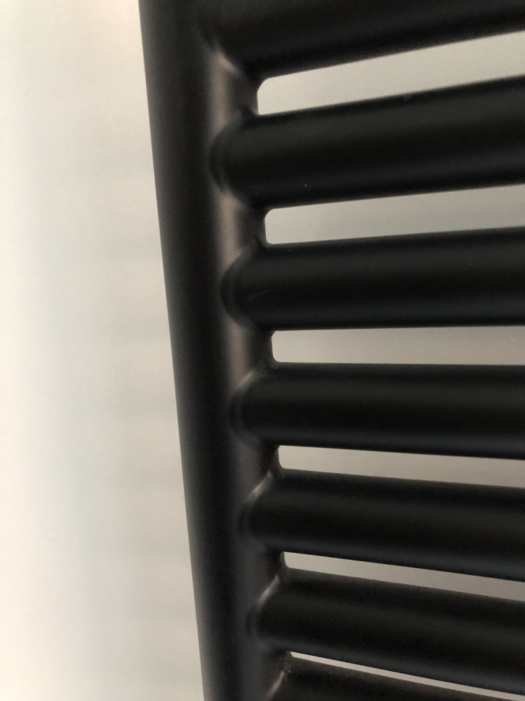

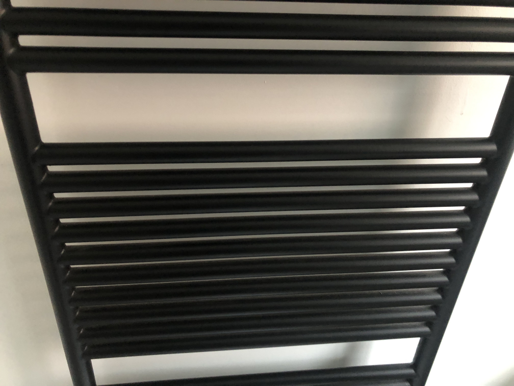

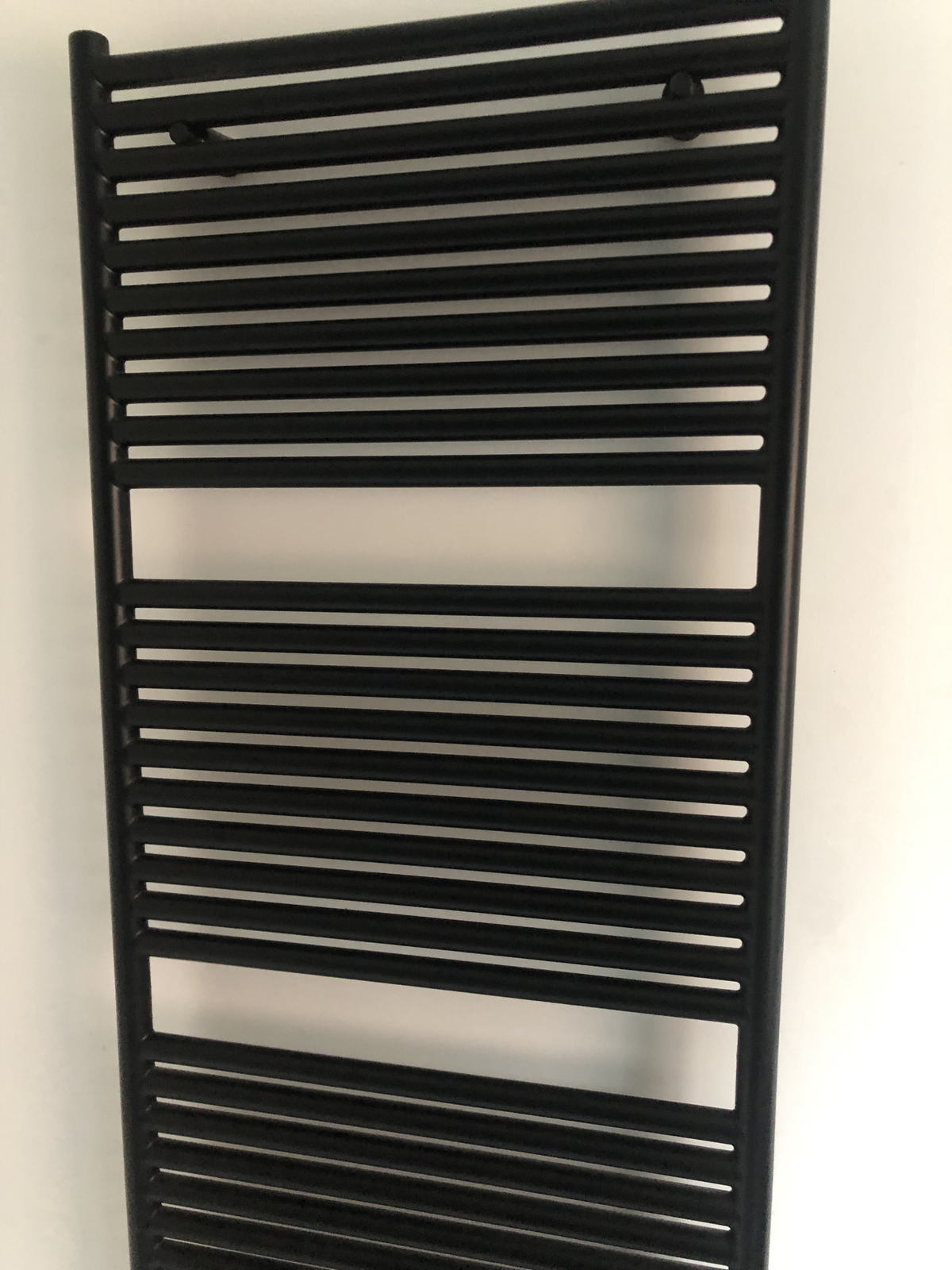

Sorry but your pic doesn't really show the finish very well but as far as finish is concerned then yes - this used to be gloss white. You honestly wouldn't know it wasn't black to start with
