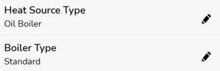

Last year, a micro switch in the motorised valve stuck, so decided worth testing all is working. Last night I noted the TRV in wife's bedroom was cold enough to bring the heating on, and thought I had heard it working, but latter clear not running, so this morning it was a trip to the flat to test all.
The Wiser wall thermostat first took it just above room temperature, the icon changed in the app, but the hub did not do a thing. So tried Nest Gen 3 thermostat next, that fired the boiler up straight away, then noted the Wiser hub show the run light, so turned Nest down, heard it click off, and boiler still running as expected, so turned the wall thermostat down, and it did switch off, so now try the TRV, noted the tick on the app then the flame on the app, but it was a few minutes before the boiler fired up.
Allowed the boiler to get warm for a few minutes, then off again and worked A1, so again tried the wall thermostat, and again quite a delay, it works, but is this delay normal and part of the Wiser algorithm, or is it a fault?
I know with refrigeration after switching off, there must be a delay before switching on again, I see no setting in the app for oil, gas, or electric, so maybe there is a delay? I also know should not turn off the oil boiler until it has fully fired up, but seemed no delay turning off.
The boiler is oil fired, but I fitted thermostats and saw no setting for oil or gas etc.
Are you using a wiser trv in the bedroom or just the wiser thermostat? It is normal for there to be a delay with firing the boiler due to how wiser works, this is why you shouldn’t mix n match heating controls.
The gas or oil boiler setting is in the wiser hub and would have been configured on initial installation.
I use TRV (Wiser) in the bedroom to fire the boiler, wall thermostat (Nest) in the hall, and wall thermostat (Wiser) in the living room, and an old bi-metal in the flat.
Ups, I installed it, don't remember any setting in the hub for oil. But going into the app, I must have done, 1757670240520.png did not remember setting this.

If you have the boiler type set to Oil the Wiser system will divide each hour into 3x20 minute slots (it decides when the slots start, they don't start on the hour).
A thermostat calling for heat will create a percentage demand depending on the difference between the room temperature and the desired temperature.
The boiler will switch on for the demanded percentage of the 20 minute slot.
This is a simplified version of the algorithm.
If you turn up a thermostat slightly above the current room temperature it will create only a small demand and, depending on where the system is in the 20 minute slot, this creates a delay between the change in stat temperature and the boiler firing.
If you want to minimise the delay then turn up the thermostat to at least 2 degrees above room temperature which will create a 100% demand.
