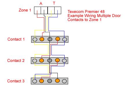

I have wired a Texecom Veritas Panel before OK and now I'm moving house I want to fit the Premier 48 Panel.
I don't plan on using EOL wiring as it seems over kill for a domestic house and I'm less confortable fitting it (know your limitations!). I plan to use flush contacts and all wiring buried in the wall. From my experience with the Veritas panel I have done a wiring diagram for a zone with multiple door contacts, if someone could confirm its right before I order the kit!
If anyone fancies drawing this using EOL wiring, as I like to learn it would be appreciated and from search forums its something a lot of people have trouble getting their head around.
This is taken from the Premier 48 Inst. Manual.
Buy the kit and follow the book
Yes your drawing looks right. If you have more than 1 door contact on a zone/circuit then the EOL way can be confusing for diy so best stay with the basic way.
