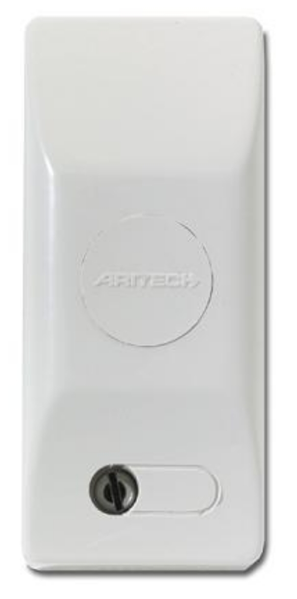

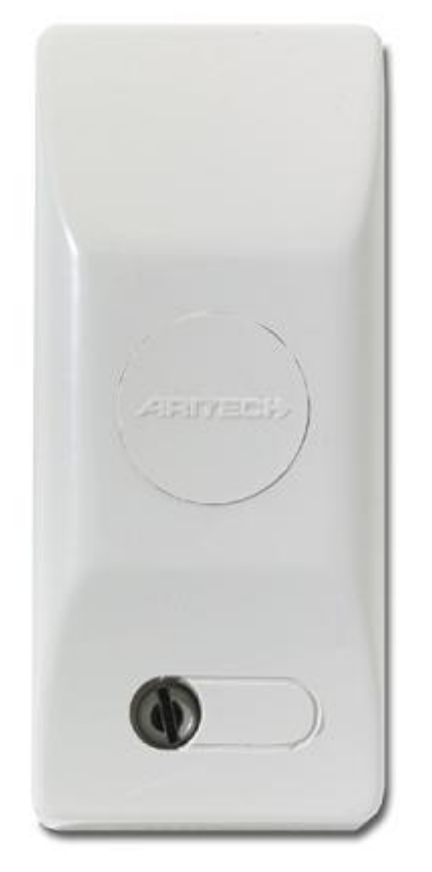

Think you need to post a picture of what you have on the windows
They are like the attached picture.
I think there are ball bearings inside that generate alarm under vibration. There is also a tamper circuit.

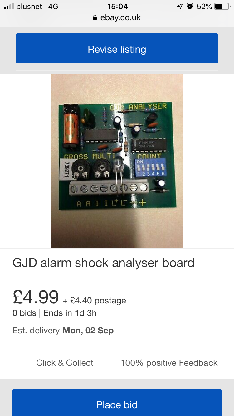

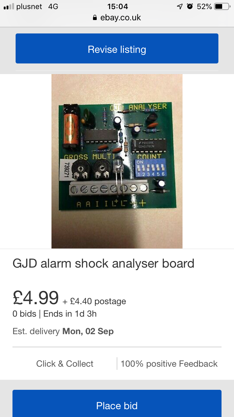

Was there a small pcb inside the control panel that these where wired to ? If not your going to have to buy some !
854256F2-839D-4E50-BE36-B969FB316DEA.png Like this ....try asking Europlex on here , he may know if that panel had the analyser built in , we used to fit hitec years ago that was aritech and that had it built in , I think I still have some of the window sensors kicking around
View attachment 170079 Like this ....try asking Europlex on here , he may know if that panel had the analyser built in , we used to fit hitec years ago that was aritech and that had it built in , I think I still have some of the window sensors kicking around

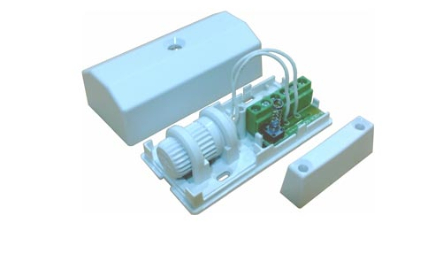

When the cover is off, it looks like the attached picture(minus the magnetic contact).
I'm getting the feeling that we will have to buy the texecom impaq sensors for each window.
I thought that if magnetic door contacts were ok for the texecom then these simple sensors would work the same.. A circuit with no power required (no pcb)

Ok so an update, an analyser board is required for each of the old inertia sensors.
At around 8 quid each it's a no go.
As new impaq sensors are a tenner!
