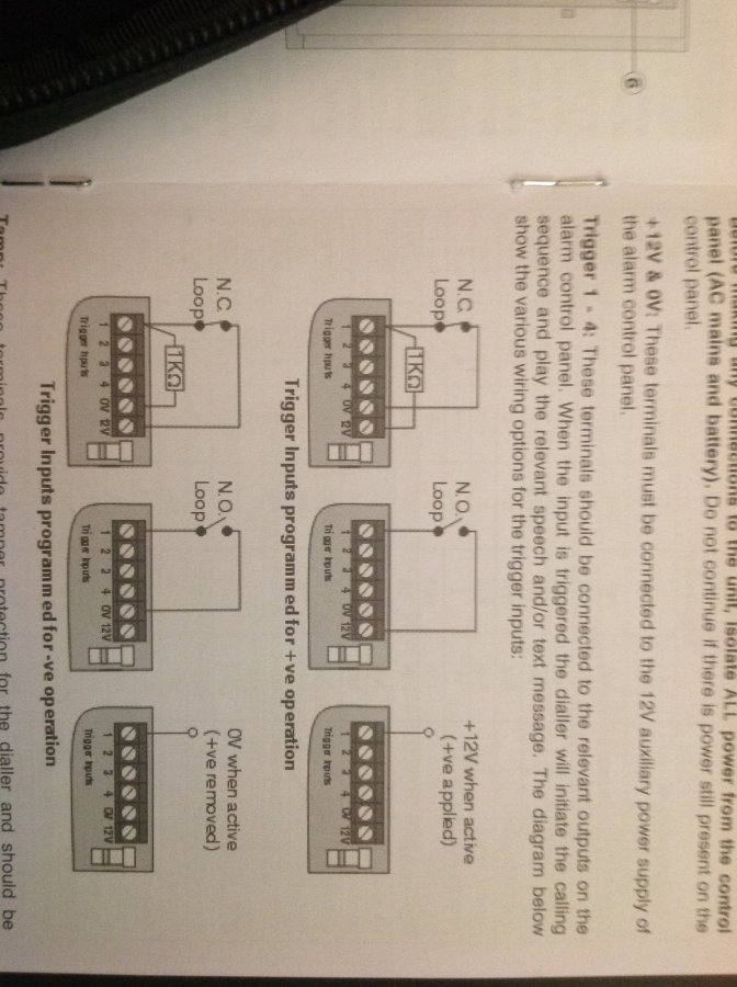

Morning, expander is now working with pirs so thanks for that. Gonna look at the speech dialler tonight just not sure what this's all about
wire it straight in from the output
should be okay as is, worst case you invert the output or change the input from -ve to + but at default should work with panel.
