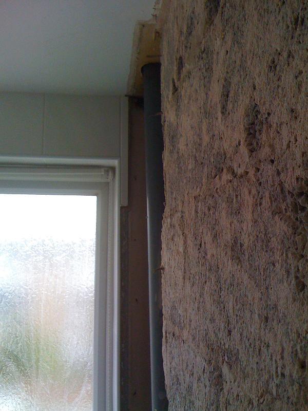

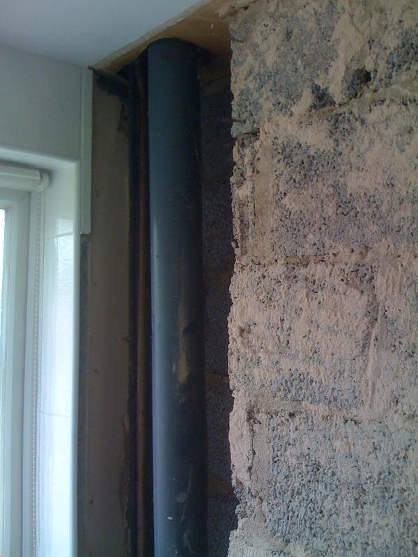

Prep work before dot and dab
I've read on here that i should wet the wall first, or should i just water some PVA down and use that?
also what sort of gaps should there be between the dabs?
