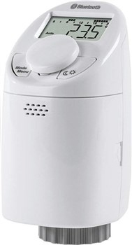

and the thermostat was more like a building management system. Drayton Wiser claim to have built in algorithms to speed up temperature changes without over shooting. But there is also the non linked like the terrier i30 and the eQ-3, the latter can be got in a bluetooth version so where there are two radiators in one room they can be linked.

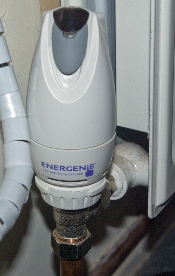

The problem seems to be manual operation, this
Energenie TRV head has very few manual controls, it is a clever head with two sensors one for air and one for water, so compensates for radiator being hot. And on the computer shows both target and current so can use that to set the lock shield valve, it can connect to some wall thermostats, but wrong way around, the wall thermostat sets the TRV, not the TRV setting wall thermostat. So the much cheaper eQ-3 (I paid £15 each for bluetooth version before brexit) with window open detect, and full manual control,
is in many ways better, I walk into room, press the right hand button and it swaps from eco to comfort mode, but does not link to boiler.
