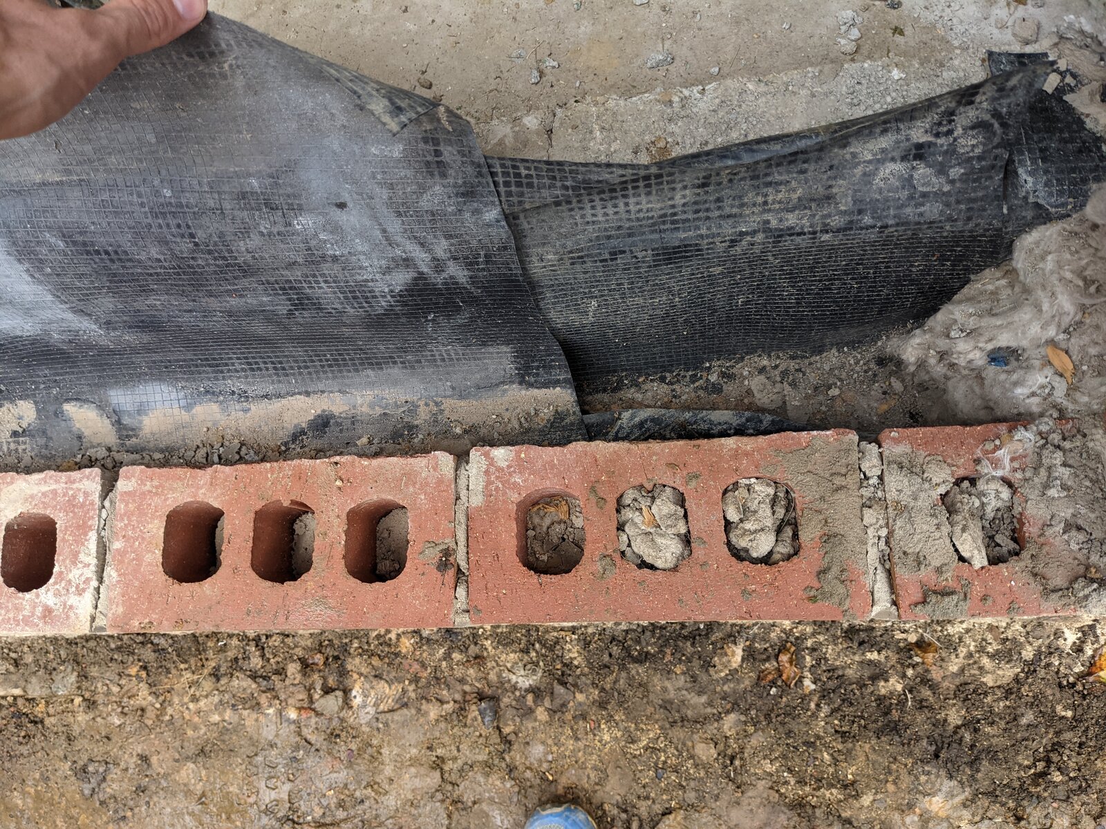

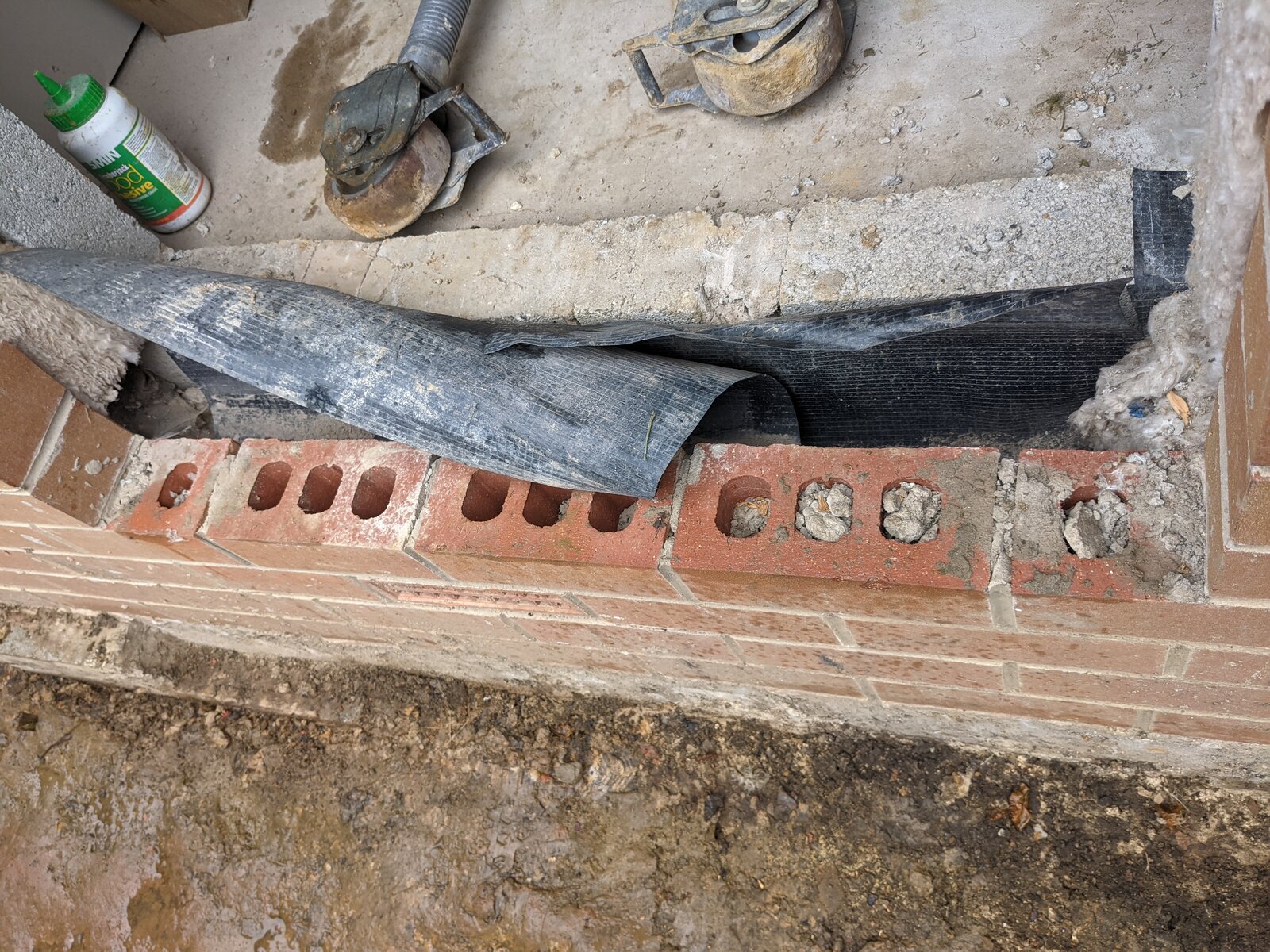

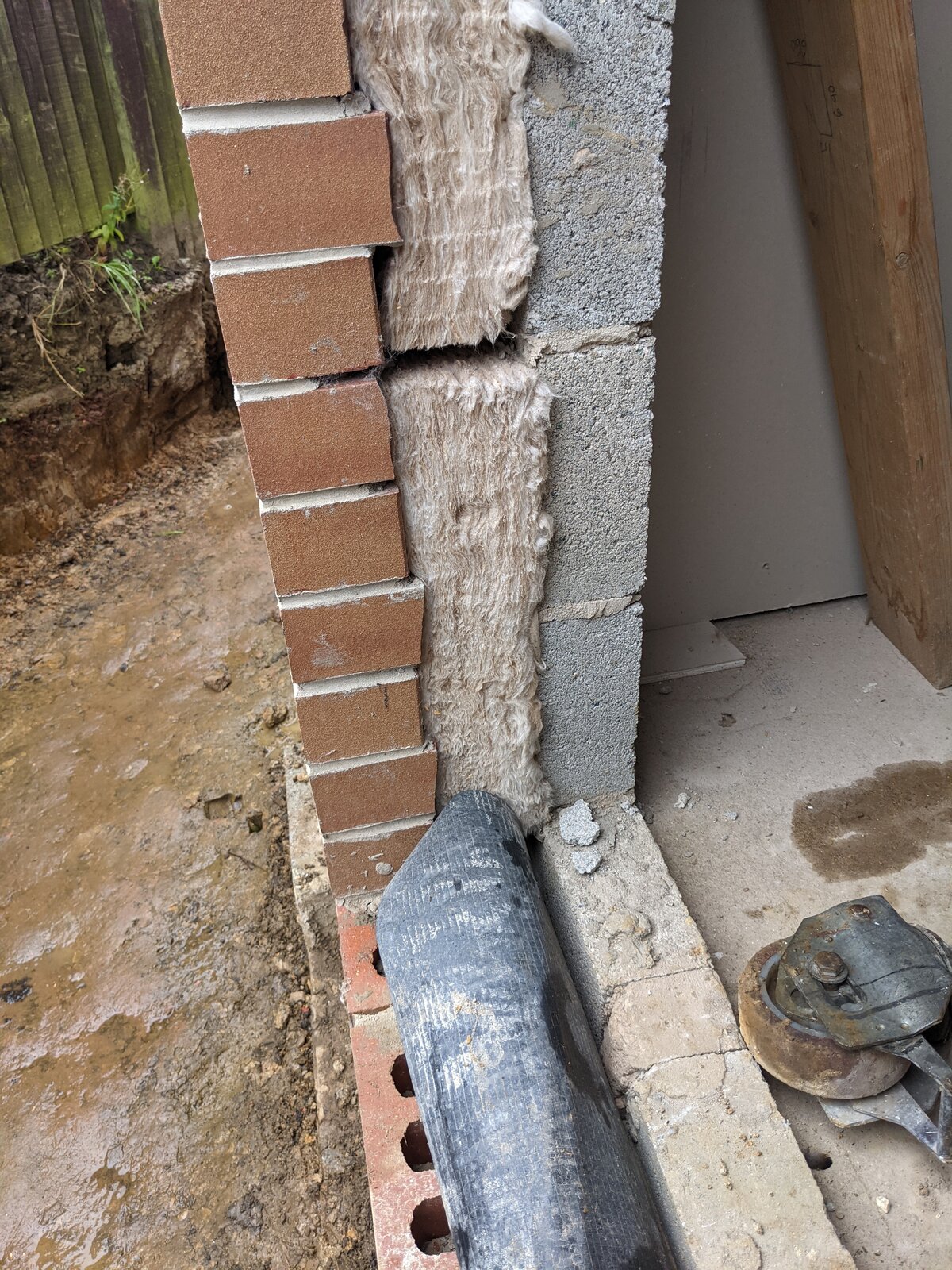

Basically we've not heard from our builder in weeks (extension).
A joiner is coming out to fit an oak door frame and door in the opening (pictures).
What do I need to do to get the opening ready?
  • I assume the opening needs cavity closers on both sides?
  • Does dpm go behind the whole frame because it's timber?
  • Where does the existing dpm go?
  • Guessing I will have to cut the blockwork level with the bricks too?

Thanks, we have done. Fitting the door won't affect any of the inspections but it does need doing - upstairs has been knocked through and it's getting draughty in the house.
