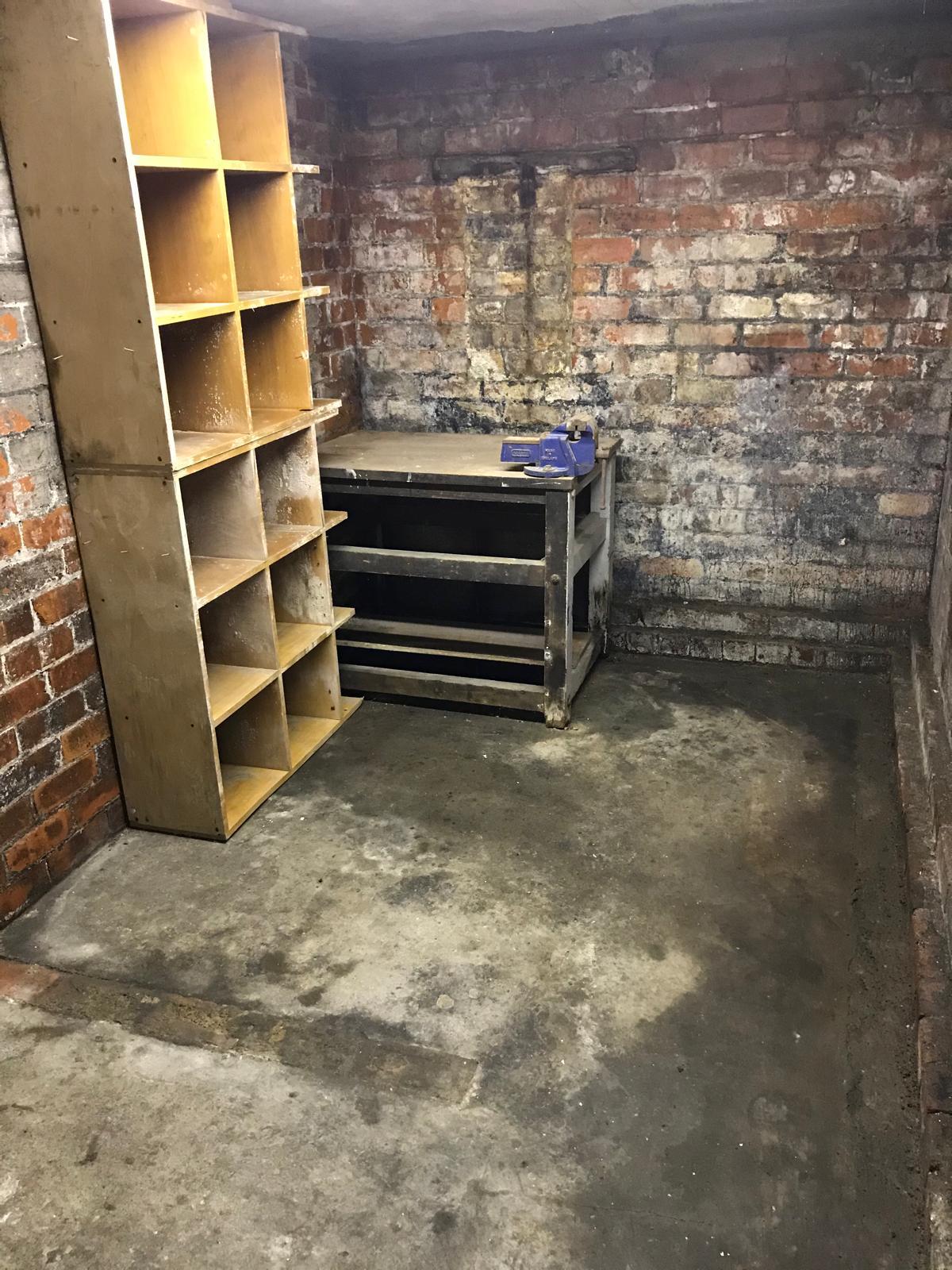

Tanking out my cellar and need to remove paint and clean down some old mould growth from the cellar bricks prior to applying tanking slurry.
What is the best way to achieve this?
Cheers
Nitro Mors and a scrubbing brush for the paint and bleach or mould and mildew cleaner for the mould
That's how I would do it anyway
Do appreciate what appears to be a coal cellar with coal hole too , love the smell of a real fire
