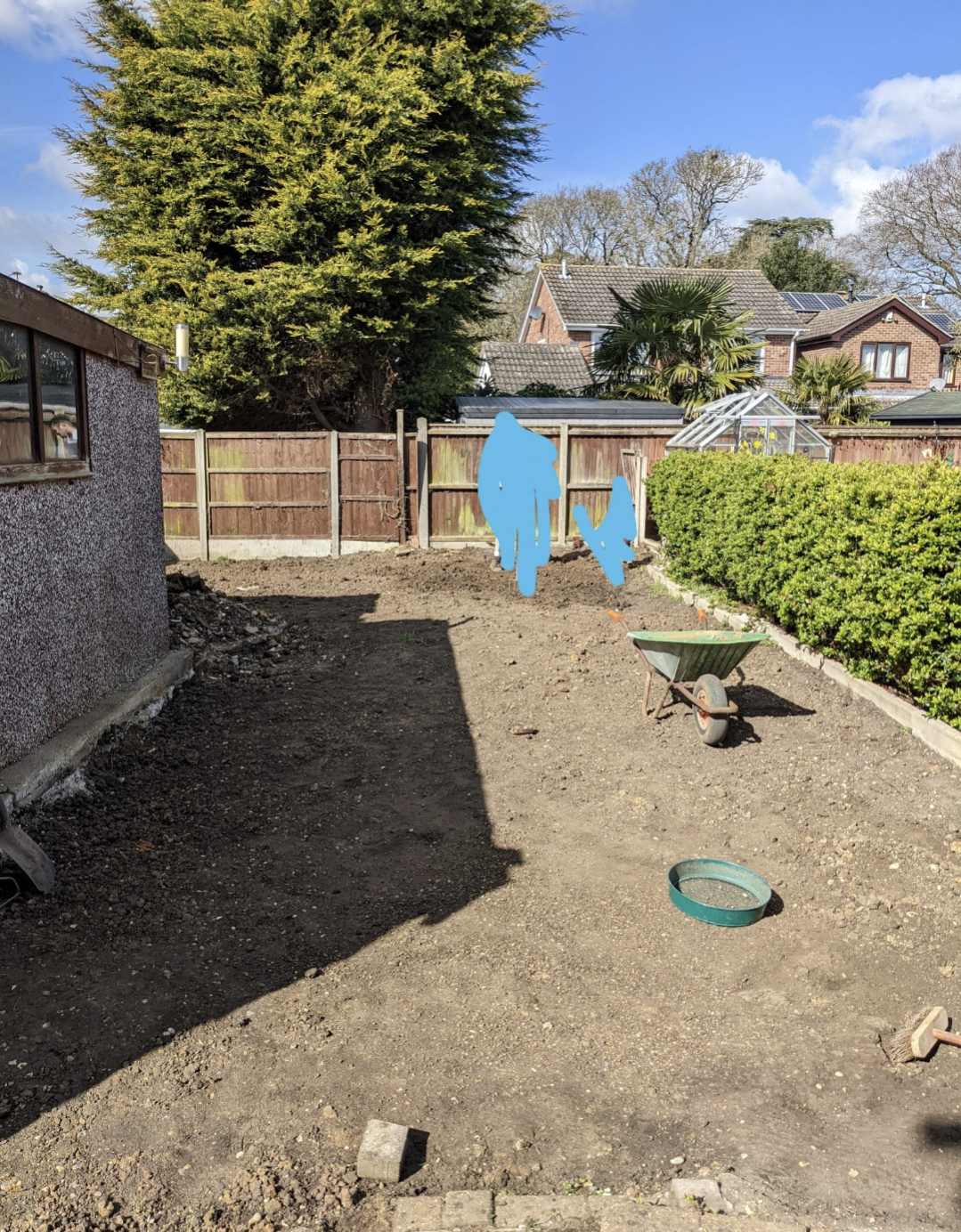

We need help knowing what to do next
We've cleared paving slabs, tons of gravel and monstrosities from this garden. We're wanting to lay turf but there is so many stones, clay beneath that and sand mixed in where the previous owner had used I assume to break up clay.
Any suggestions?
You need to achieve at least 100mm depth of topsoil.
You can either buy topsoil of that depth if you can afford it, and the height.
Or you can improve the current soil until you get it to decent topsoil.
