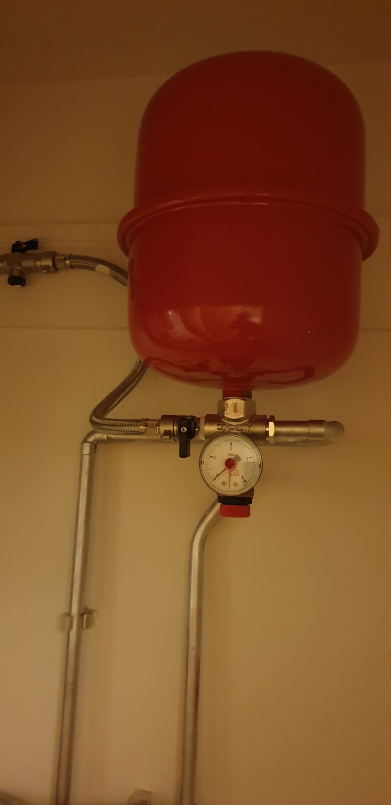

Please can anyone help me with how to water pressure for my extended vessel, picture belo. Tried everything out cannot open it. Do I need special tools.
Thank you
Hull
I’m no expert but I don’t think you pressurise that vessel with water. Looks like your heating system needs topping up. Open both valves on that flexible hose.
edit: As lightning says above.
Open the two back handles till 1.5 bar then close them
"black" handles
They are open when the lever is in line with the pipe.
There are two so that when you have adjusted the pressure, you shut them both, because it is important that there must be no leakage at other times, even if one valve might become worn or fail.
Leakage could allow water from the heating system to contaminate the fresh water supply to the house.
To ensure this cannot happen the flexible hose should be disconnected after the system has been re-pressurised
Hence the flexible hose connections are designed with wing nuts that enable them to be undone by hand without the use of a tool
