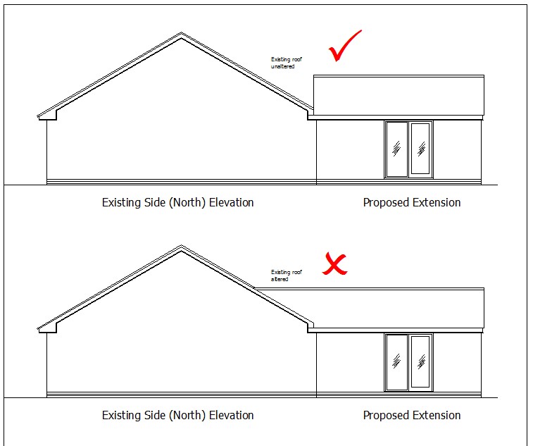

So I thought I would provide a quick update. I had a chat with the planning officer and they are sticking to their guns over the extension roof not touching the existing roof so I did the quick sketch below to illustrate the problem. Bonkers.
The Planning Portal mini guide shows this, so the existing roof altered is PD?
The Planning Portal can give that as an example, but it is not law. Frequently they interpret their own rules incorrectly,as at least two Appeal Court cases have shown.
The example I showed from the Planning Portal (and I can't find an example anywhere else including the Government's Permitted development rights for householders technical guide) is a solution I have seen in PD many times, some even having a LDC issued. Are you saying the Planning Portal info is definitely wrong?
