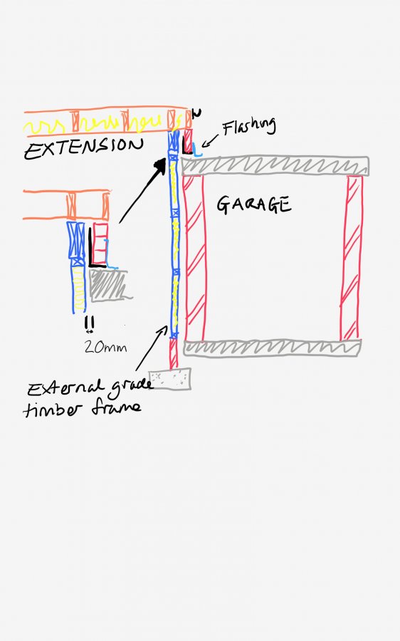

On a separate note, just received refusal in writing. They make reference to the extension having a width greater than half the width of the 'original dwellinghouse'. How they calculate this...would it be half the width of my house and garage combined i.e this measures 6.4m and therefore I could build extension up to 3.2m or do they just take the measurement of the house?
The width of the house is the width of the whole house, it's all as clear as day in the technical guidance I linked to.
Yes the width of the original dwelling house is as the dwelling was built, or how it stood in 1948 (think that's the date!) Is the garage original? If so include the width of the far wall of the garage to the part where your house ends, and meets your neighbours, that would be the original width of the house (about 6m ish looking at your drawing).. If that's the case your extension your proposing can be 3m wide.
If it's not original, then the width of your house would be just the physical 2 storey house section (roughly 4-4.5m ish from the drawing).. If that's the case then you would be allowed probably less of an extension because you already have a side extension as a garage, and this additional extension would exceed the half the width of the house rule in almost every scenario.
You can leave it detached from the garage in some way, and you can do the "rear" extension then under prior approval. Fencing isn't great to overcome the problem, because you could just remove the fencing after the approval, and the issue is still there.
Is the neighbour that you are attached to bothered about this extension / going to complain?
Attaching it to the garage makes it a wrap-round extension which is not allowed under PD rules. As Freddy says, get your money back and use it to make a planning application. (using somebody that knows the rules)
Yeah I understand, What I was trying to get at is that if the garage is not original then the wrap-around element comes in to play, and as the OP already has some "side extension" elements then she will be allowed to extend barely anything at all that attaches to the garage wall, under PD (like 0.5m or something ridiculous) Wrap arounds are allowed under PD as long as they conform with the side / rear rules still.
Def. go make an application, or just leave a gap and have a bit of an awkward extension not linked to the garage, that's tricky to maintain..
What about if the extension is kept separate and bridged over the garage to gain maximum room?
If it is completely detached from the garage, then you could overlap / bridge / it yes in terms of the legislation it wouldn't need permission.
However, I've seen cases where the council have still taken a view that (after an application had already been put in or works had started - can't remember which) that the extension would still require permission because the intent / harm would still be there. I personally don't think that was right, and would of liked the applicant to challenge it and / or take it to appeal, but they just submitted an application anyway.
