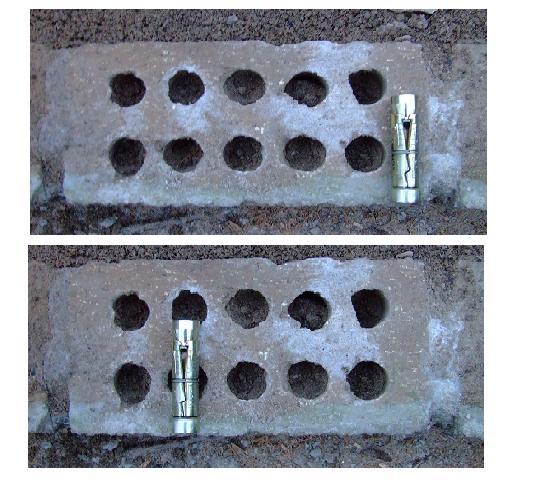

I'm trying to bolt vertical 90mmx90mm posts to an existing slabbed patio wall and they will act as ballustrades for a deck on top of the patio.
I was going to use rawlbolts with hex heads M10 going into the brick 65mm (and taking max fixture 75mm, ie I'd rebate into the post).
The first two I tested didn't work because the bricks have 10 holes and the conical end of the bolt either can't grip or is fouling on one of the holes.
Also, not enough brick at its outer edges to secure the bolt.
Picture attached to show the problem.
Can anyone help please - is there another type of fixing which would be strong enough ?
I am guessing some form of resin injection will be required, but then I have never come across this issue, so others will give more advice.
thanks wabbitpoo - resin looks the best option. spoke to a technical guy at rawlplug today who was very helpful and suggested the same thing
