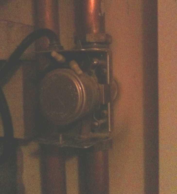

The thermostat is as you say a third the way up the cylinder. It's a little rectangular box with a turn knob on the top for adjusting the temperature. The Temperature is set to 90. It's not secured by a strap. There's two black wires coming out of the bottom, one goes to the Honeywell 2 port valve and 1 goes to the timer box. I can take the front of the little box off and there's the wires inside I can access.

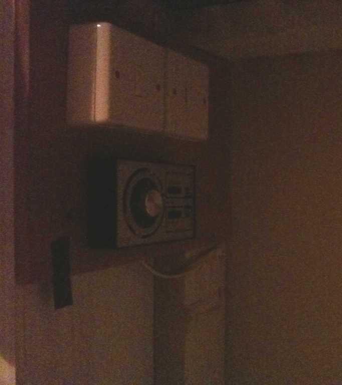

I can take some pictures of the system if this would help?
I've switched the hot water and central heating on and off a couple of times and the 2 port valve does nothing.
I've twiddled with the cylinder thermostat as well and that does nothing as well!

A couple of pictures may help
Make sure the clock is calling for heat and then turn the stat up and then down to make sure the valve is motoring.

What I mean by a short circuit is the cylinder close to the boiler
As you can see from the pictures, the cylinder is pretty close to the boiler.
I've tried turning the thermostat switch whilst the system is one and the 2 port valve does nothing.
