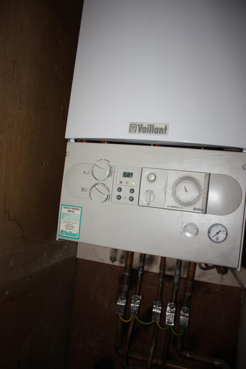

Hi,
I have just moved to England last year and having problems with my vaillant boiler. All I know about the boiler is that it was purchased between 1994 - 1998. The boiler was working fine until last night and when I run hot water, nothing but cold water comes out. I noticed that when I reset the boiler, the temperature will rise to about 24 degrees but then drop again. The boiler is also showing, I believe, no pressure (the pressure bar is below 0) and there is no error code. I have never worked on a boiler and hate to say, I am not the DIY person, but tight on funds, I need to do it. Can someone please let me know what I need to do to fix the problem and hopefully, being a descriptive as possible.
Here is what I can tell you about the boiler. There are three lights and the green light is flashing. There is a solid green light to show it is turned on. There is no error code and the pressure is below 0.
Please, help me. I am suppose to be having guests on the 8th for 2 weeks and would hate for them to take cold showers too.
Thank you in advanced.
Andrew

Thank you for your help. After you said that there should be a flap, I noticed these two screws and thought "this has to come down". It did.
The boiler is a Turbomax Plus 824E Combination Boiler
I have taken pictures to show what it looks like. Sorry for it not being the best, it is in a door right next to the fridge in the dark.
Please, if you can help, it would be great. I will do research to see if I can find out what to do on my end. I have no experience in doing this and this seems to be the best board on the net for this type of help.
Also, I was trying to find a manual for the 824E Combination Boiler? I can not find one online that is free. I am seeing that this model has a lot of issue due to no preasure and I hope that is the only problem.
The fill loop is built in on this model it's underneath toward the front on the rhs as u look at it it should have a lever in it if not use a screwdriver
U can c in your picture the 2 brass bits stickin down rhs if u look at them from underneath u will c the screwdriver slots turn them both u will hear water fill the unit an gauge will rise when it gets to 1 bar turn them both off
THANK YOU. That fixed the problem. I will keep an eye on this for the next month to ensure that this fixed the problem for good.
