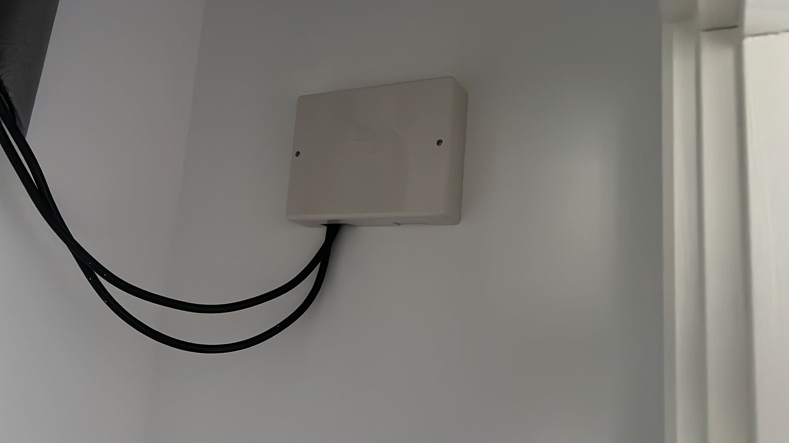

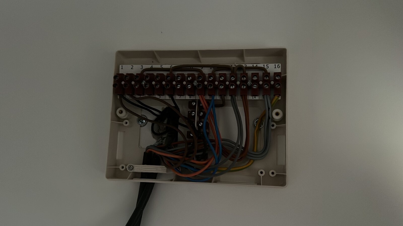

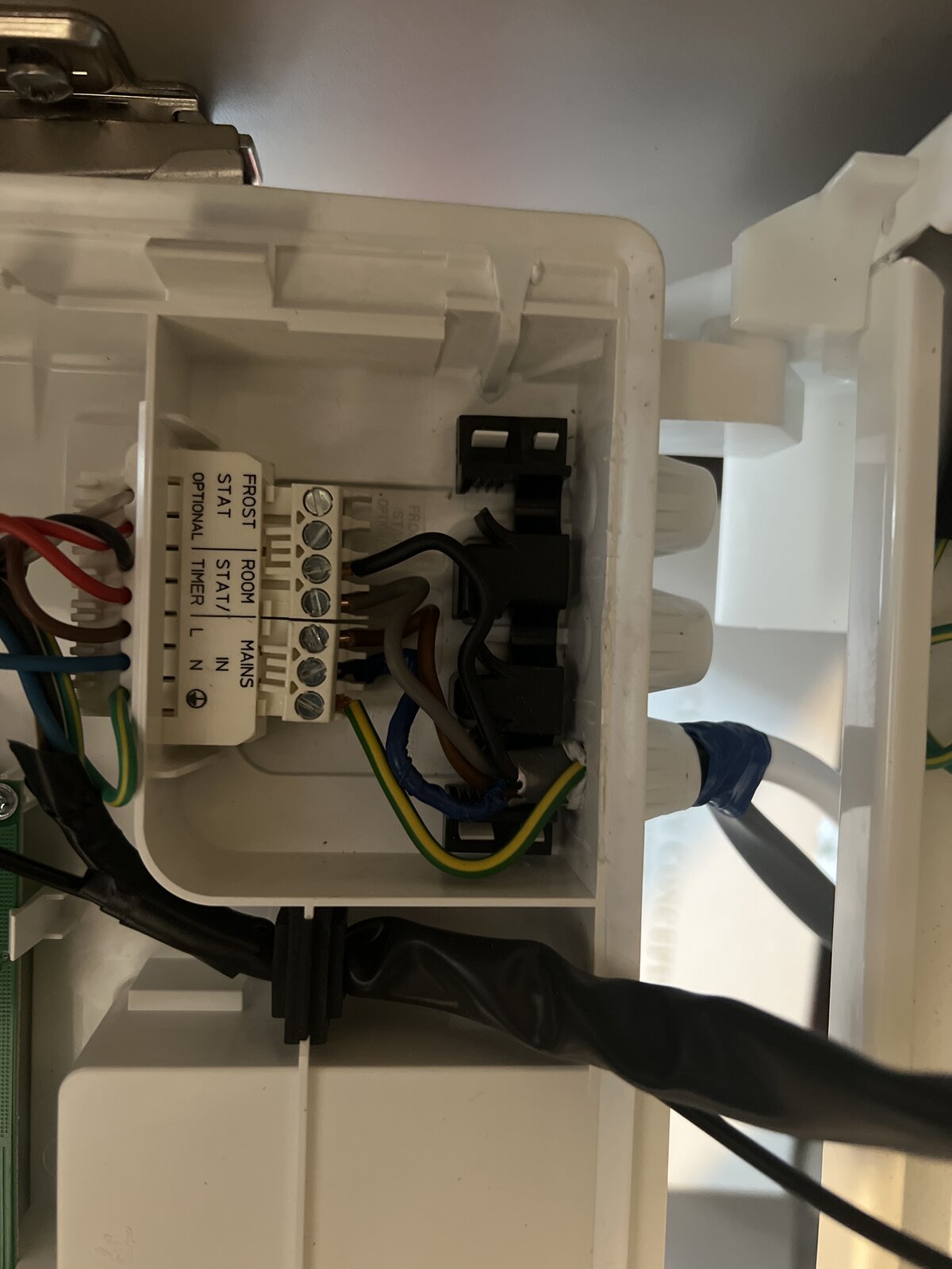

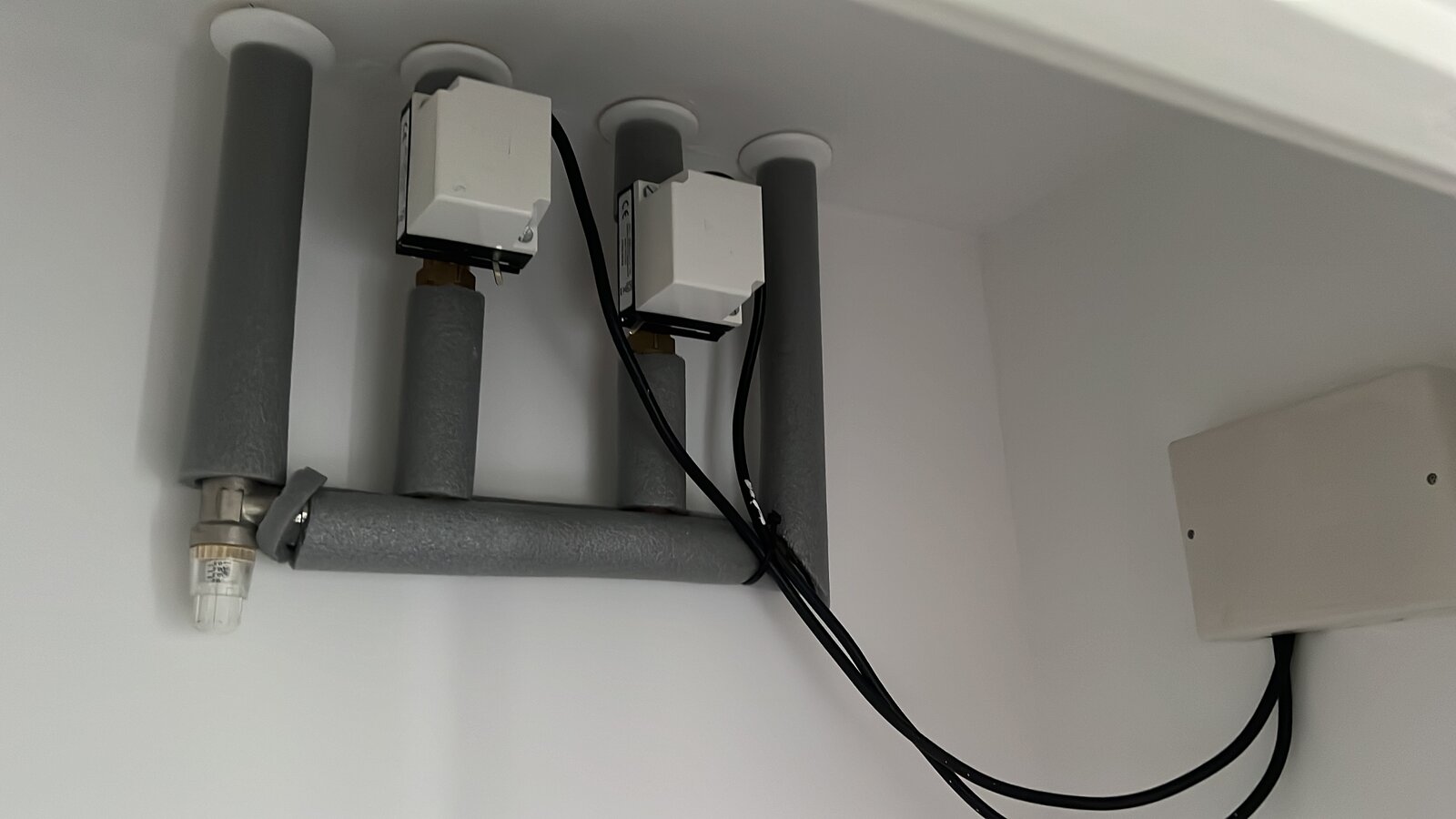

Thanks both for your help, it’s a friend of a friend who is an electrician but granted I don’t think he does this type of thing often - clearly not! The manual flick worked and the rads heat up but they appear to have a relay/motor inside which wants to close them. Is there an easy fix to keep them forced open all the time or is it a case of getting someone else in to rework that box next to them? Thanks
Iv no reason to lie, I’d admit it if I made a mess of it- have done plenty of times in the past. I think it’s a case of him being more a commercial electrician than domestic work and clearly doesn’t work with central heating systems. He told me at the time he didn’t have the right wire so the other flex was added for the earth but I don’t know enough to know what impact they have

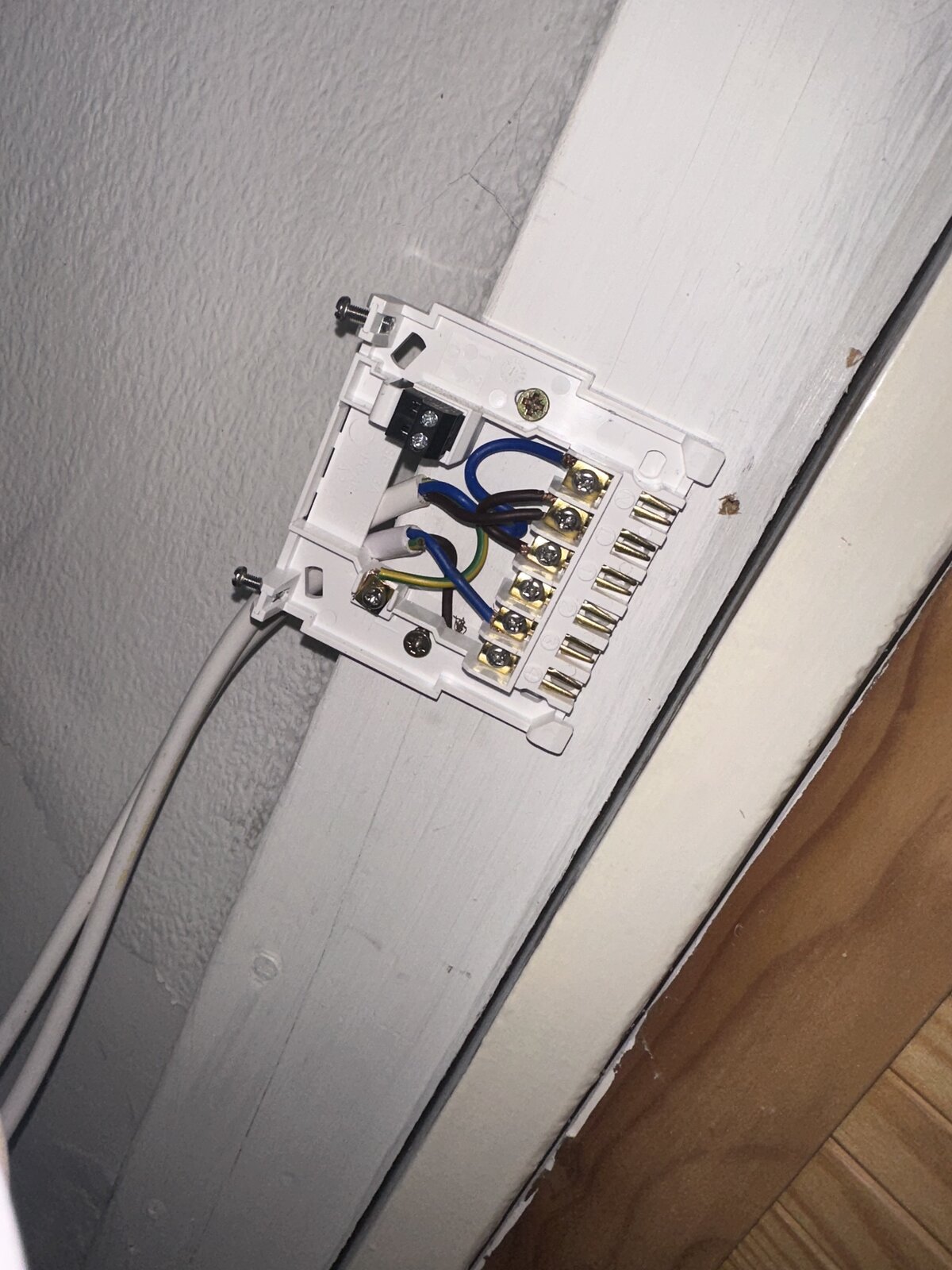

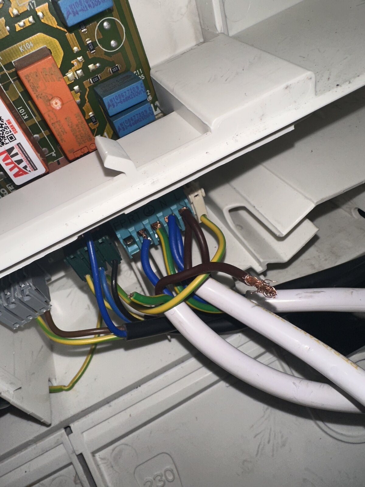

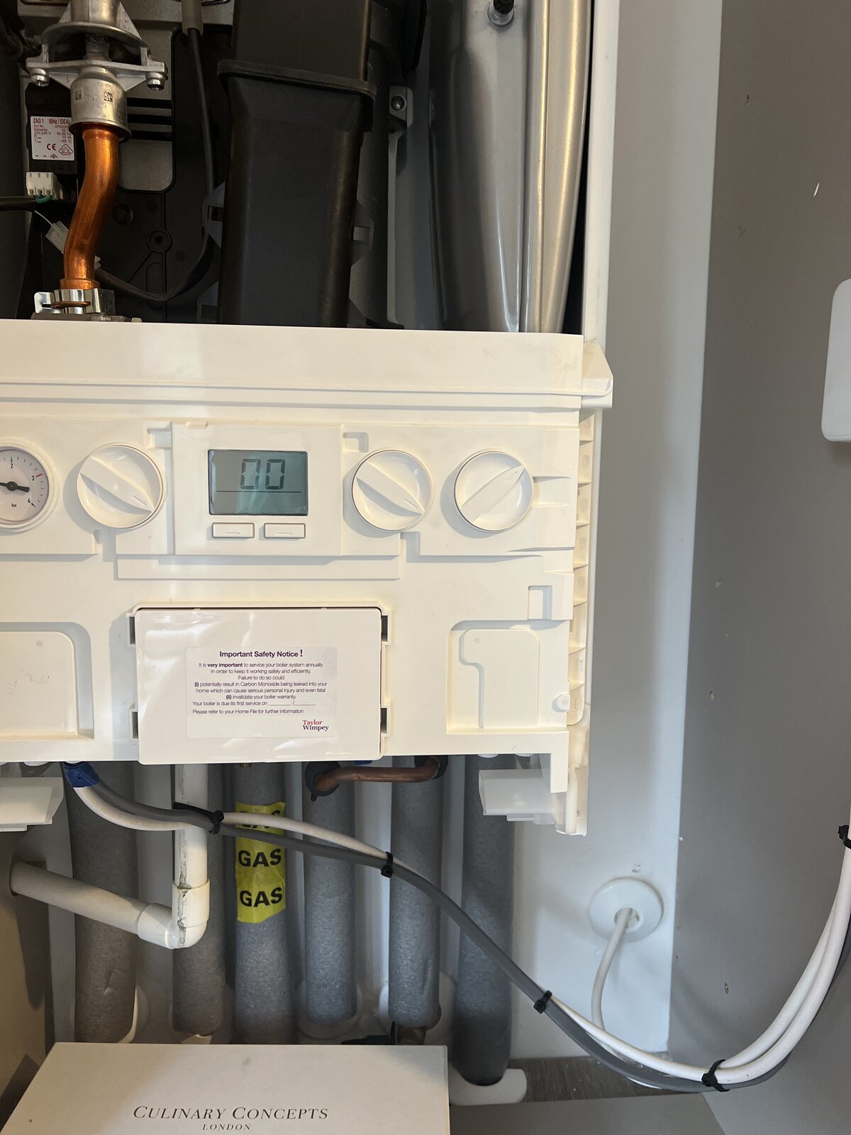

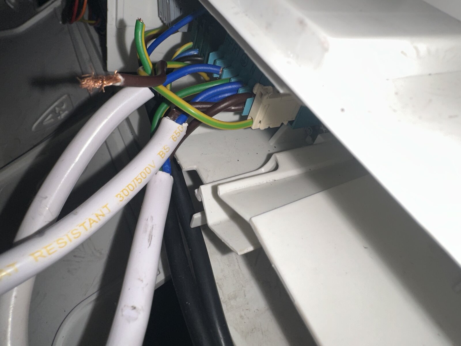

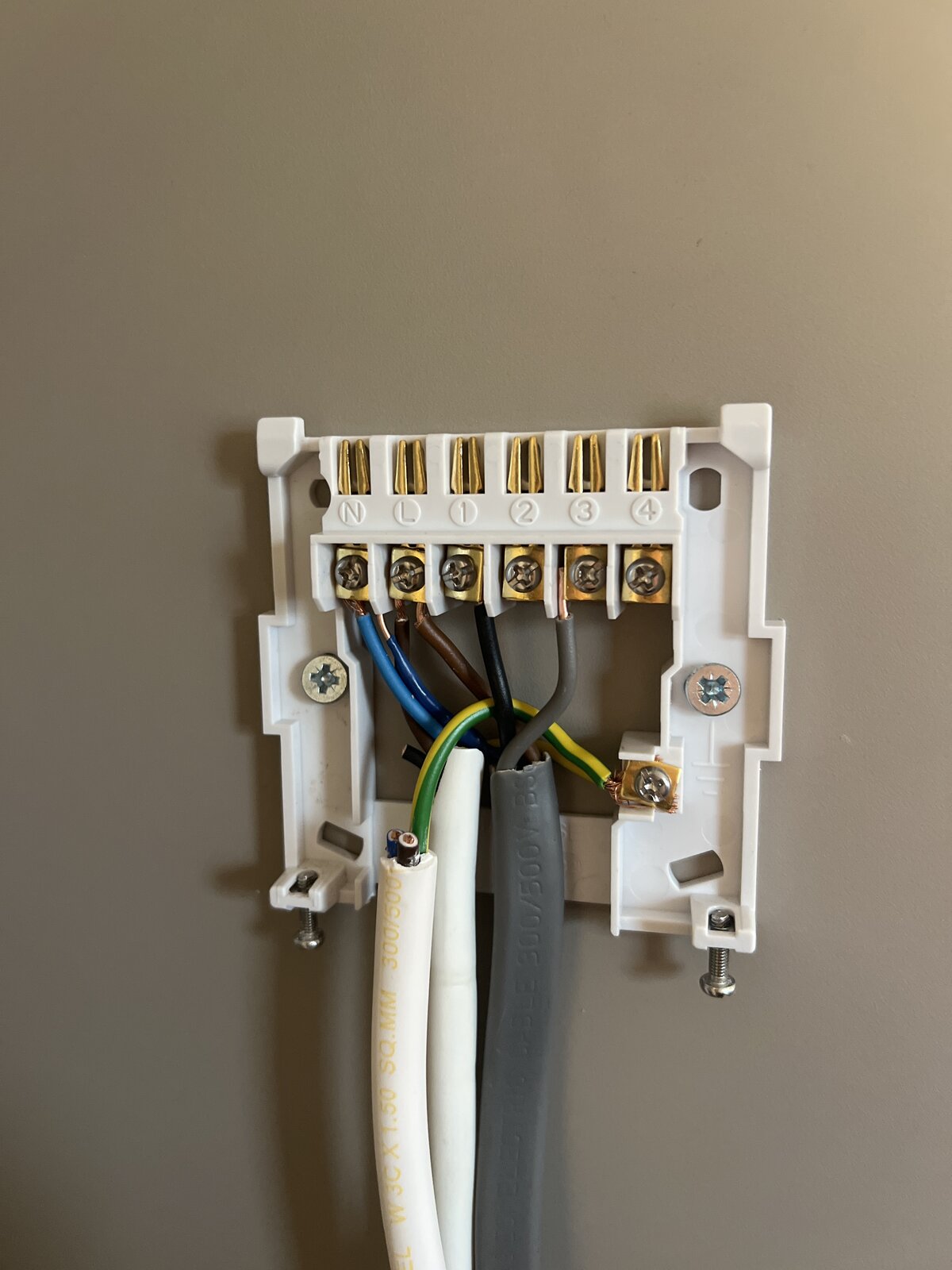

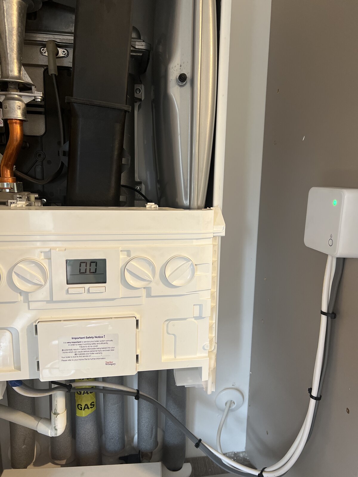

Hi. Wondering if someone can help me. I’ve wired in my Hive receiver into my boiler (glow worm easicom 28) I’ve linked the thermostat to the receiver.
The hive and the receiver are commuting as the green light on the receiver is turning on and off but nothing is firing up on the boiler?
I don’t have a Hive hub.
Any help would be great thanks !

No idea why you’ve hijacked an older thread that’s different to your setup. Anyway, have you definitely used the RT terminal at the boiler end?

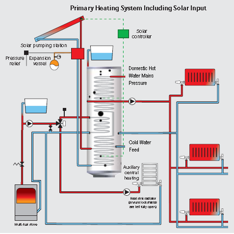

Also, one has to look at near enough engineering, if fitting a XYZ with cost the same as a tank full of oil, it will take a very long time to get one's money back, so we can look at the super systems available today Torrent pipe example.PNG but when it costs £12k to fit it, it is clearly only an option with a new home, it is not really a system one can consider for an existing home. Personally I would use PV solar panels not water type, but point is, there is a limit to how much one wants to spend on the heating system.
