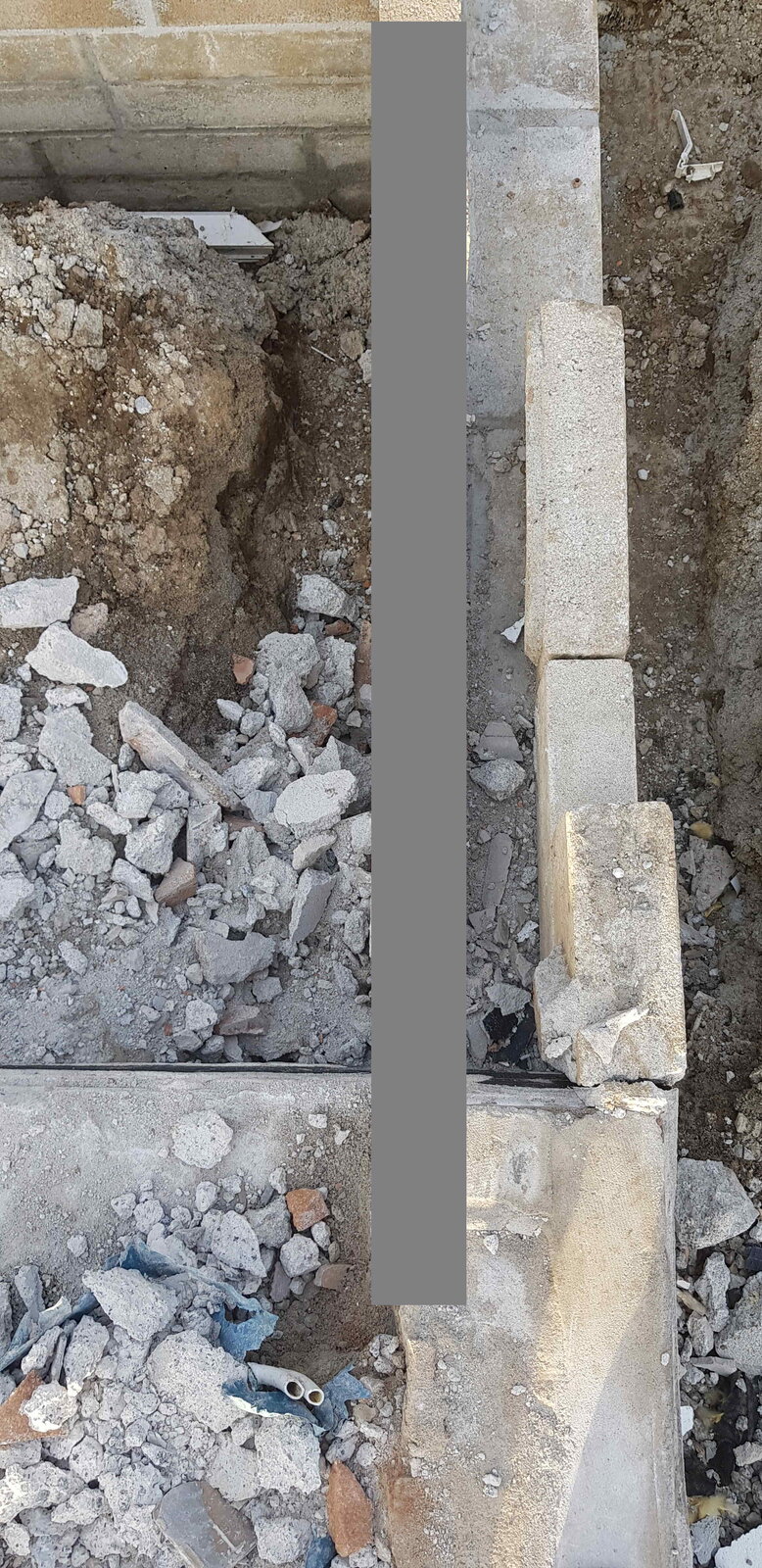

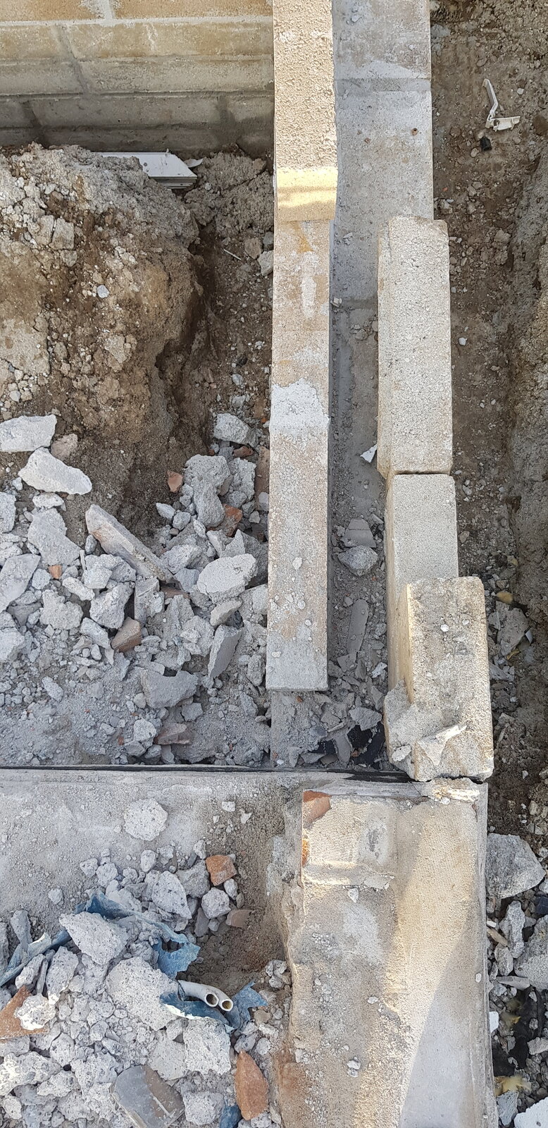

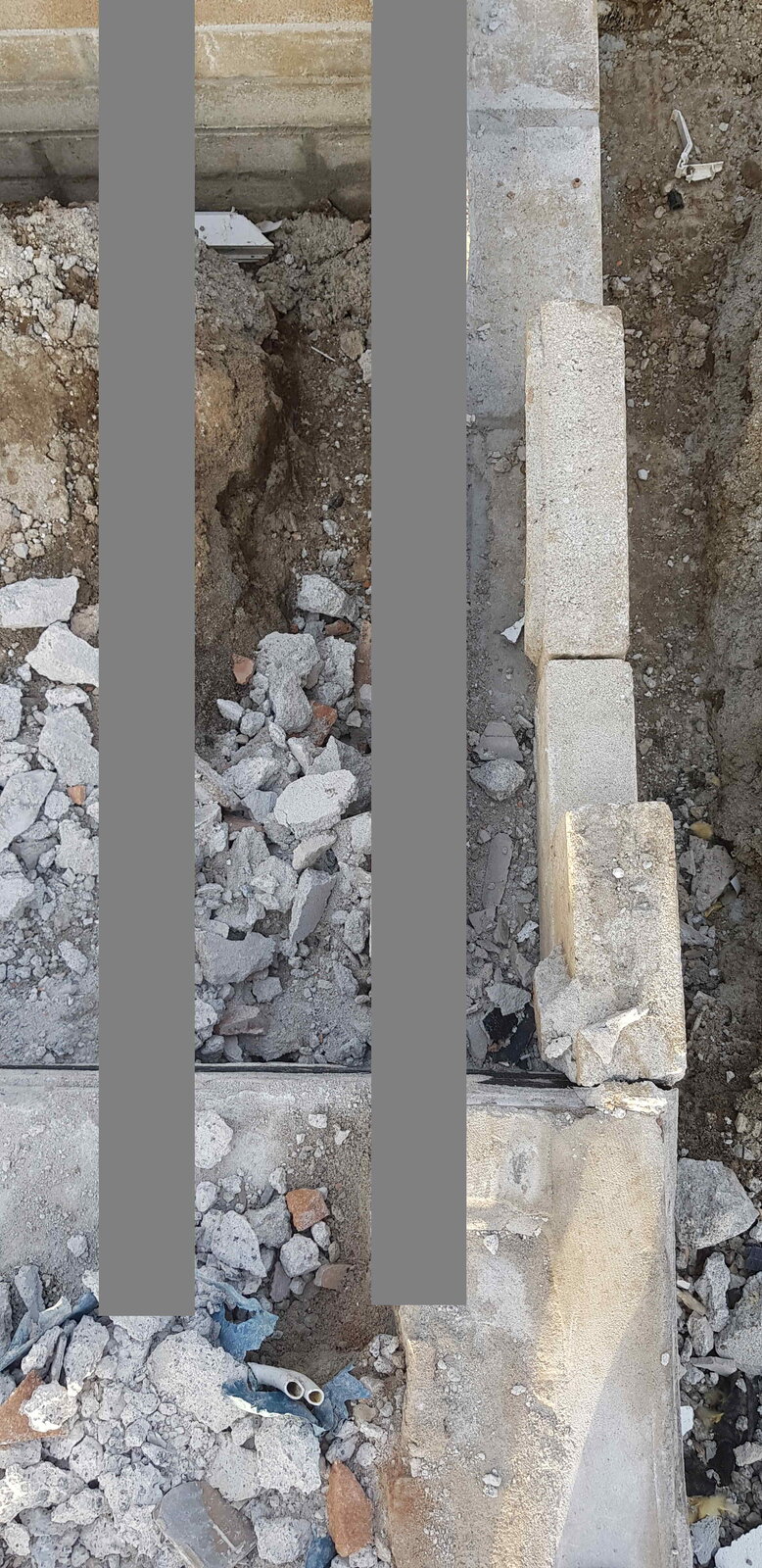

Just to double check another thing. Do you run the the first beam on top of the first course of the internal block or should this sit to the side. Ive taken a couple of pictures to show what its like currently with a illustrated image of what I mean
When parallel to the wall, the beam sits to the side of the wall, like a wooden floor joist would be, so that the wall can continue upwards.
No, run the beam alongside and lay the first block from the beam to the inner leaf if necessary. After you've prep'd and tidied up underneath of course.
