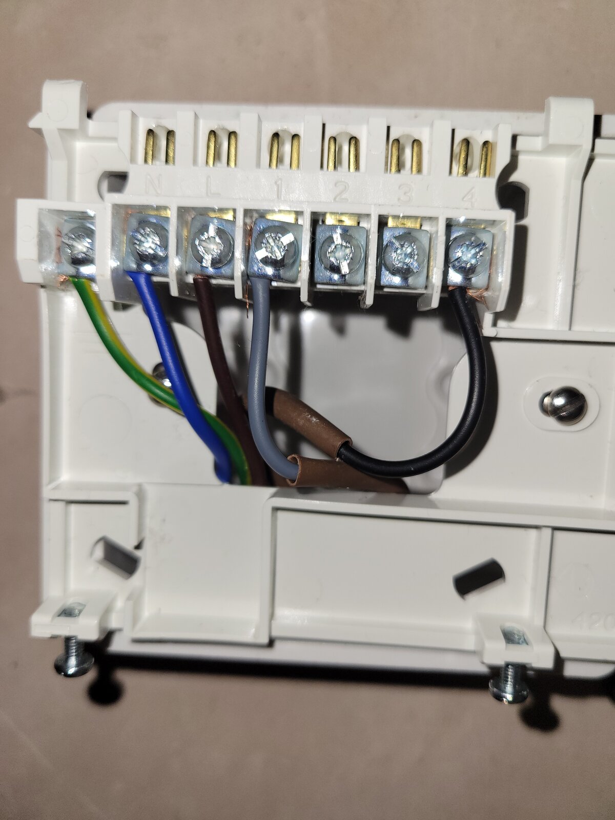

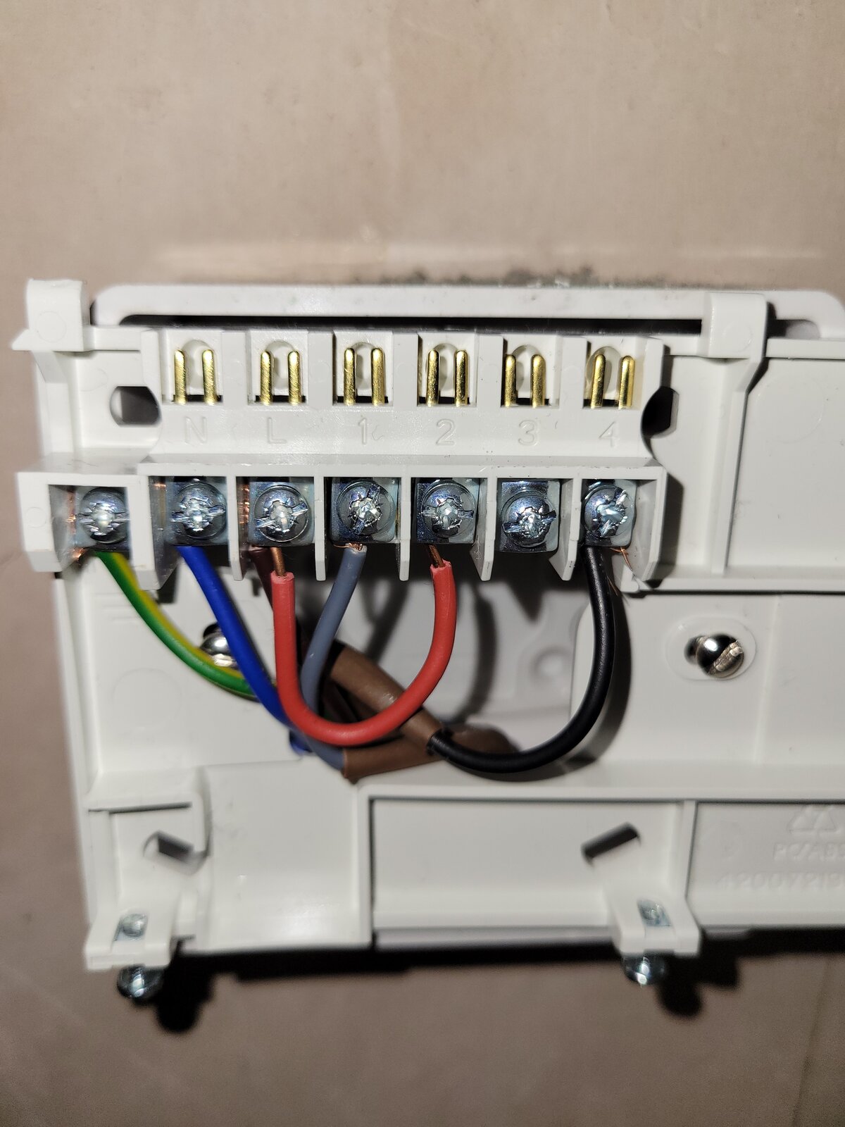

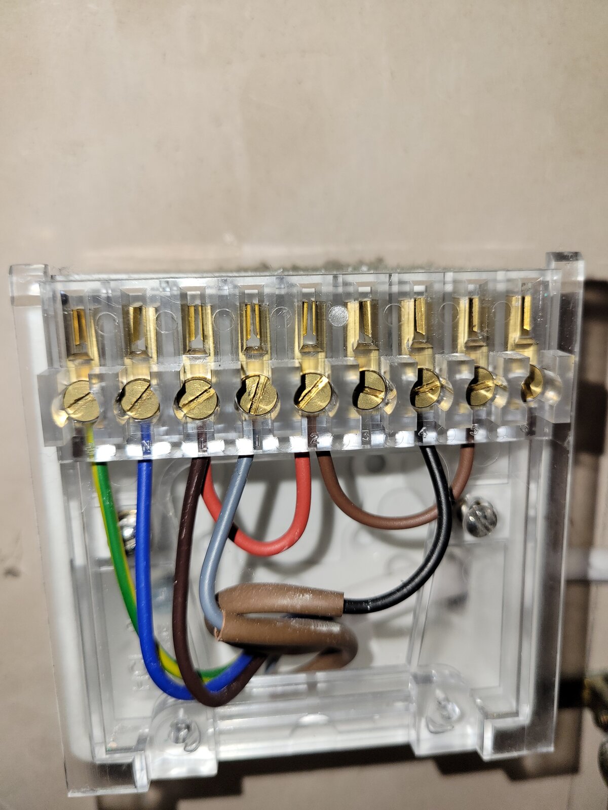

I'm replacing Programmer Horstman H27XL with a Honeywell ST9400C but having problems with the wiring as the Horstman had 9 connectors and the Honeywell has only 7.
I've attached a photo of the Horstman wiring and a photo of how I've wired in the Honeywell.
I don't think it's heating the water
The central heating works
What have I done wrong?
I have an interconnecting loop over

Is the heating still on and thermostat still calling for heat?
The heating is still on and calling for heat.
The black wire is still in 4
The black wire is securely in place.
I've just put the wiring back as I had it originally in the photo, and as before, the central heating is working but not the hot water
With the wiring as per the attached photo, the hot water heating doesn't work.
The central heating only runs if the hot water is selected to 'OFF'
