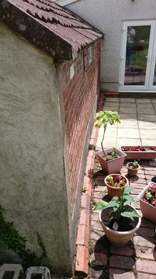

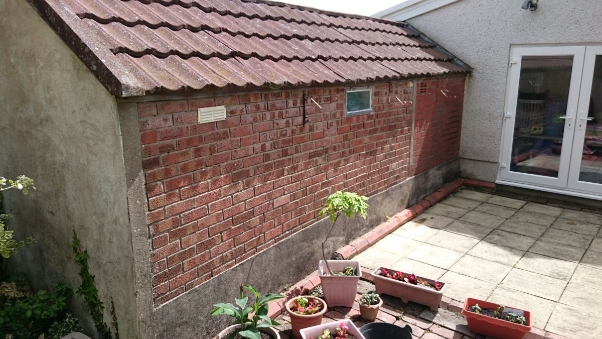

We have an old storeroom built onto the back of our house. It is of single skin construction, watertight but cold in the winter.
But the main problem is one of the walls is bowing in. Probably been like this for the 16 years years that we have lived here, but think it is now time to do something about it.
Room is roughly 5.7m by 2.5m and has what looks like metal tiles on the roof, don't know what type of foundations it has been built on.
Planning to remove the roof and take the bowed wall down and rebuild. The bowed wall is approx. 1800mm high.
Any suggestions on the best way to go about this, foundations, tying in with existing walls. etc?

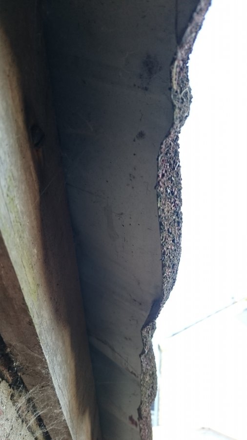

You sure they are metal tiles, i think they are concrete, could explain why the walls probably have bowed in, there is to much weight on the wall
just take the roof of, take the wall away and have a look at the foundation, it could well be that the foundation has settled and that might have cause the wall to bow. either way, your foundation needs work
The roof tiles are a thin metal formed to look like concrete tiles, don't think there is much weight in them, photo of the underside below.

I'm just thinking about this wall, should I rebuild as a single skin and perhaps build a timber frame on the inside to add extra strength to the other walls and for provision for insulation?

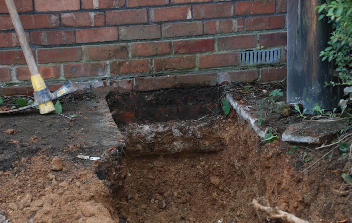

The wall seems to be bowed from the foundations up. As its an outhouse the foundations are likely to be very shallow, a couple of bricks spreading outwards from the wall. It also looks what I would call "modern", say post 1950, so it will be made with cement mortar so recovering the bricks might be impossible. Have you investigated the state of the back wall?
As an outhouse it looks fine. If you want to turn it into a habitable room, I would build a timber framed room inside the existing wall, trimming out its curve and using SS brackets to fix brick wall to timber frame.

Had a look at the foundations, goes down about 2 bricks and looks as though they have been laid on concrete, very similar to this.
Run a stringline along the wall and for about 2/3rds of its length from the house wall it is roughly straight and then seems to curve out to the corner. The wall is dead vertical at all points along its length. Beginning to think that the person who built it was slightly cockeyed.

The building has been standing there for a long time. and if as you said the builder made the curve, and you are happy with the head height, and you want to get on with to much hassle, then putting a timber frame on the inside is the quickest way. and is very acceptable
