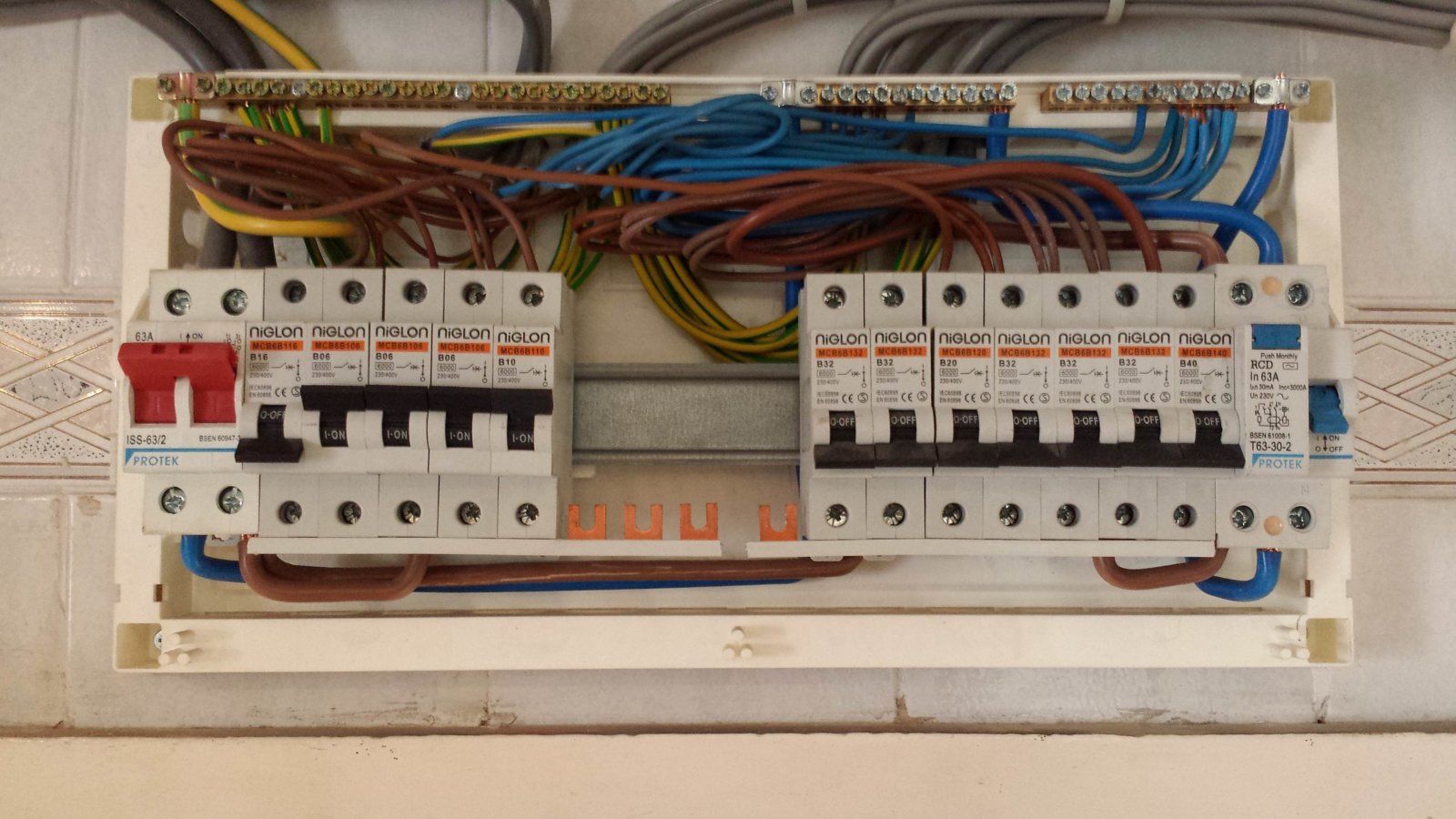

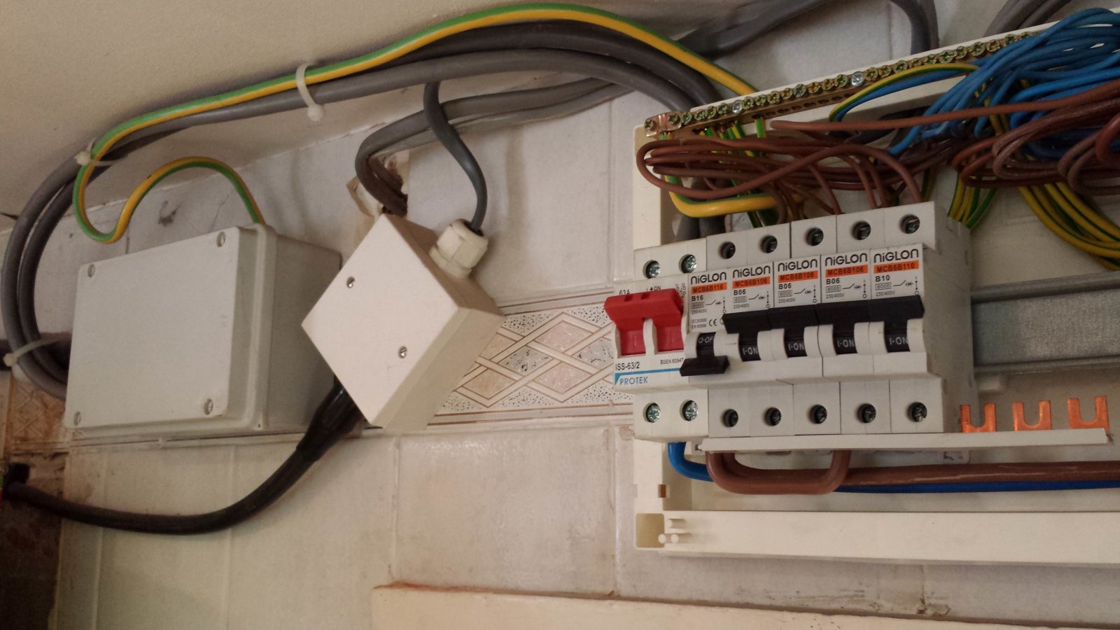

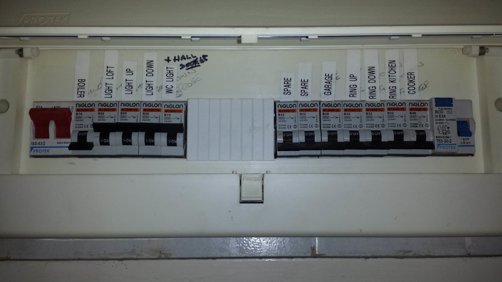

This Protek RCD (on a Protek consumer unit) recently tripped and does not work since being tripped, this British General RCD is the closest I can find online to match it, would this one be ok as a replacement?
I'm not going to try to replace it myself (for obvious safety reasons!), just trying to get the part before calling an electrician to install.
And if anyone could tell me how much I should expect to pay for labour for 1 x RCD and 1 x MCB replacement that would also be much appreciated

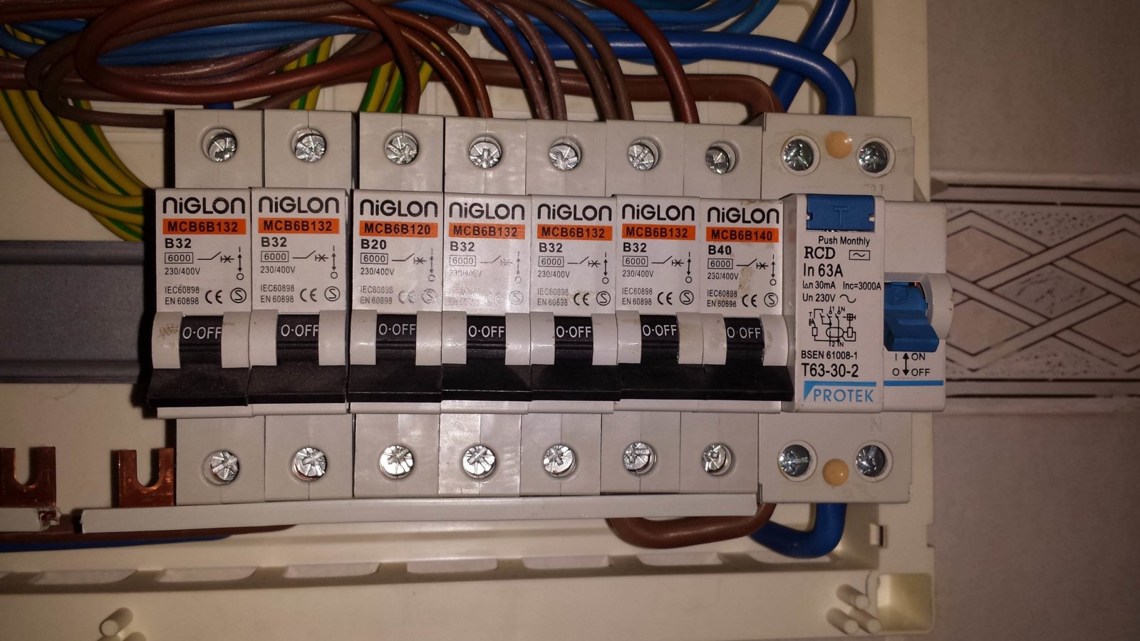

It may physically fit, although consumer units are not intended to have a mixture of different manufacturers devices in them.
Yours already does and that Protek one is probably wrong.
Niglon RCDs are available: https://www.eleconline.co.uk/zdriverel/form/catsel/NIGLON-RCDS/product/M1723

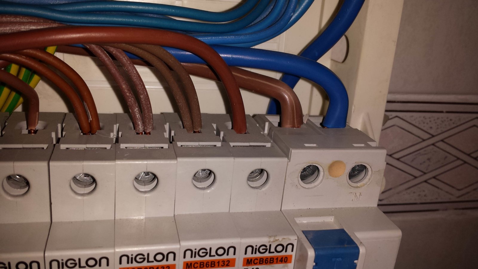

and would be a better choice, N&L are the other way round and that's probably why the short brown link wire exists to connect to the MCBs, it's spaced like that to go over the neutral wire.
I am wondering if the RCD is actually faulty. How do you know? You will not be able to reset the RCD if there is a fault on any one of the associated circuits.

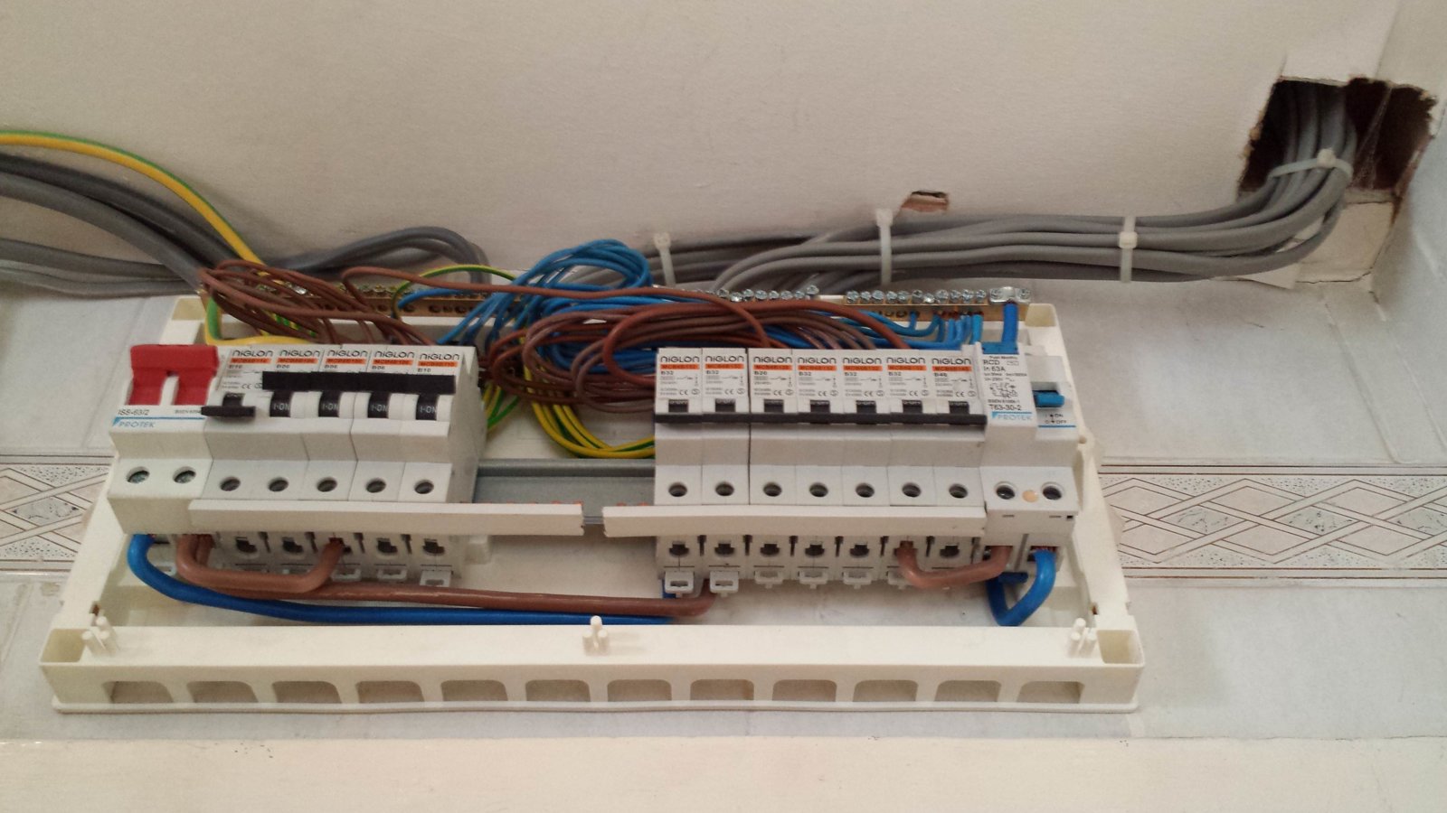

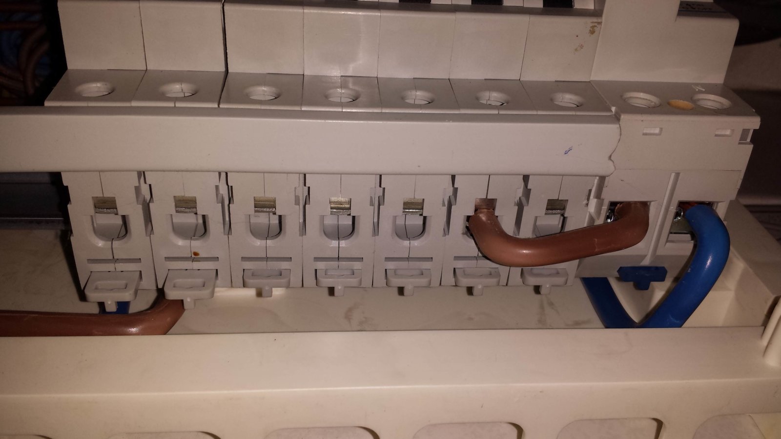

Thanks, did seem a bit strange that N&L are the other way round to most RCDs I can find online. I've added some more photos to show all connections.

As a first test. Turn off the power at the main switch - that’s the double red switch at the left hand side of the consumer unit. Make sure the power is actually off by using a proven voltage tester. Then remove both of the cables from the bottom of the RCD. Now see if the RCD will reset. If it will then you gave a fault with your installation, not the RCD.
Note: you MUST check the power is actually isolated. If you don’t know how to do this, then get a competent electrician to sort this out for you.
Please report back your findings.

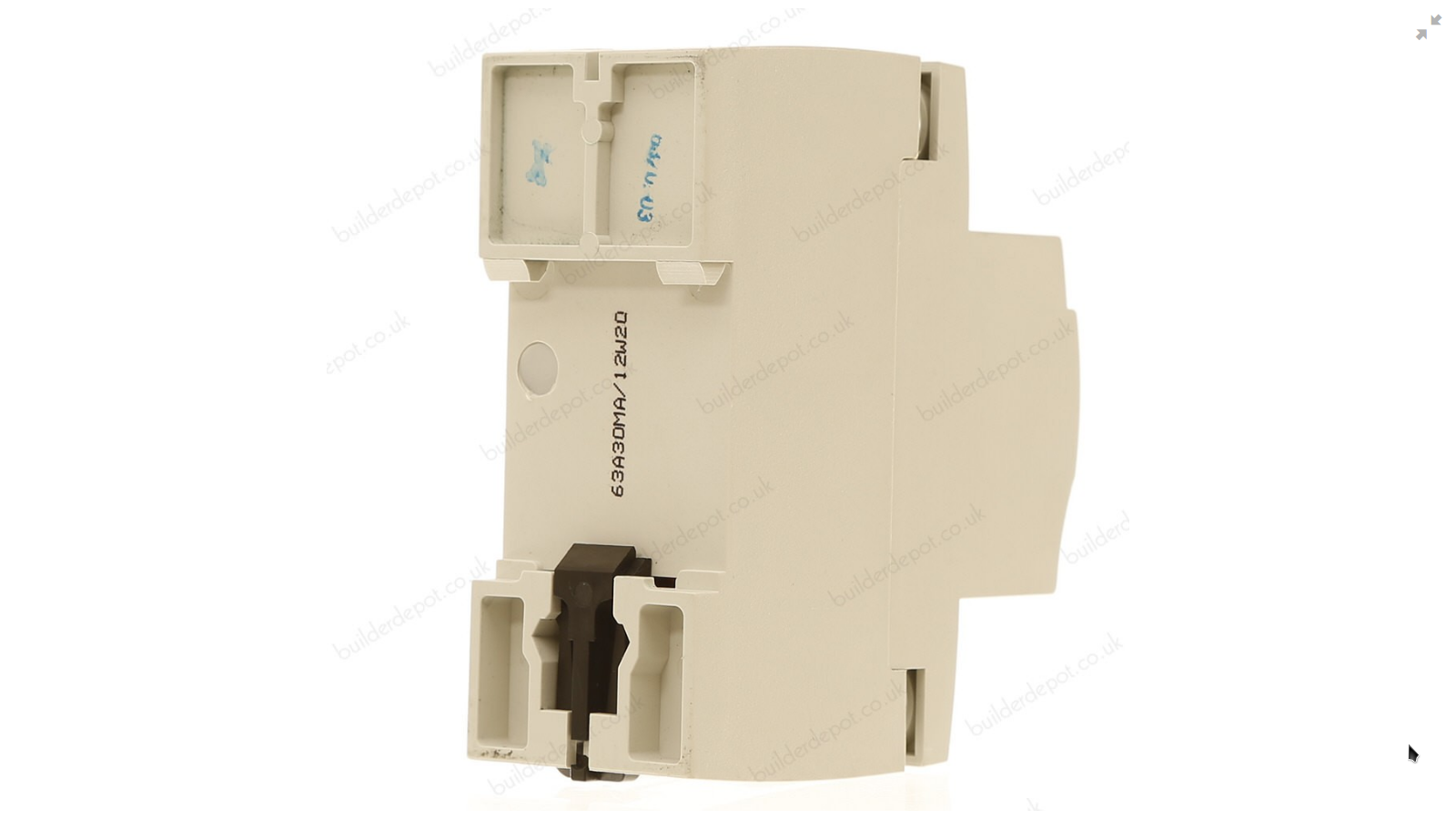

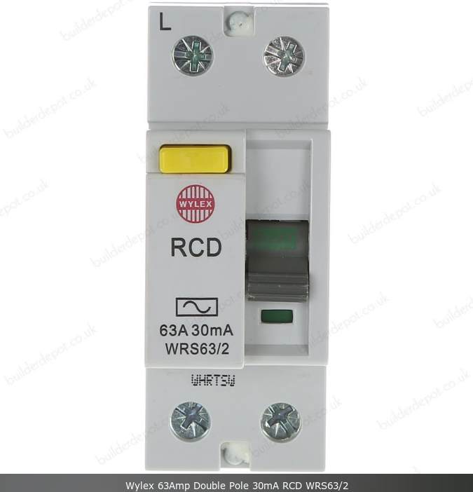

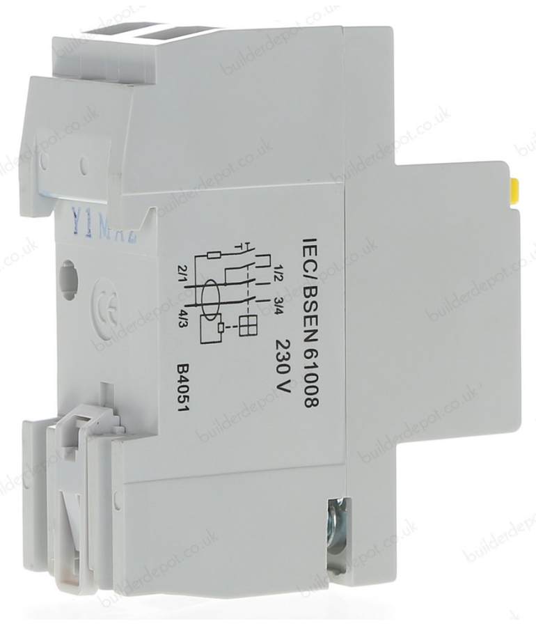

If so is this Wylex RCD I've found ok as a replacement? It says 'DIN rail mounted', seems to have the same N&L configuration as the one that needs replacing, and from reviews the Wylex seems to be better quality than the BG one I found earlier:
http://www.builderdepot.co.uk/wylex-63amp-double-pole-30ma-rcd-wrs63-2.html
The answer is, even if you end up needing a new RCD, you need one to match the MCBs. ie a NIGLON RCD. (Edit. I just noticed that the CU is Protek and its therefore all of the MCBs that are wrong! But that won't cuase your problem. Lets try and keep it to one type, rather ythan add Wylex and making it three.
But I digress, as you most likely do not need a replacement RCD>
All RCDs of that type are "DIN rail mounting", thats what they do.
