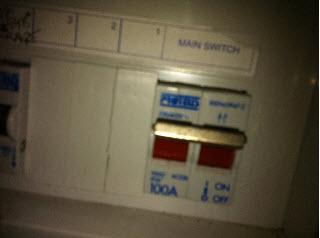

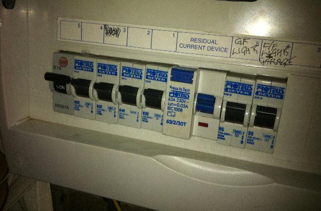

I'm after some advice I'm looking to replace a 9Kw shower with a 10.5kW and was just interested to what would be involved prior to getting someone in . As it stands showeer is in a cubicle but I'm replacing the bathroom and want to move and upgrade the shower over the bath . Currently the shower is a redring 9kw connected with 6mm2 cable to a protues 40A mcb in protues consumner with RCD. What would lik to know is is it possible to replace the existing 40A mcb with a 50Amp and upgrade the cable to 10mm . Cable run is up the wall cavity , across loft wall and then into bathroom ceiling (approx 10m inlength ) . Ive looked on the protues web and cant see a 50Amp mcb for that box is there other OEM equivalent ? [

Don't know what MCB's are available for that consumer unit but that's not the only consideration. A house supply can be anywhere between 60 and 100 amp and in the main there is little to say which you have as all the fuses fit into same holder.

However when the electrician comes he will advice as to what is required. There are many ways around the problem including a mini consumer unit just for the shower.

50A MCBs are available for that board.
However the total loading has to be considered also, and as the RCD is only a 63A type, putting a 50A circuit in there with those other unidentified ones may not be desirable or possible.
