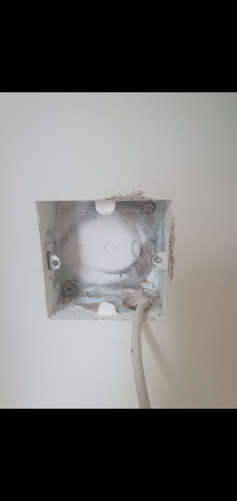

Background: My flat (victorian conversion) was refurbished 4 years ago. They routed an RF/Coax cable from the lounge to the kitchen so I could watch Sky through a TV Link while cooking (same channel in both without delay).
I've just "upgraded" to Sky Q, stupidly not realising this no longer works. So I've bought and HDMI splitter and a 15m HDMI cable - all works fine. BUT I now have to figure out a tidy way to pull the cable through.

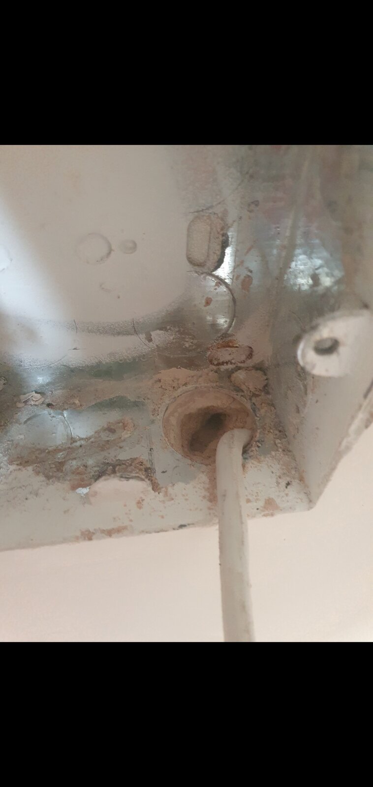

I wanted to use the existing routing to remove the current coax and replace with HDMI (or Cat6 Ethernet to do HDMI through that). BUT, at the kitchen end it's been pretty solidly been fixed in with mortar/cement (I think). I've drilled/chiselled away what I can, but still can't get it "free" and am in danger of splitting it (photos attached).
Appreciate I'm sort of asking the impossible, but can anyone think of a way I might be able to loosen it?!

If it's solid plaster I should think you'll have to chisel out a slot I'm afraid.
Hacking at the walls with subsequent replastering and redecoration.
Or pay for a Sky Q Mini box in the kitchen.
Thanks. Alas, tried the Mini box but hadn't factored in the delay in picture/sound. The rooms are open to each other (just I can't see the tv) but can hear the mismatch between the rooms so doesn't work.
Alas it's common (time is money, and doing it right costs time) when using conduit to stop the conduit short of the back-box and not even bother lining it up with the hole. So the cable is a) dog-legged into the box and b) fixed in plaster. It might be that hacking out a little bit of plaster will reveal the end of the conduit (if they used it) and you can replace the cable - if not then you are looking at chasing out and making good afterwards.
I think you might struggle to get an HDMI cable through the same conduit. You might be better with an HDMI over Cat5e/Cat6 extender so you can use a couple of Cat5e/6 cables instead of HDMI.
As an alternative (if you can't get the cables in), there are devices that will send an HDMI signal over a single coax cable - but I've never used one so can't comment on how well they might work.
Thanks Simon, that looks to be the case to the letter! I've done some more hacking, no joy. Reluctant to hack around it given I don't really know what I'm doing and no guarantee it will actually result in success.
