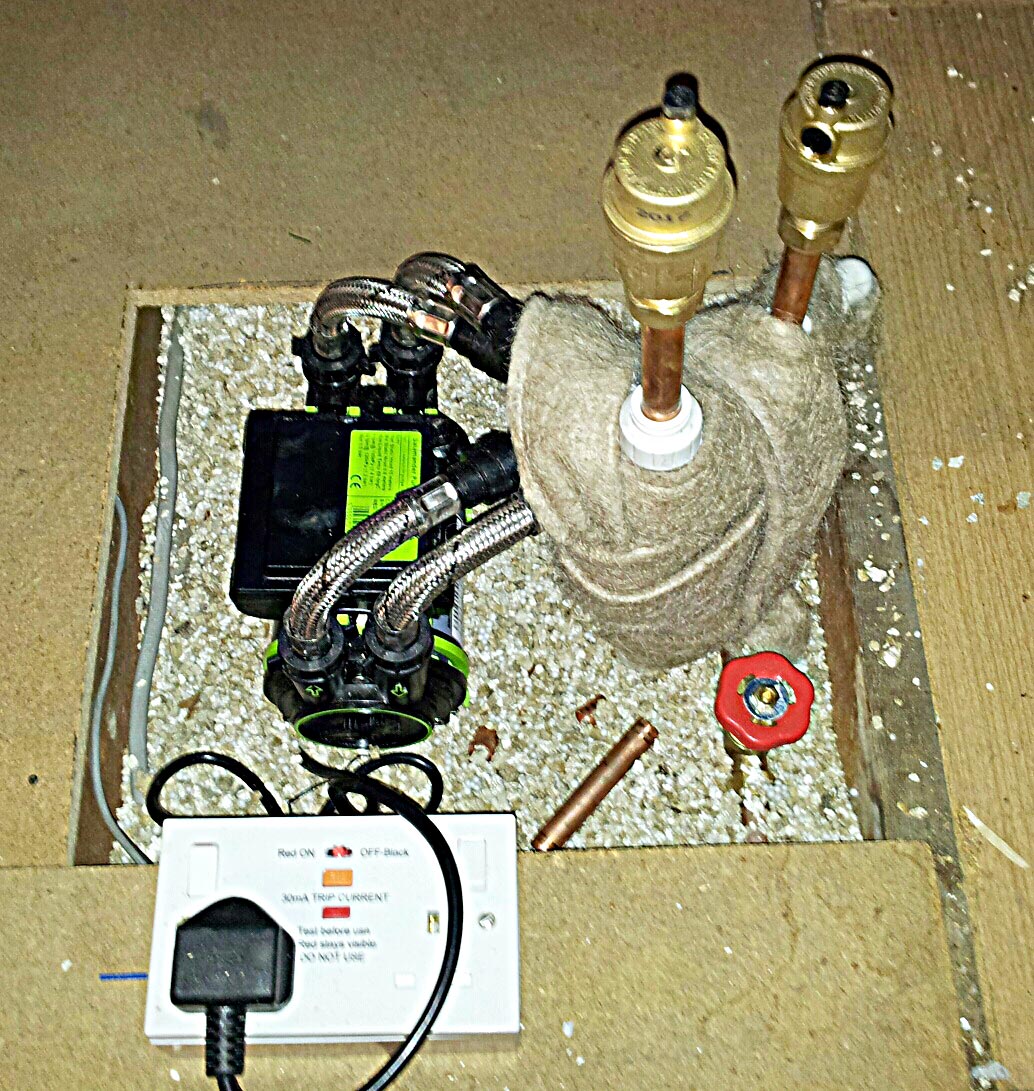

Spot the errors:
The flexies aren't supposed to be bent
It's resting on vermiculite which will jiggle out from underneath
They put AAVs on the inlet, and left them open so they sucked air
they put that trip in the LOFT with a 90 yr old user
they connected the socket to the ancient lighting circuit
they didn't connect any earth (until later, down in the airing cupd where they should have put the pump and electrics..)
they left the ONE gate valve jammed wide open
if/when it leaks, there's nowhere to turn the water off
they connected too far from the cylinder
they connected with inadequate head from the cistern
they have air-traps in the pipes
The frost protection is plain silly. I looked around for a box to put over the lot (it's a draughty loft) and found the junk they'd thrown aside
They wanted an extra £66 to connect an earth. They didn't get it.
They left mud all over the loft ladder and didn't mention that one of the rungs' rivets had broken so the tread collapsed when you stepped on it.
At every turn they tried to lie their way out with lame excuses.
Scum.

The flexies aren't supposed to be bent - No they shouldn't
It's resting on vermiculite which will jiggle out from underneath - Yep fair point
They put AAVs on the inlet, and left them open so they sucked air - The bottle vent caps need to be open to release captured air and they shouldn't suck air in by design so that's not an issue, more though that they can and do leak after a time so manual air vents may have been better
they put that trip in the LOFT with a 90 yr old user - yep, not very good practice but not really an outright fail
they connected the socket to the ancient lighting circuit - no - really should be plugged into the ring circuit or have it's own circuit and certainly not run off a 6A supply.
they didn't connect any earth (until later, down in the airing cupd where they should have put the pump and electrics..) - Yup - is there any other pipe cross bonding in the house?
they left the ONE gate valve jammed wide open - Again not good practice - if/when it leaks, there's nowhere to turn the water off - no HW cylinder supply isolation valve in same cupboard where the cylinder lives?
they connected too far from the cylinder - if it has a good supply and the pump's being fed then it should be ok but shouldn't be over 5m in pipe length away
they connected with inadequate head from the cistern - again if it has an adequate supply and the pump's being fed then it should be OK
they have air-traps in the pipes - Where? Are there pipes in the run(s) that are rising up above the pump/cylinder/cistern that don't have bleed points?
The frost protection is plain silly. I looked around for a box to put over the lot (it's a draughty loft) and found the junk they'd thrown aside - Fair point but not really a fail
They wanted an extra £66 to connect an earth. They didn't get it. - as above, out of interest are the pipes cross bonded anywhere else in the house?
They left mud all over the loft ladder and didn't mention that one of the rungs' rivets had broken so the tread collapsed when you stepped on it. bad customer service and dangerous practice
Overall install isn't too clever and could be better thought out for sure and if there was space in the area of the cylinder then that's where is should have gone
Not looking to excuse any of the installers bad practices, which there are a few but I do have to say that the install isn't an all out fail and pumps installed in attic spaces away from the supplies can and do work quite happily as long as supplies and flow are adequate. Where it utterly fails is that specific install isn't covered by the manufacturers warranty by any stretch of the imagination as it doesn't follow their MI's and therefore warranty calls will not be honoured.
We agree then, pretty much :)

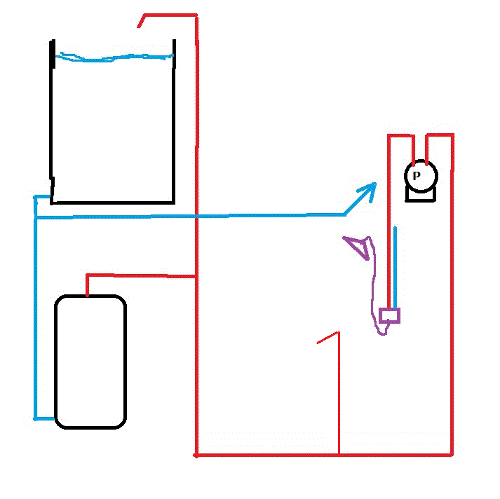

It's over 10m pipe length. The hot pipe goes down from the cylinder to below the floorboards, 5m under a bedroom, 2m under the bathroom to where the bath taps were, then 2m under where the bath was, then UP the stud wall 2.5m to the pump, which is where the air trap is.
The original guessed layout was about right, though the horiz distance is more. Blue (cold) pipe connected - at the pump..
I'm interpreting the rising part far right as an "air trap". If enough air gets stuck in there the pump spins in air. I tried opening the basin tap, which it doesn't suck from, thankfully. Weedy pump!
Pump is on the loft floor - or rather the plasterboard of the bathroom ceiling. The pipes above the pump are a few inches from the level of the water in the cistern, assuming it doesn't drop. The MI say 600mm below the base of the cistern, so it's about 1m too high. It's not a neg head pump, and it's operating on a few inches head - unless you add the "pull" from the shower head which would be less than a metre below where the pump is.
