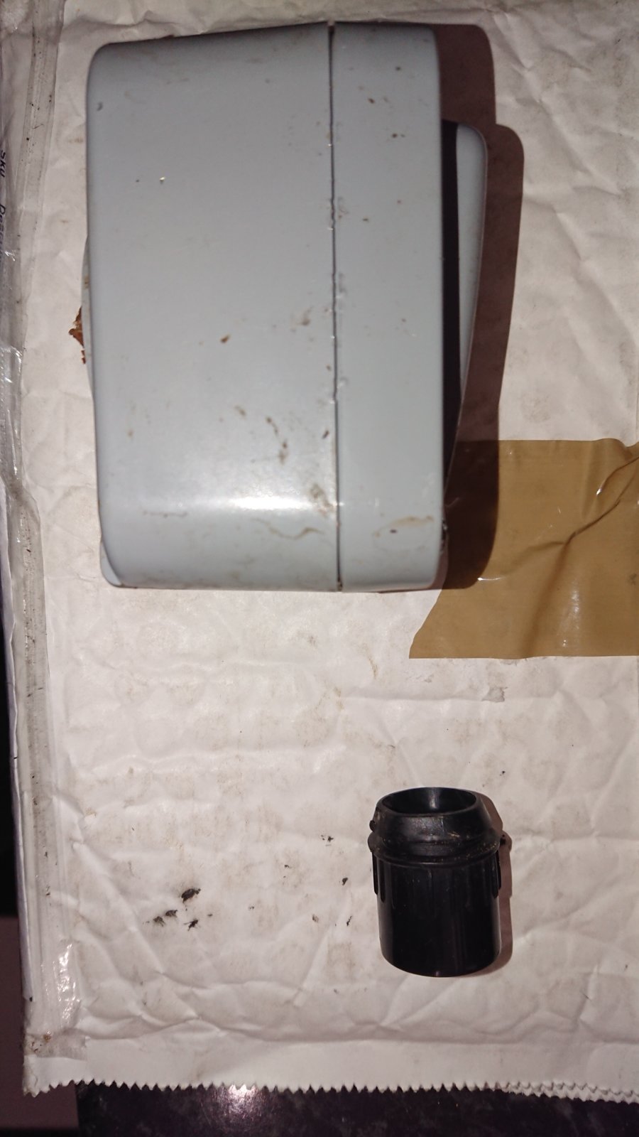

Hello
I have an outside light run in T&E in black plastic conduit. The switch stopped working and the RCD was nusiance tripping.
On opening the switch I found it was full of water. The switch is a BG slimline IP67. The conduit enters through the top using a black push fit gland and I think water is leaking into the switch through the gland.
Have you seen these glands? Are they suitable and when I refit the new switch how should I prevent water ingress? Should I be gluing the gland on, to seal it? It was just pushed on. Otherwise I could replace with a traditional compression gland.

Are you sure the waters not coming down INSIDE the pipe, top entry is always best avoided if possible,
The switch is likely to need a drain hole at the bottom. Water vapour condenses in the switch housing and this draws in more vapour through the conduit of there is a warm moist atmosphere at the other end of the conduit.
Click HERE
2. Where conduit is used for cable runs, water condensation MUST be prevented from collecting inside the unit & conduit. Drain holes MUST be drilled out (see Installation Instructions)
I don't think this was condensation, the box was literally full of water. Pic of the switch and gland below. I can't seem to find anything like it at Screwfix. Is that a recognised type of gland for external use? It pushes onto the conduit and into the box.
Drilling a weep hole is a good idea. I still want to stop water getting in in the first place!

looks like cheap crap!
Use copious amounts of silicone sealant when refitting :)
That's not a gland, it's a simple conduit terminator to permit a conduit to connect to an enclosure
Supposedly, but just being shoved into the hole it is inevitable that it will leak.
This is far better: https://www.toolstation.com/shop/p53577
with either solvent cement or superglue to permanently seal it to the conduit and the box.
That's not a gland either. Without a sealing washer water will seep past the threads and unless the conduit is weld sealed into it water will seep into the enclosure.
