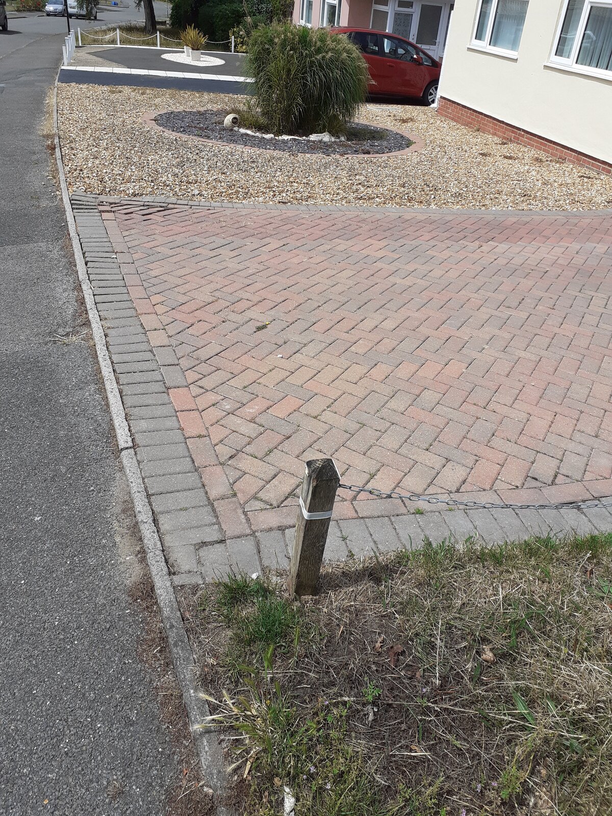

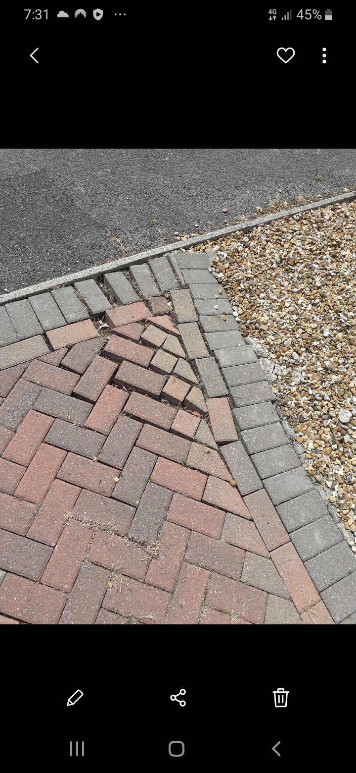

How do I get this block paving back into position? It seems to have been pushed out of the edge as well. Not driving on it just walking so need a cheap fix

Take out the damaged area, reseat the edging in cement, remove the (probably) sand under the red blocks, lay a new bed of sand, relay blocks and tamp level. Easy job.

Thanks. Replace the sand with the really fine sand they use on block paving (not builders sand) then hammer down with sledge hammer with towel wrapped around it to not shatter blocks I guess. I guess couple of hours work

What sand would you use under the blocks after I've removed the old sand? I guess the mortar for edging stones needs to be only slightly damp
I'll get a rubber mallet

Read the info on the link!! Oh and don't hit the blocks with a sledgehammer FFS.

That needs relaying by someone competent who can achieve an invisible repair. It's quite hard to judge how much the sharp sand will compress to get the blocks at the same level - might be better to bed on some semi-dry sharp sand and cement, especially as I presume you don't have a whacker. To stop it happening again it needs restraining with a suitable edging.
