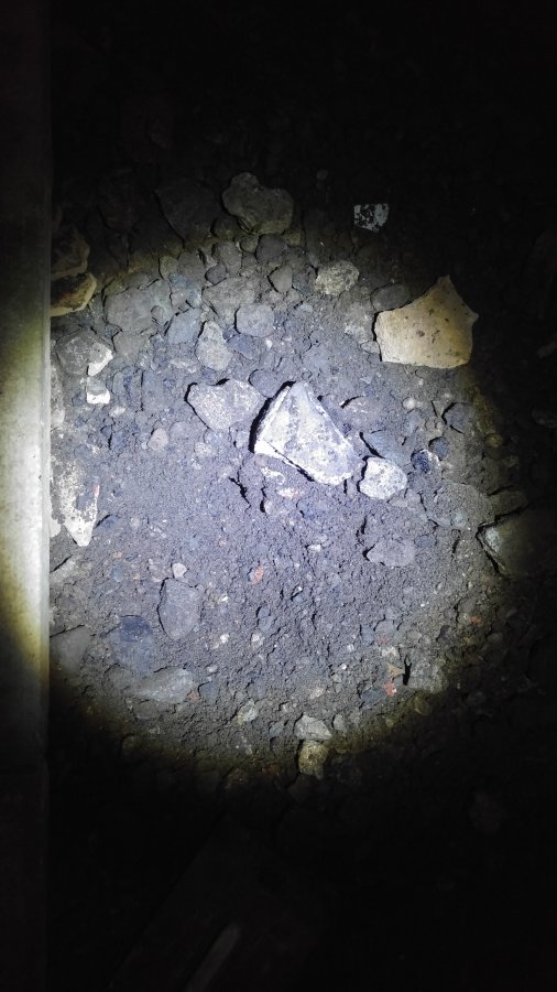

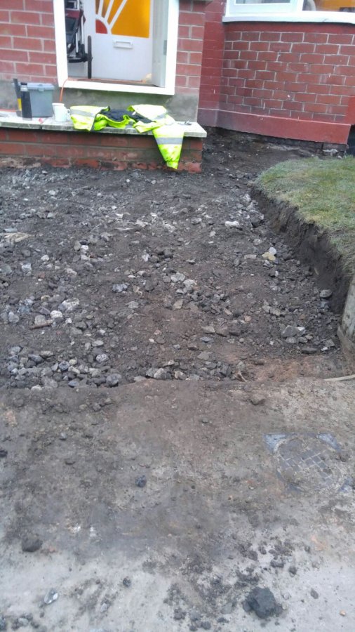

We're having our path and drive block paved so we can park on it they have dug out and put down the MOT TYPE 1. It doesn't look how I thought it would .
It seems like recycled from a building site there are some large chunks of concrete and brick it seems .
Hope these photos are ok

Looks about right, the grading is mainly about the ratios of different sizes. The idea is if it's mixed well, the largest pieces will be locked together for a firm base, but when compacted there won't be any voids.

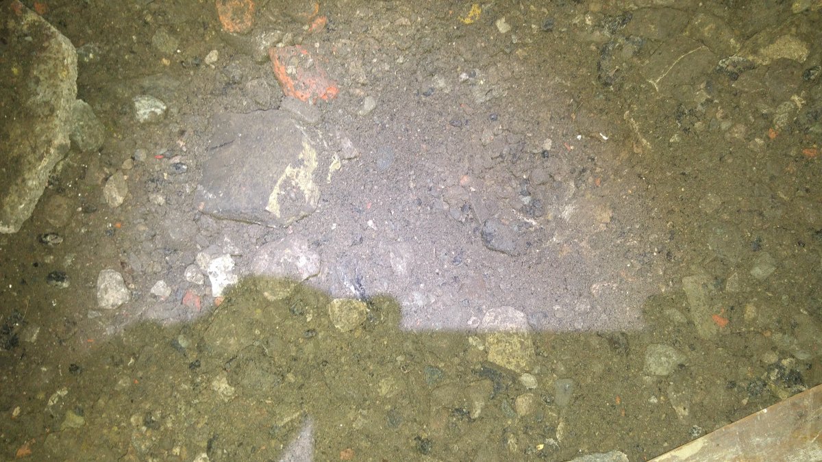

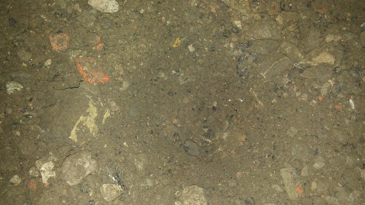

Here are some more photos, and more importantly one from the day time
Yeah I was expecting more of what is in your link.
This looks like it's come from a building site, maybe crushed a bit, but not what you see on the sites selling it.
Should I be concerned about this going under block paving to be parked upon?
Should I get him to dig it up and put some proper stuff down?

No expert but would think the variety of size in it would make it difficult to compact and for block paving you need a very stable base.
Looking at the photos now it does seem lacking in medium sized particles. We bought from wickes and it was all brand new stone, and was rock solid when compacted. Looking around at other people's drives, perhaps they used cheaper stuff with the wrong ratios. Agreed if you were promised proper type 1 then send it back.
Yeah looks like crushed building rubble but that said it will be fine, once compacted. The guy I get most of my aggregates from sells loads of it we use it all the time and it is less than half the price of fresh quarried. Only a couple of times have we refused it as it sometimes has soil like fines in it. As John said previously the grade refers to the mixture of sizes in the mix 40mm to fines in specified ratios, the actual material in it has no bearing on the grade and could be fresh quarried stone, concrete, shale, slag etc.
You have there what looks like crush and run which is graded through a different sized sieve and generally not carefully mixed to specified ratios. It is generally softer with less solids and is fine for anything that isn't going to carry vehicular traffic, we pay about £10-15/ tonne for that

I popped along to J Hopkins (Contractors) Ltd in Trafford Park, where they got the stone from.
The Quality Engineer took me over to look at the Type 1 they sell. Really nice and friendly guy.
The result was, they have "slipped up" (or slipped in) some of the soil and rocks as that they dug out, prior to putting down the first level of Type 1.
I told them to take out the large bits, which they did.
And the second layer, which they went out to buy looked a lot better when it had gone down.
So all Ok in the end
