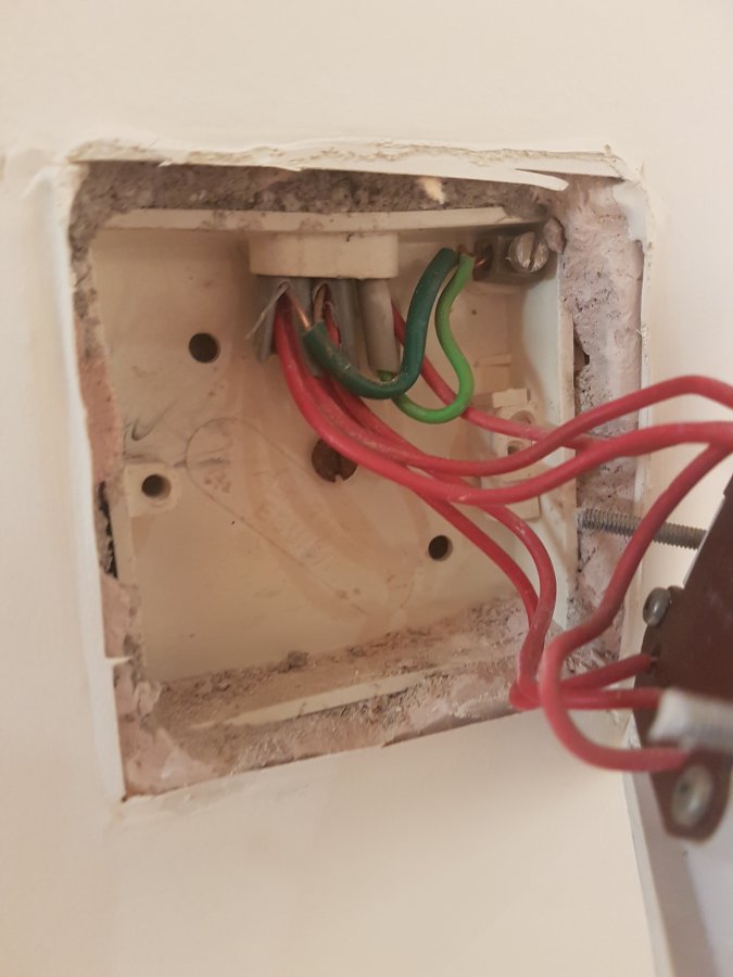

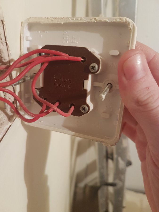

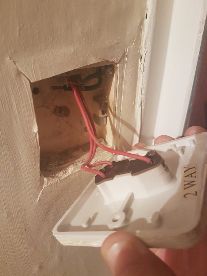

I am a first time home buyer and looking to put a time lag switch on my downstairs hallway light.
The light has two switches. One at the door and one at the foot of the stairs.
The foot of the stairs switch is a 2 gang that controls the light at the top and the light at the bottom of the stairs.
I would like to replace the door switch with the time lag. But cant find instructions on how to do this.
Could anyone help me with instructions please? I have included a picture of the wiring. It only seems there are red and green wires, although the green doesnt seem to be attached to anything.

Hi, you will require 2x mechanical time lag switches or one electronic one with a slave. You're existing wiring will be fine with either option.
Try TLC Electrical.
The green wire an earth and is only required if the box and or, switch are metal.
If not required put it in a connector block.
Regards,
DS
The green should be in the back box connector - but it is just a park to keep it secure.
Did you mean a time lag so that the hall light only ever stays on for the set time, or
a time lag so that it stays on for a short while when you switch off and go out?
It' is tricky to fit a timer to a two way circuit as it needs to work in conjunction with the other switch. The three red wires are live switching wires and will be connected to terminals marked 'Com' '1 Way' and '2 Way'
I don't understand what you mean by "replace it with the time lag" do you already have another product you wish to fit?
The green / yellow wire is an earth it's there in case a metal back box, or a metal light switch that requires an earth connection was fitted. As yours are insulated, it's not used at the moment.
You could wire the switch to a relay with a delay timer built in, but it's not straight forward and you would need to be electrically competent to do it. If you just want the light to stay on for a while while you leave or come in, then a PIR sensor with an adjustable timer could be used, but either of the latter two suggestions would require you to run additional wires as there is not a neutral available at the switch.
You can buy switches with a mechanical time delay that wouldn't need extra wires but the disadvantage here is that the light would either delay switching 'on' or delay switching 'off' dependent upon the position of the other light switch upstairs.
Alternatively you could wire a mechanical switch that went directly to the light in addition to the existing two switches. Press the button, and the light comes of for the preset time only regardless of the other switches.
If you simply replace one or both switches with time lag ( Timed ON ) switches you run the risk of the lamp coming back ON after the time lag if someone presses the time lag switch when the lamp is alread ON and then staying ON. Not good if the lamp was ON and the time delay was pressed to turn it OFF when you were going out for evening. The lamp would come ON after the time lag and stay ON until you came home.
Keep the two as it is and add a third switch, the time lag switch, that when pressed always turn the lamp ON for the timed period. After the timed period the lamp will be as it was, ON or OFF , before the time lag switch was pressed.
Buy one of those and fit it to the wall next to the existing switch.
Connect its two terminals it to the two adjacent terminals at the bottom of the existing switch.
When the button is pressed the light will come on until the button pops out, irrespective of the settings of the other switches. I.e. while this button is active you can't turn the light off using the other switches. When the button is not active the other switches work exactly as they do now.
(I think this works for all "sensible" ways that your existing wiring could have been done; maybe others can confirm?)

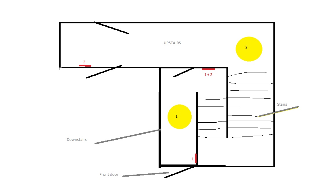

Hi guys,
Thanks for the replies again.
Ive tried to draw a diagram on paint to explain to you the switch system and explained it below.

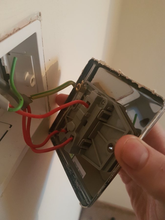

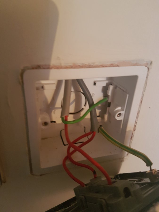

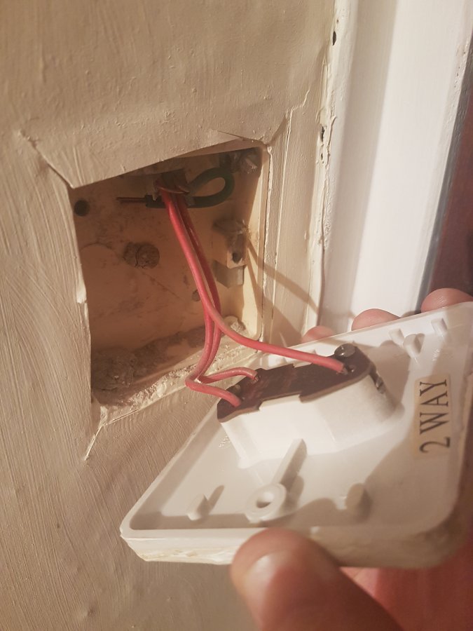

Downstairs I have two switches controlling light 1.
These are switch 1 which is by the front door.
And switch 1+2 which is in the centre of the house at the foot of the stairs.
Switch 1+2 Controls Light 1 downstairs and Light 2 upstairs.
Switch 2 controls Light 2.
I am looking to disconnect Switch 1+ 2 from switch 1. I would like to change switch 1 from a regular 1 gang switch to a time lag switch. This is because all of the lights in the house get left on at night and i dont want that. The time Lag switch turns itself off after ten minutes.
I would like switch 1 + 2 to only control Light 2. I would like to add a time lag switch to switch 1+2 and switch 2, so they can both control light 2 but it turns off automatically after ten minutes.
Is this possible, Could you please explain how to do it? Ive included pictures of every switch for you also.
