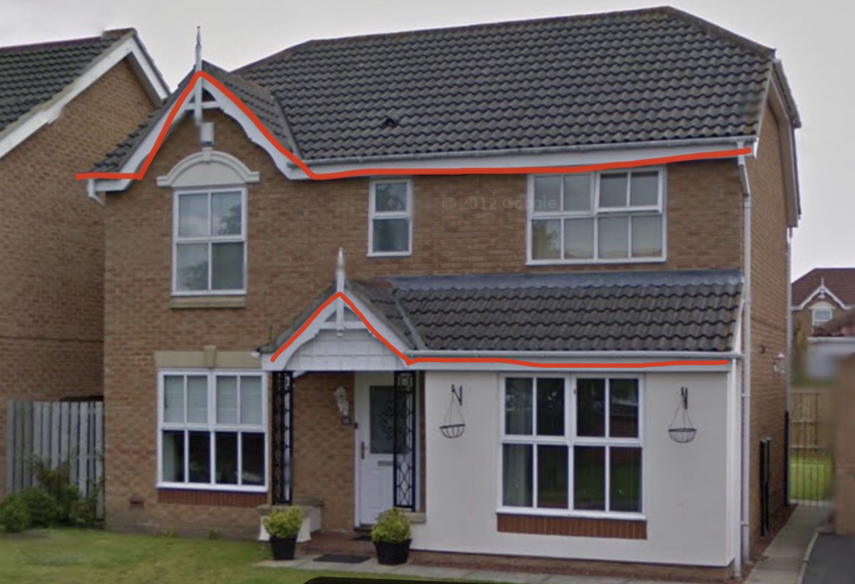

(I know this isn’t exactly an electrics query, but it didn’t seem to fit anywhere else!)
So the missus has stipulated that she wants lights on the outside of the house this Xmas. Will want to put lights (probably icicle lights) along the parts marked in red below:
So, few questions:
Obviously they only come in certain lengths, and I’m assuming too long is better then too short, so what happens to the excess length. Being lights, they’re not easy to hide
I’m assuming it will be best if the lower part is a separate string of lights?
Any recommendations on where to get lights? Have bought several sets over the years, but they never seem to last more than a year.
Cheers all!

Any excess cable can be doubled over, if you plan this well the amount of lights shouldn't look too uneven.

Yes, separate sets for the two red lines. If the length isn't too much then you can lose a little at each hook.
You can cut most sets these days as they tend to be in sections - each section being series connected LEDs, and the sections in parallel. What you cut off won't be usable for anything else in practice. With a little care, you could probably cut one or more sections from one set (take them from the supply end) and insert them into another set - I think a lot of sets tend to use the same supply/effects generator for multiple lengths of set but you could only tell that after buying (or opening the packs on the shelf) and looking at the PSUs. And it shouldn't need saying, but the PSU (and possibly in-line affects unit) need to be indoors.
