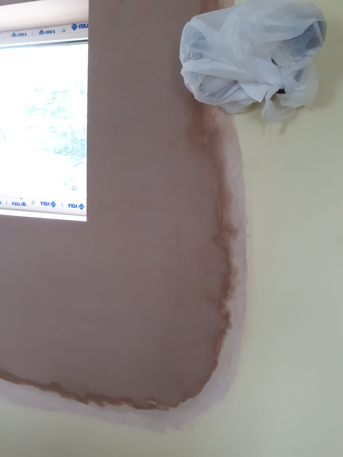

I've just had a window fitted & subsequently plastered.
The plaster said I should PVA the edge of the new plaster where it meets the old.
All I read is NOT to PVA, I would like to hear views from others.

As a professional decorator, I would say steer clear of PVA. Simply dilute the emulsion as per the "new plaster" instructions.
PVA is a mare when it comes to painting. The moisture in the paint re-emulsifies the PVA and can potentially cause problems.
The job I am currently doing had new chases for the plumbing and electrics. I had to use 40 grit paper to sand away the heavily applied PVA.

I still meet plasterers that recommend coating everything in PVA. God only knows why.
They seem to be completely oblivious to the fact that PVA becomes soft when wetted by paint.
For future prosperity- if you are plastering, yup use PVA. If you are tilling or filling outdoors, use SBR. SBR doesn't become soft when wet.
If you are using emulsion indoors, thin the paint according to the manufacturer's instructions- don't do the 50/50 mix recommended by people that clearly don't know what they are talking about.

The OP was told to use PVA after the plastering had been done.
I used a mist coat 50/50 & have used a brush for first coat, I pleased with the result so far.

Hopefully you will be ok but in spite of what you have read on the web, you shouldn't be diluting emulsion that much.
If the paint manufacturer recommends a 5 to 1 mix, I am more inclined to believe them than someone on the internet who clearly isn't a professional decorator.
