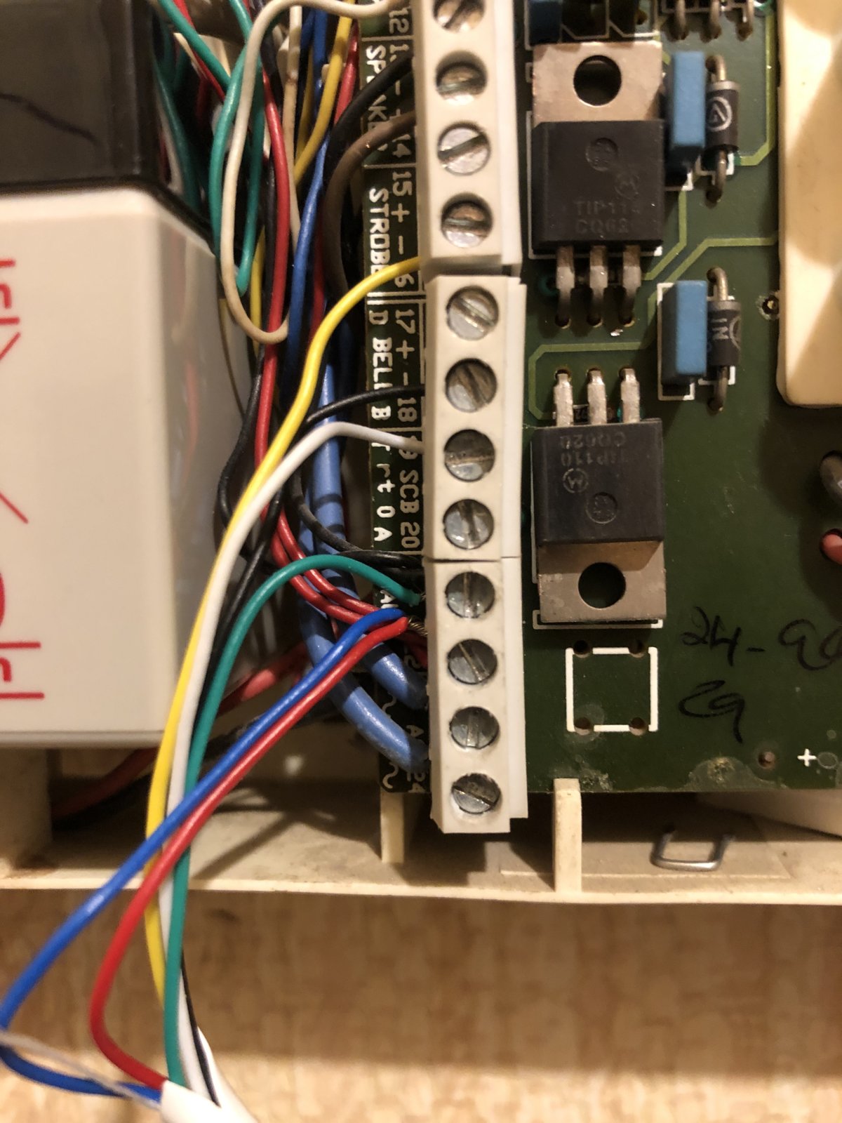

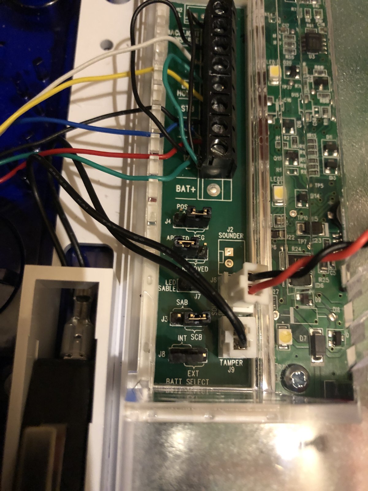

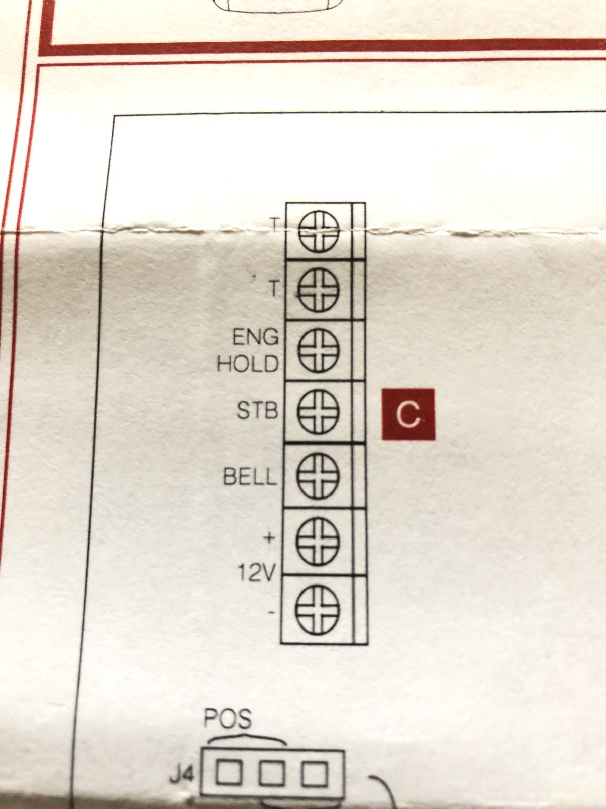

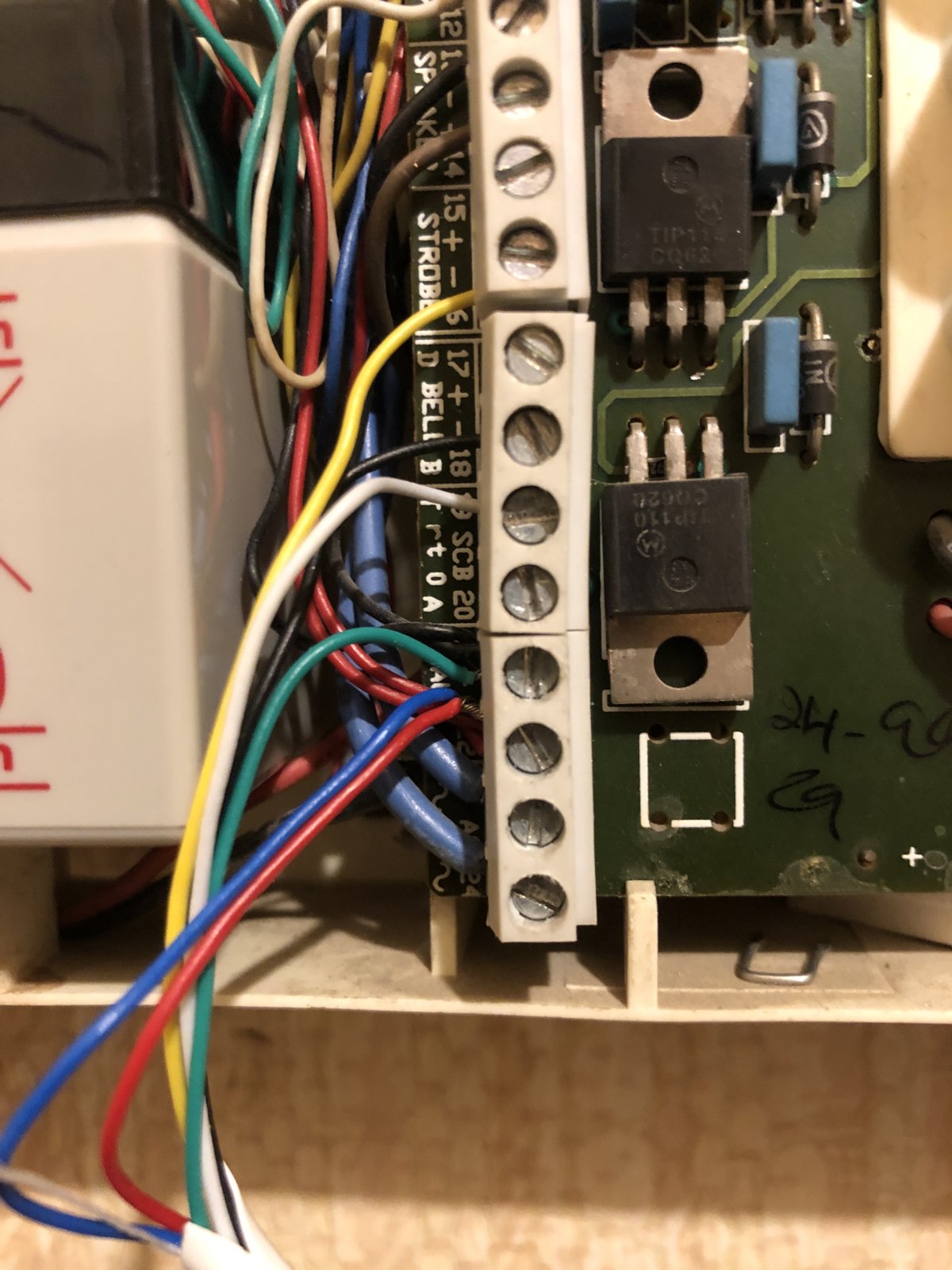

Hi I’m new to this site so please bare with me. I have an old response AJ900 control panel and a new delta bell plus bell box.
can someone help with wiring instructions. I will hopefully put pics on of both diagrams. The first two pics are response and last pic is pyronix.
cheers Ash.
From control panel to bell box
Connections on delta bell are
12v - green
12v+ blue & red
Bell black
STB yellow
T white
Put wire link from other T to 12v-

My only problem is the engineers hold off.
I wired it as pyronix said with the wire from hold off to negative or 0v as it’s written and when I set the alarm I can open the box and the siren doesn’t come on ???
Also should the Jump pins be on
scb or sab ?? apart from that I could put it up and it would work unless someone with a ladder knows I’ve wired it wrong. LOL
ASH.
Where I put the white wire it says scb on the control panel

The green link between the 12- and eng hold off is the problem ?
Remove the link and the lid tamper will work when the cover is opened or removed.
That worked a treat.
That’s it all sorted and I owe you a big thanks.
