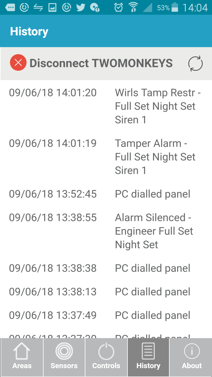

I am having EXACTLY the same issue with the microswitch I think. Could you please tell me which switch you purchased and where from? I have a wifi pyronix deltabell which is under a year old. As far as I can tell Pyronix are not interested in helping those that have done DIY installs. I wonder if this should be replaced under guarantee? Thanks for any assistance. I get messages such as those in the attachment.
