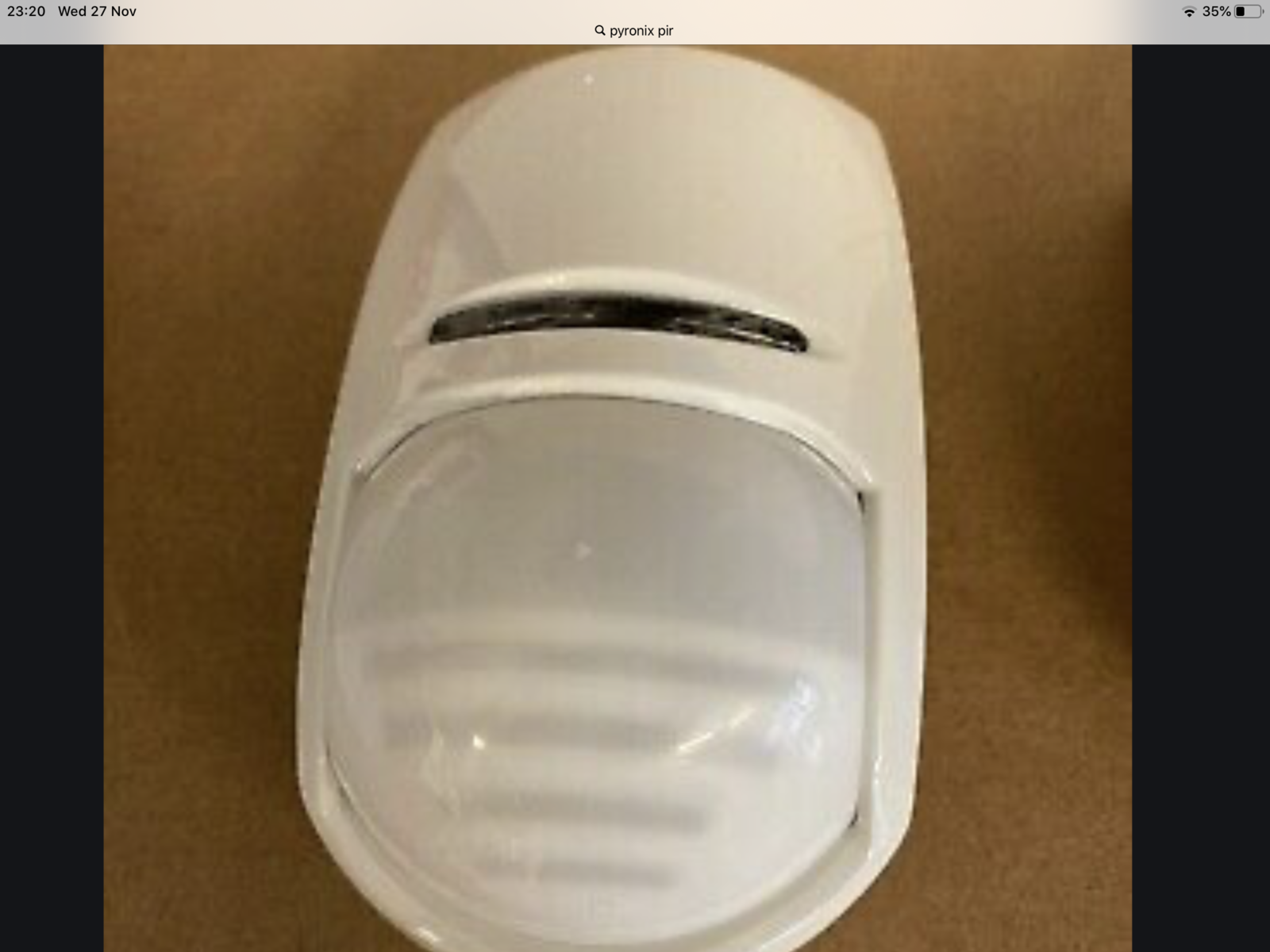

Did they leave the pet mask in ? Looks like 4 6E31EBBA-AE7A-4D5F-8ADB-47524283A757.png slots across the bottom of the detector lens ? As it’s the first thing i remove
.....not at the house just now, I will check tomorrow ....thinking about it , they do look a bit like that, "Secure I am" mentioned them. thanks for this Sparkymarka
Yes all four PIR sensors had these pet guards fitted!!! Now removed and retested system all PIR’s now work . Looks like the system was never set up correctly, many thanks Sparkymarka you were spot on with your diagnosis!
