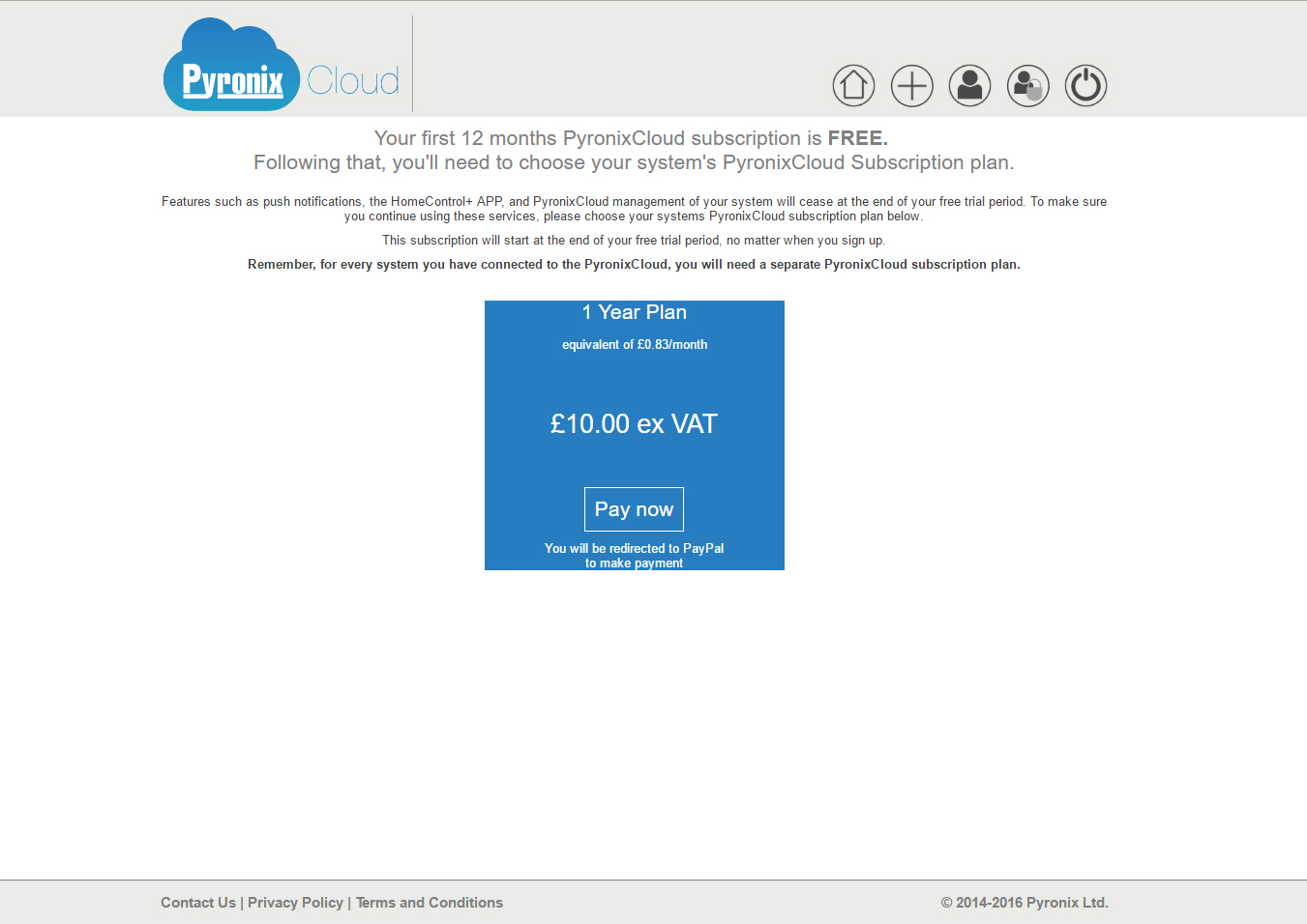

Mine stopped working for around 6 months and during that time I could only control the panel remotely via sms. Came good all of a sudden. Mind you - I live in a area where 3G GPRS reception is poor and the Ethernet module was not out at the time when I installed my system. HomeControl+ subscription is free for first year then £12 a year.
