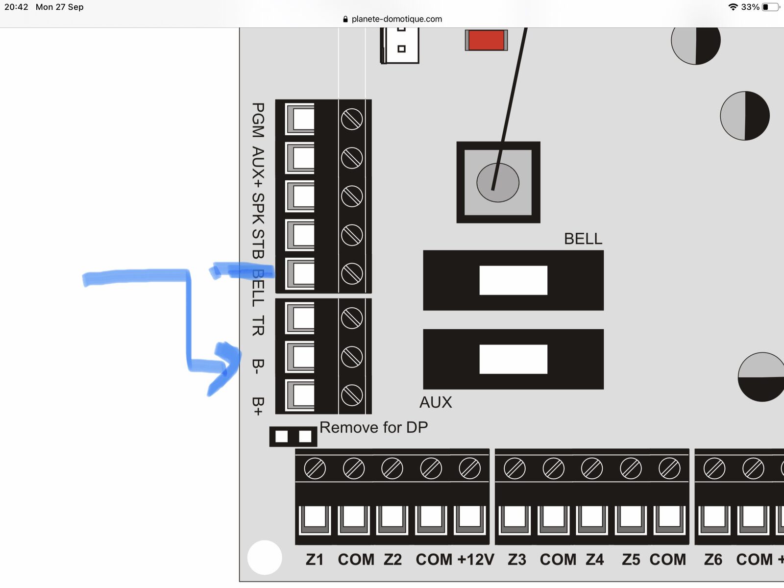

A quick check is remove the wire connected to BELL at the control panel and place it on B- does it ring ? 37DB92BC-0BCF-4ECB-9E49-9BC9EE95D88E.jpeg

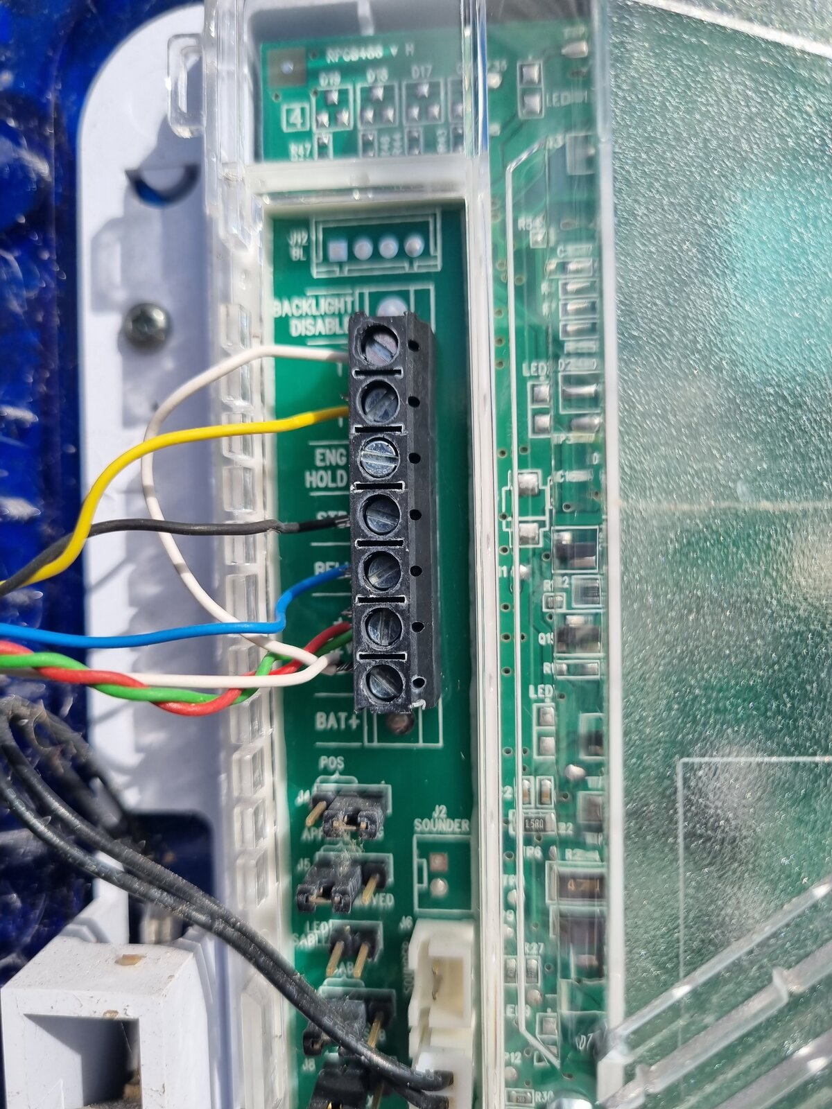

Thanks Sparymarka, I'll check that out tomorrow. I've left for this evening as its torrential rain now but here's a pic of the bell box connections. I didn't take one of the panel. With your second reply, what are you thinking? Wiring or panel maybe?

You do know that picture does not have the sounder plugged on ?
If it rings by touching the wire on ….it could be a faulty panel or output programmed incorrectly
Haha yes, I unplugged it at that point because I'd opened the bell box and it was sounding. Is there a way to reset to factory condition as we have tried the default engineering and manager codes if it is the output?
A quick check is remove the wire connected to BELL at the control panel and place it on B- does it ring ?View attachment 245243
Sorry for the very late reply. My friend works away and failed to leave a key so I've only gained access today. Disconnecting and shorting the terminal didn't ring the bell. The original owner was unaware of any issues but has now given the manual with correct access codes. Everything is programmed as it should be, as in Wiring method is DEOL 2K2/4K7 plus all inputs are programmed correctly too. The cables bell out so it's not a wiring fault. I did find a manual that mentions a 10K resister fitted in the panel between bell and b+ but as one was never fitted I'm not sure that's the answer. Any ideas?
Multimeter required to check bell output.
You need to determine that the output is at the correct voltage when bell trigger active.
