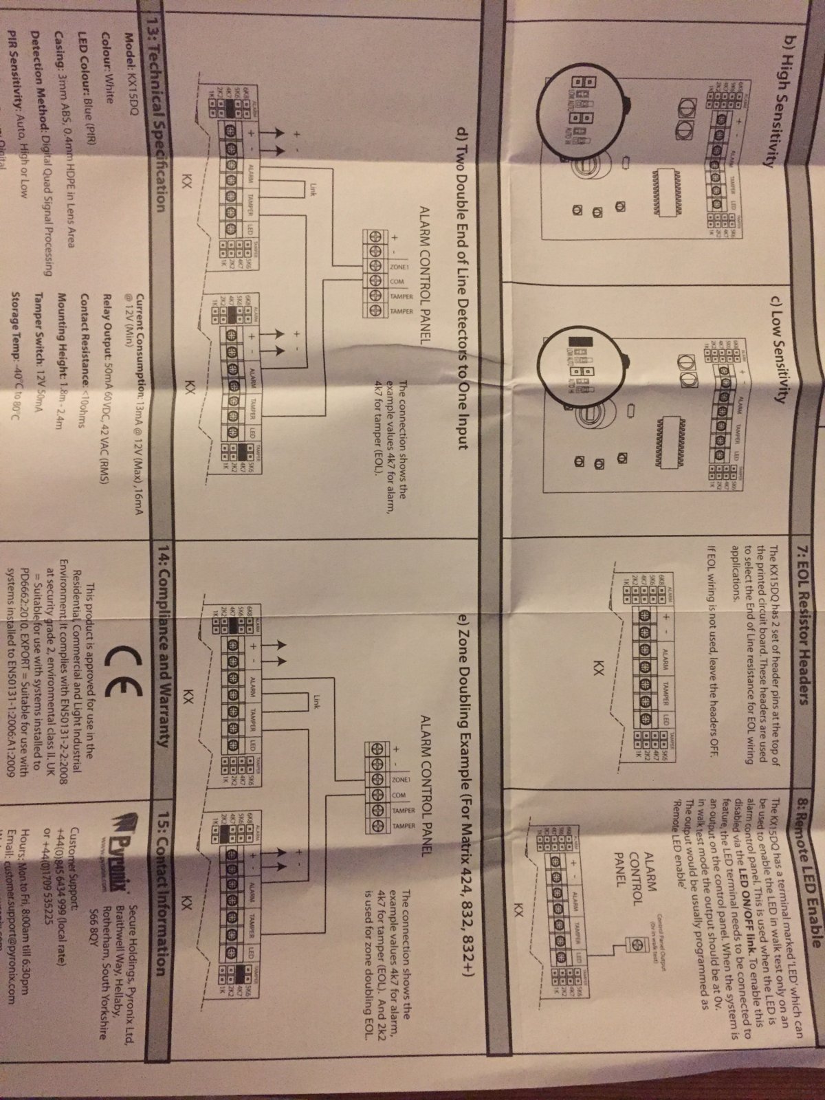

Hi, hopefully someone can advise me. I have recently upgraded my old alarm system, replacing it with a Euro 46 panel and changed the PIR’s to the KX15DQ. All are working fine except one zone where I had two PIR’s connected to the one zone. I followed the drawing but it doesn’t like it. I’m totally confused. Help please!!
Thank you!
Split them off ....not good practice to have 2 on one zone ....
How many cores to detectors ...and do you have a spare zone on the panel ?
WOW! Didn’t expect a reply so quick, thank you.
I have six core cable running to the PIR’s, it worked fine for years with the old alarm and two PIR’s on one zone!!
Running another cable to split them is no easy task. Any suggestions?
You only need 2 core per detector if you EOL The device ....eg first detector if looped into to the next...use red and black for power , blue and yellow at first pir EOL , join the green and white together at first detector and use this EOL at the second detector...

I changed everything other than the wiring, so new control unit (euro 46), bell box, PIR’s, door magnets, plus added three wired zones. Took a bit of time working out how to program the control panel. Also how to have two PIR’s on one zone.

Since sorted the two PIR’s to one zone, all working. :)
